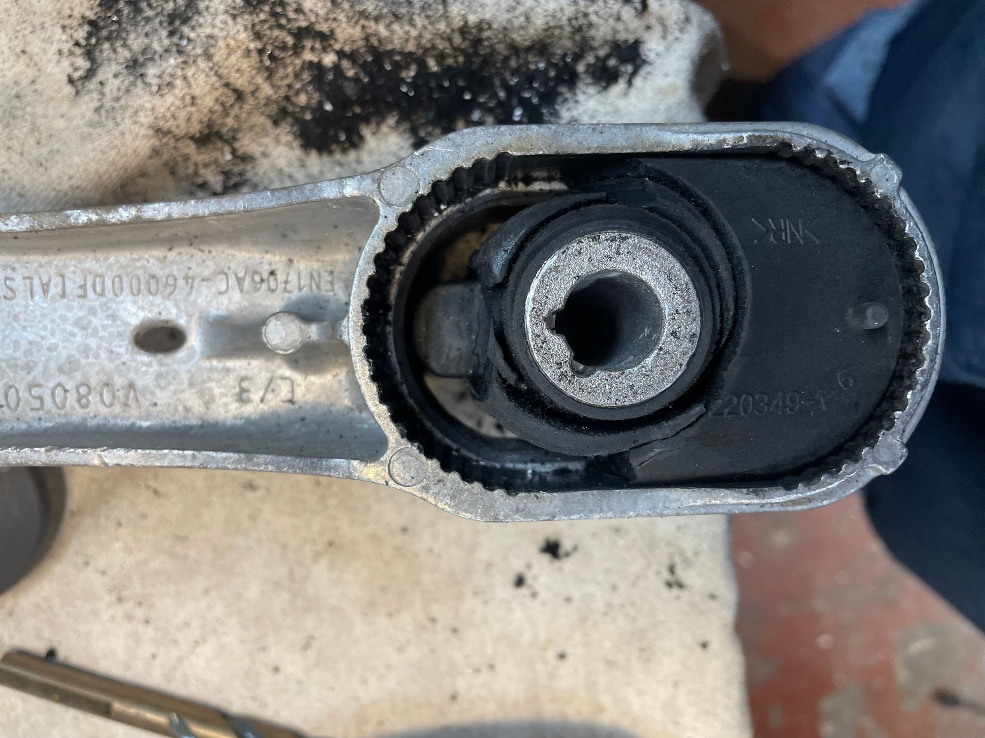

While doing this job I concluded the best option for removing the rubber bushing is shown above. Push it out with a puller. Or use a press. Or as someone above said they used a vice. Anything that will push it out whole. From there the job is simple. I had none of the above. And cutting, drilling, sawing all were pretty useless or extremely time consuming.
As was said at the start of this thread, this is either a 5 or 50 minute job. Me: about 2 hrs. I pushed and pulled and pried and got nowhere. I finally resorted to cutting around the steel spacer with a couple of hole saws and then cutting the rubber out at the short end. Even that was a chore.
Not pretty but effective
From there I was able to push/pry it out.
I wish I had found this tread before I started all of this.

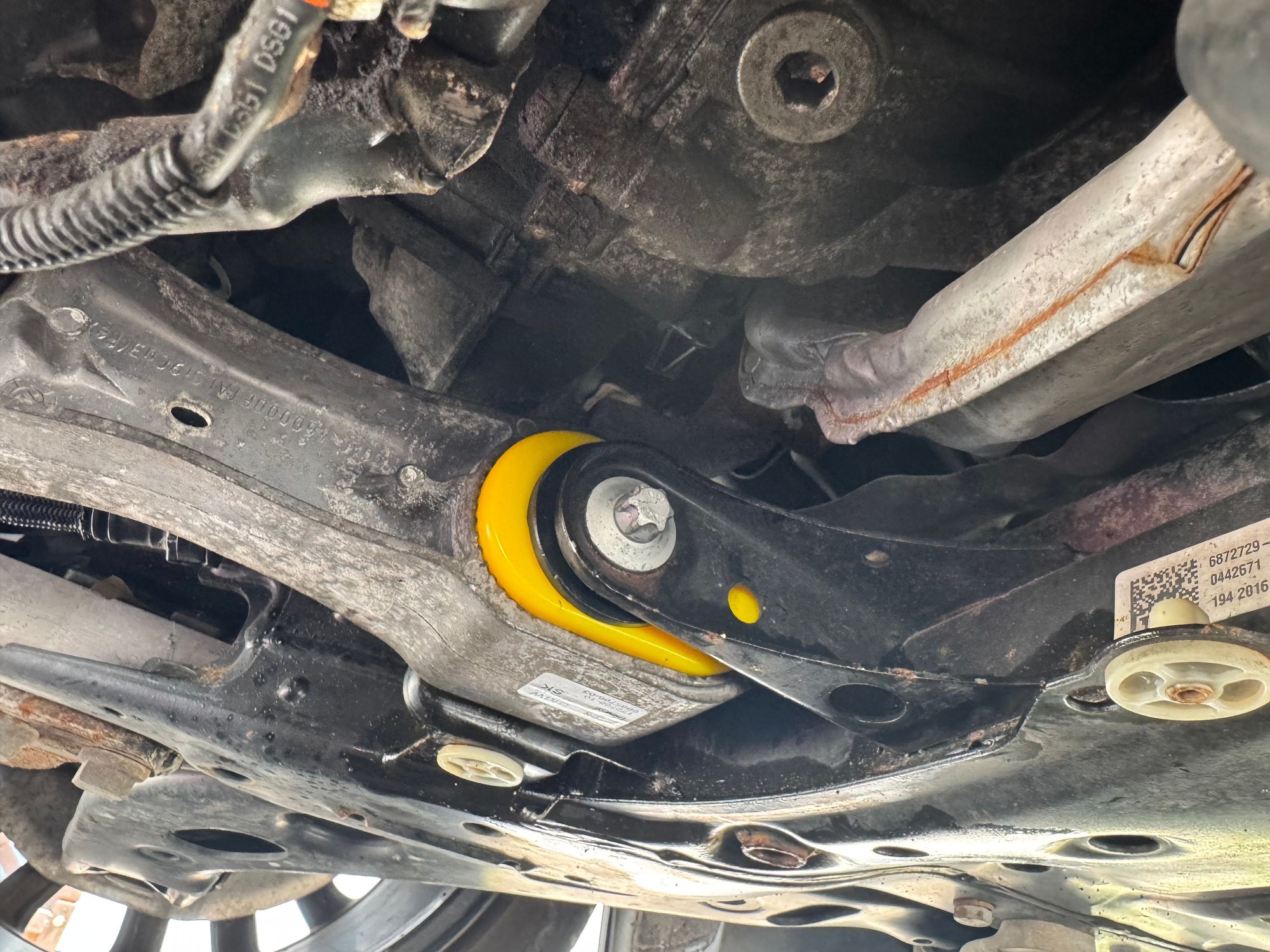

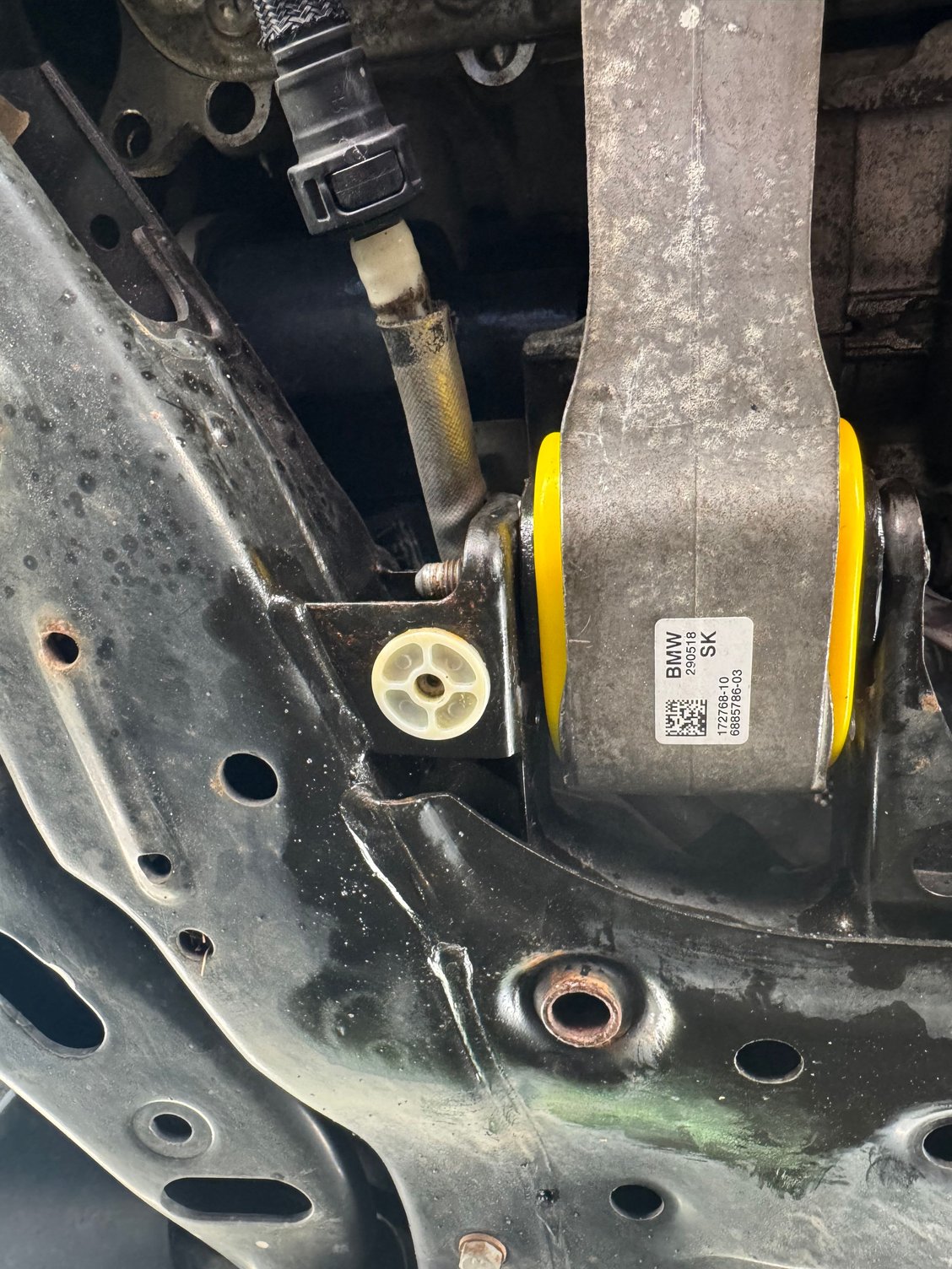

Thanks, I don't think I'll be able to get 75ft-lbs under the car. But it is good-n-tight. The vibrations at idle are NO JOKE. Might take out the black inserts. I'm gonna see if my wife notices first. It's primarily her car.
Does the fitment look correct? Seems to extend a bit past the metal arm
Old May 20, 2026 | 12:22 PM
  #38
njaremka's Avatar
njaremka
Alliance Member
Community Builder
Community Influencer
Joined: Jul 2016
Posts: 7,555
Likes: 2,511
From: WNY
If its in and the bolt is tight, you're good to go

Thanks, all set. Emailed Power Flex as well and they got back to me within an hour confirming the install looks good.
