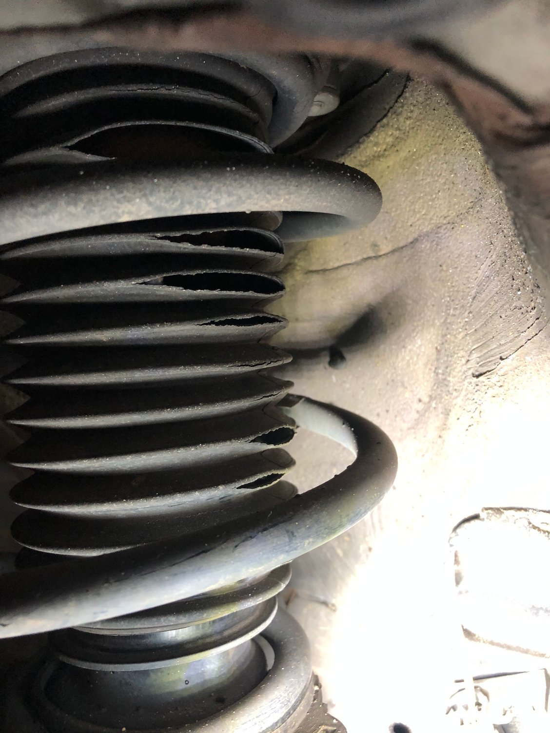

So was working on motor mount replacement and had my head in the RF fender well. Noticed this sad state of affairs:
RF upper spring pad, part number 31336852465 if I have it right.
Car is creeping up on 98K miles, 2017 F56S. I’m the second owner, purchased around 74K miles in mid-2021. Car has been in the southeast US its whole life.
Is this normal for an F56? Guessing yes since this part seems to run between $10 and $17 out there (the labor is another question), this is clearly (by price and feel) a cheap piece of plastic. But, um, wow.
LF side is not similarly injured, at least not on the front edge. Dunno about the rears.

Normal.
I ended up replacing these on my wifes F56 Cooper around 100k, along with springing for new Bilstein B4s all around because... 'while you're in there' disease wouldn't let me just replace the bellows.

That is just the dust boot. Pretty normal for those to start tearing with higher mileage. In theory, you can run without them. So, unless you feel the need to remove and disassemble the shocks, I would just keep an eye on them until you need to replace the shocks.
Yes, just the dust boot. If the shock isn’t leaking then it is still acceptable as-is. If you are good with the ride/harshness, then you can just leave it.
Just a thought for future consideration, if this was an R53 or R56 MINI, I would say the shocks were shot at 30k miles. The MINI shocks on those MINIs, in comparison to the Bilstein or KONI FSDs, were very harsh when new and just got worse over time, and had poor control over the suspension dynamics. This is the way it was on both of ours and what I have read over the years of ownership. On my F56, the base JCW shocks seemed to be better than what was on the previous Gen MINIs when new, but I changed them for the JCW Pro suspension so I can’t say how they might have lasted. On the previous Gen MINIs a switch to the Bilstein B4s, or in my case the B6/B8s (my R56), or the KONI FSDs (our R50) was always reported as being a huge improvement in ride and suspension control. For the Bilsteins the B4s are a better than OEM ride; the B6/B8s are more aggressive toward handling. The replacement effort is far less than what you just went through for the motor mount.
Appreciate all this info.
So for context, the reason I was so thrown by this is that my 1995 Subaru Legacy wagon with over 350K miles has original dust boots on original shocks/struts in the front end and they have shown no sign of this sort of deterioration. The difference that I also just figured out: they're plastic (and not cheap BMW-underhood cracks-if-you-touch-it plastic ). The ones on the MINI, though, are rubber. D'oh. No wonder it looks like dry rot.
Moving on from that, I had not thought about the Bilsteins. On my down-the-road radar are front and rear sway bar replacement as suspension upgrades, but I honestly hadn't gotten as far as thinking about the shocks/struts. Hmmmmmmmmmmmm...
