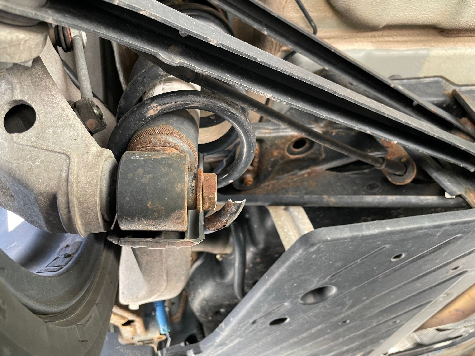

The "bumpy ride" continued on the way to work (06:45 a.m. / pre-dawn). Also, from the driver's seat, it seemed like the right side of the hood was slightly lower. Upon arrival, verified the right rear suspension had obviously collapsed, and the fender was close to the tire (see photos). I presumed it was a broken spring, or shock.
I scheduled a service appointment for next week, but hoped to get a response from others who may have experienced the same thing. Could a broken shock cause the sagging as shown in the photos? I don't recall hitting any major pot holes on the previous drive. It seems like what ever failed, did so while the car parked was in the garage after the previous drive, because the bumpy ride started as soon as I left the house on Friday March 20, and I didn't notice it before that time.

This looks similar.

You need to look underneath and see what is broken. You should not be driving it without knowing what is wrong. It could be very unsafe.

This looks just like the one posted recently, you have to have something broken like a shock, spring, or upper strut mount. You should NOT be driving it until it is fixed as it could be very dangerous as it could come apart and cause you to loose control, depending on what it is.

It was a broken spring. Also replacing the shock.

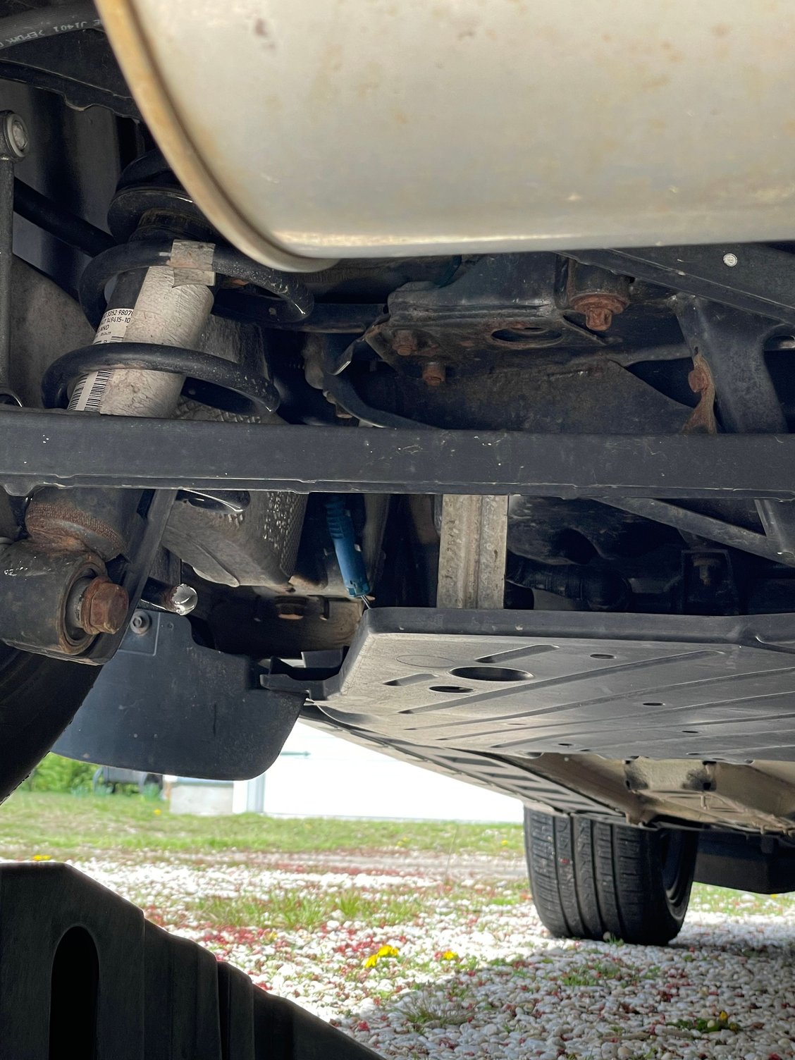

This seems to be a common issue with the Countryman. I have a 2015 that the rear driver's side spring failed on. I also heard of another 2015 that both failed. Does anyone know why this isn't a recall with Mini?
