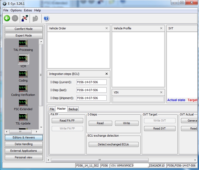

I checked what my version is by looking at I-step.
It shows F056-14-07-506. Mine was built 9/30/2014. On 12/30/2014 dealer told me there are no update for my car when he checked my keys.
On the main window of e-sys, after connected to my car, I see on the lower right corner, it says F056_14_11_502 | F056 | VIN: xxxxxxxxx | F056,F056-14-07-506. (see screen capture)
I think the left numbers are my psdzdata software version, and the most right numbers are what my car has. The _14_11_502 means November 14 and 502 is the revision number from that month.
I have both lite and full version of PSdZData v54.1. So my car has an older firmware than the software that is in v54.1.
There are 14_11_502, 14_11_501, 14_11_500 which are all newer than my current firmware. According to shawn, the last three digits are revision number for that month, and there could be more than one releases in a month. So if I wanted to update, I should update to F056_14_11_502
Attached Thumbnails Mini coding/programming-screen-shot-2015-01-08-at-9.57.18-pm.jpg
