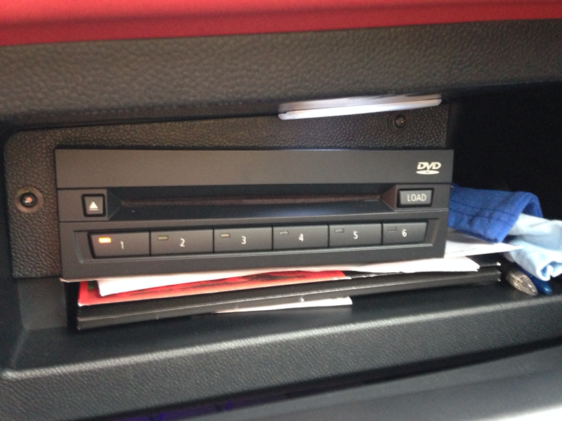

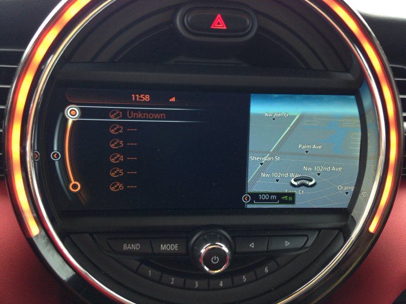

I was trying out the DVD in Motion today and can't get the DVD changer to read my DVD's! (Attached Pictures) Does anyone know what could be wrong? Is there another way to get my car to play a movie besides physical DVD's?

What coding did you use? There's 5 or 6 parts for DVDS in motion.

I did everything that was in the cheat sheet for the F56http://www.bmwesys.com/guides/BMW%20...ooper%20S.docx
In HU_NBT
SPEEDLOCK_X_KMH_MAX werte=FF
SPEEDLOCK_X_KMH_MIN werte=FF
VIDEO_HANDBRAKE= Nicht Aktiv
VIDEO_FRONT_LOCKED= Nicht Aktiv
VIDEO_SPEEDLOCK_CONDITION= None
I also did enable video files from USB, if that makes a difference, although I'm not able to play videos through the USB.
ENT_CODEC_XVID=Aktiv
ENT_CODEC_VCD=Aktiv
API_USB_VIDEO=Both

I did everything that was in the cheat sheet for the F56http://www.bmwesys.com/guides/BMW%20...ooper%20S.docx In HU_NBT SPEEDLOCK_X_KMH_MAX werte=FF SPEEDLOCK_X_KMH_MIN werte=FF VIDEO_HANDBRAKE= Nicht Aktiv VIDEO_FRONT_LOCKED= Nicht Aktiv VIDEO_SPEEDLOCK_CONDITION= None I also did enable video files from USB, if that makes a difference, although I'm not able to play videos through the USB. ENT_CODEC_XVID=Aktiv ENT_CODEC_VCD=Aktiv API_USB_VIDEO=Both
That should have worked

Add These:
HU_NBT>3000>SERVICE_MESSAGES_SPEEDLOCK_CONDITION>N ONE
HU_NBT>3000>OFFICE_MESSAGES_SPEEDLOCK_CONDITION>NO NE
see if that helps...
