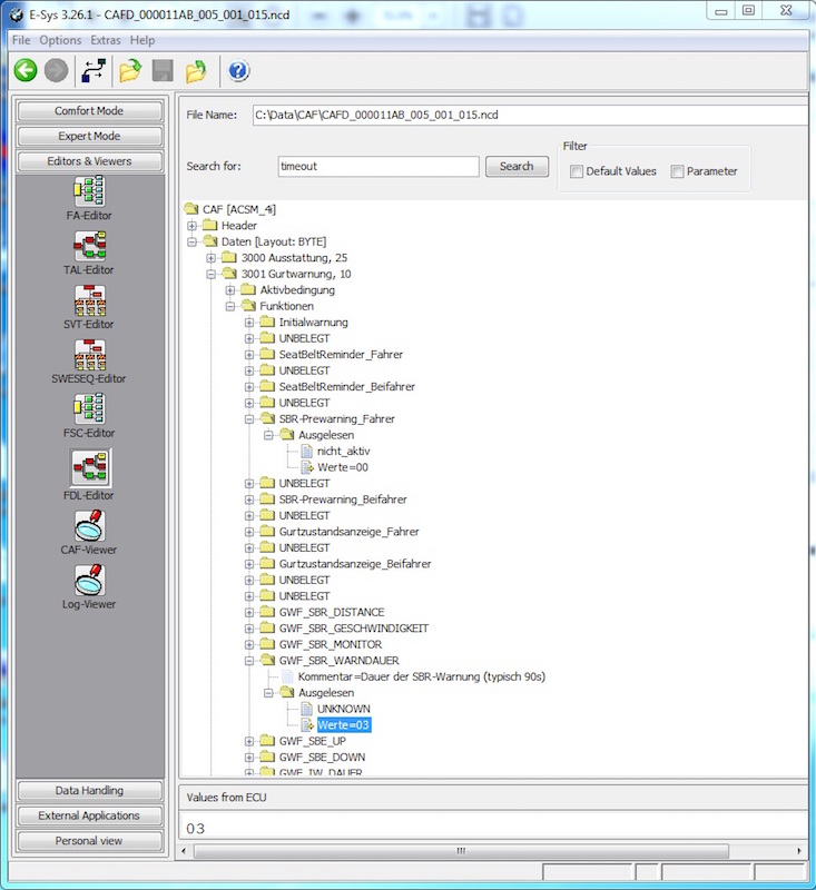

Am I doing something wrong here? Attached my screen capture.
* Disable seat belt disconnected reminder sounds
ACSM
3001 - SBR_PreWarning_Fahrer = Set Nicht Aktiv (front driver)
3001 - SBR_PreWarning_Beifahrer = Set Nicht Aktiv (front passenger)
Attached Thumbnails Mini coding/programming-1.jpg

Originally Posted by hp79
I just received the $5 ODB to Enet adapter in mail today. It works fine.
ACSM
Like he said, open the Funktionen folder and scroll down to find what you want.
You can also put the function in the "search for" bar and look for it that way.

Anyone tried these? These are locations from F56. I programmed mine but didn't test yet.
IHKA Module:
A/C System Remembers Last Setting
3003: MEMORY_OFF set to aktiv-werte=01 *default was nicht_aktiv-werte=00
Always Remember Air ReCirculating
3003: MEMORY_UMLUFT aktiv *default was aktiv so didn't change anything
ACSM Module:
Seatbelt reminder durantion
3001: GWF_SBR_WARNDAUER (werde = 01 for 1 sec) *default 5A (=90seconds)
Does "nicht_aktiv" and "werte=00" always go together? So if I want to change them, am I supposed to change both to "aktiv" and "werte=01"?
Attached Thumbnails Mini coding/programming-ac-memory.jpg   Mini coding/programming-seatbelt-warning-time.jpg
Anyone tried these? These are locations from F56. I programmed mine but didn't test yet. IHKA Module: A/C System Remembers Last Setting 3003: MEMORY_OFF set to aktiv-werte=01 *default was nicht_aktiv-werte=00 Always Remember Air ReCirculating 3003: MEMORY_UMLUFT aktiv *default was aktiv so didn't change anything ACSM Module: Seatbelt reminder durantion 3001: GWF_SBR_WARNDAUER (werde = 01 for 1 sec) *default 5A (=90seconds) Does "nicht_aktiv" and "werte=00" always go together? So if I want to change them, am I supposed to change both to "aktiv" and "werte=01"?
Rarely do you change the werte value

"Werte" means value. These change when you edit the setting via the drop-down (i.e. from nicht_aktiv to aktiv). Selecting aktiv will always change the value to 1. No need to modify the value as well.
The exceptions are things like enabling video playback in motion- you need to set the value to something outside of that would normally be done.

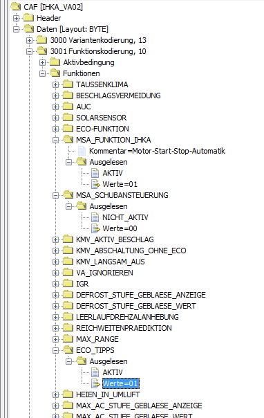

Anyone know what turning off ECO_TIPPS might do (in screen capture)?
This is in IHKA module 3001. I don't have the Visual Display upgrade so no fish. What kind of tips am I receiving from eco mode with basic radio?
Looking under IHKA module 3003 there's "AC_ON_WITH_AUTO" which is set to AKTIV. I'm going to disable it so AC doesn't kick in by itself when I select AUTO. I want to be in control of the AC to prevent AC smell.
Attached Thumbnails Mini coding/programming-eco_tipps.jpg
My "memory_off" is set at nicht_aktiv and my car remembers what A/C setting I had at shutdown.
I have no clue what the eco_tipps is, if I were to guess it has to do with green mode
