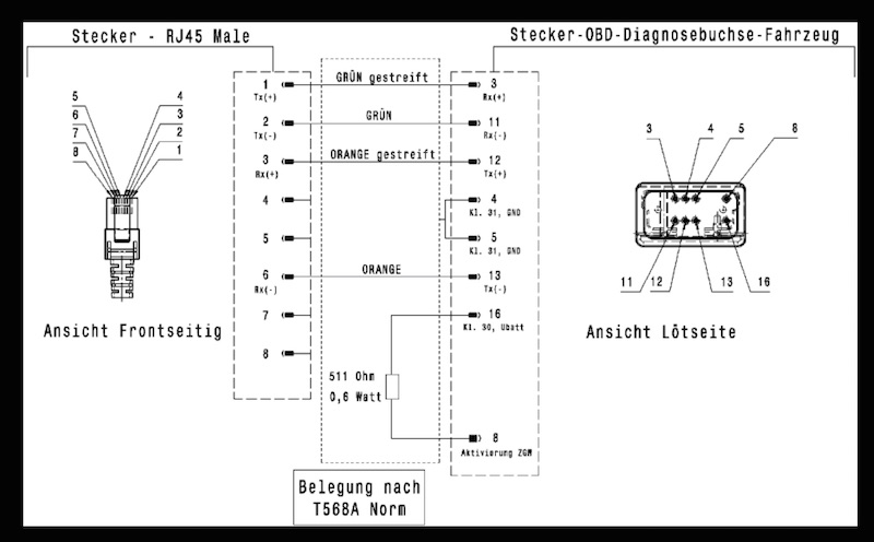

Originally Posted by r33
Not sure if that will work. I believe the wiring to the pin out different with a regular OBDII.
I think it'll work fine. It's a basic wiring harness with one 500 Ohm resistor in it. I thought of building it myself, but then I can't beat the $5 price. Oh, and the one I ordered is not a regular ODB2 reader, it's actually a ODB to ENET for use with e-sys.
I don't think there's a normal ODB2 reader with an Ethernet for reading ODB2 codes. I've seen bluetooth, wifi, serial ports, USB, but not Ethernet ones.
This is what I bought. It's actually $5 not $4. lol.
edit: Works fine!
Attached Thumbnails Mini coding/programming-screen-shot-2014-12-02-at-11.03.55-am.jpg

Old Dec 2, 2014 | 11:34 AM
  #59
r33's Avatar
r33
Joined: Apr 2014
Posts: 42
Originally Posted by MarcoPolo
this is what i get for spending too much time in the bimmer forums. let's me re-ask then. do you see any VO change/addition i can do given i have 6ND only. my ultimate goal is to enable A2DP and it really seems doable, just figuring out the right option to add.
I believe 6NE is what you need to enable the A2DP. Give it a try, it just won't work at the worst case scenario and just revert it back to 6ND.
I wish I have the same option where I can try it for you.
That seems to be right.
