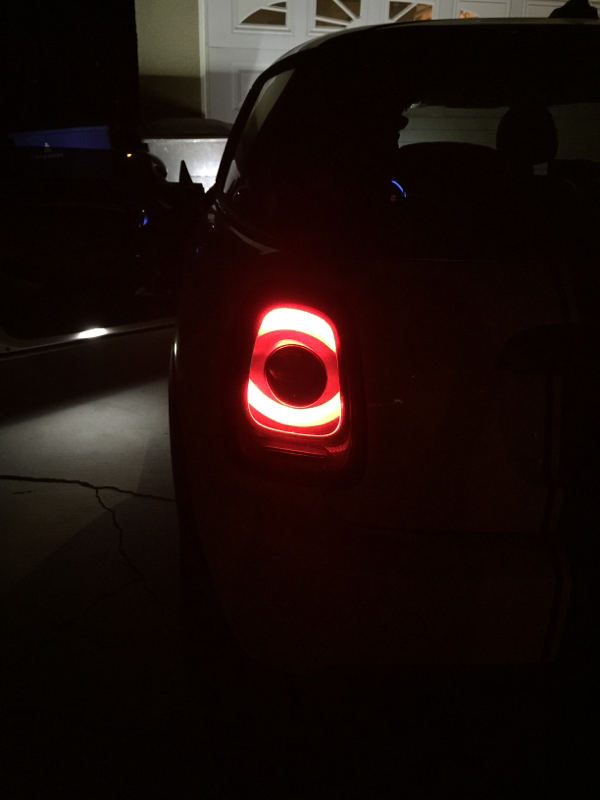

I don't have many bells or whistles on my F56, but coding allowed my windows to roll up with the key fob, fog lights on with high beams, and my tail lights have glowing rings even when headlights are off (just running lights on in front)
Attached Thumbnails Mini coding/programming-image-3948728361.jpg
