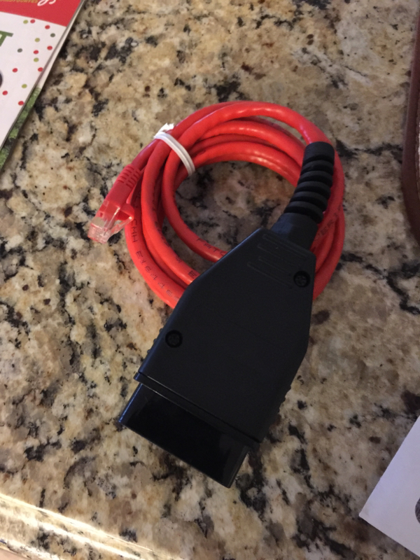

Old Dec 8, 2014 | 03:51 PM
  #88
MiniLynsk's Avatar
MiniLynsk
Joined: Mar 2012
Posts: 179
Time to start coding!
Attached Thumbnails Mini coding/programming-image-3537851109.jpg
