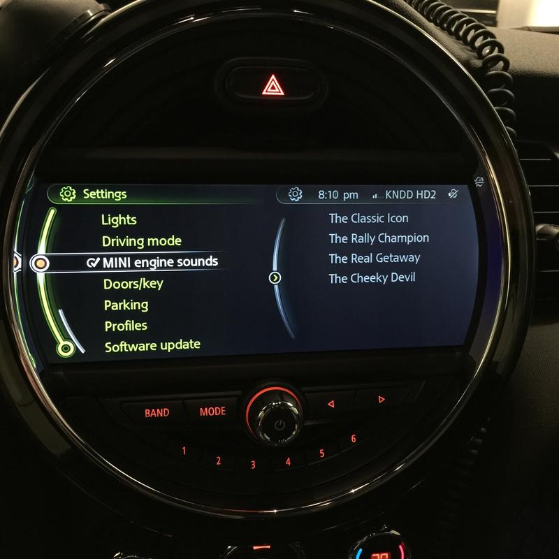

Finally got everything working with ESYS and got to coding last night!
Here's the list of stuff I've done, thanks to info around the forums, and some extra stuff I discovered by sniffing around...
For the record, my F55 is a Feb build with F056-11-14-502, used psdzdata 54.1 and had to track down missing CAFD files for the HB_NBT and BDC_BODY modules
-Turn off seatbelt reminder chimes (I kept the lights on, but there's a way to code those out as well.
- Disable welcome gongs/chimes
- Messed with Active Sound Design: Able to turn off (too quiet), tried to configure to use BMW M-series sounds instead, but couldn't get it working. Guessing it's because the ASD modules are different between MINIs and BMWs
- Close windows, sunroof, and mirrors from the keyfob
- Also set up to fold windows in/out while locking/unlocking
- Change triple turn signal to another number (I kept it on 3, but verified it worked)
- Allow windows to roll up while door is opened
- Tail lights on with DRL
- Fog lights can remain on with high beams
- Door handle welcome lights come on while reversing
- Turn off electronics when drivers door is opened after engine shut off
- Unlock all doors when engine is shut off (only works if Auto lock after driving is enabled)
- **Enabled Active Sound Design configuration menu: works, you get a menu of sounds to choose from in the Settings menu, but none are selectable and turning this on disabled my ASD sounds altogether.
- Use iPhone's ringtone when call comes in
- Change Navigation voice to British English - incidentally, this also changes all the language to the UK versions, and inputting addresses into the nav, some of the fields are blank (ie: City, State, Street)
- Removed iDrive disclaimer
- Display tire temperature in addition to the tire pressure (which now says tyre pressure, thanks to the UK change lol)
- Play video while in motion
Here's the new stuff I dug up:
- Change gong/chime and system sounds to BMW, BMW i, or Rolls Royce (all three work and affect all the sounds in the car - mine is currently set to BMW for now...will probably change it back to MINI)
- Change the NBT theme to BMW, BMW i, or Rolls Royce: Basically changes the graphics to the interface used on those three platforms. (BMW i was only one I got working, BMW and RR froze on the MINI splash startup. On BMW i, some MINI specific graphics and menu were missing, also some verbiage is different ex: EfficientDynamics instead of GREEN mode.)
- There's coding to change the startup splash screen in the headunit to BMW, BMW i, Rolls Royce, blank, but I didn't test.
- Turn off speed correction: looks like it took, but haven't verified
- Found option to put the turn signals indicators in the HUD, but doesn't look like it works on MINIs
That's all I got so far! Makes my MINI 10x more enjoyable!

Wow. I didn't know you could change all that stuff. Did the engine sounds work?
No - turning the configuration menu on didn't do much. None of the sounds are selectable and having the menu on killed Active Sound altogether. Wondering if it was an abandoned feature, one for demo purposes, or maybe a fJCW related feature.
There are some parameters in the ASD module that let you pick other engines to simulate, but none of them I've tried so far seem to work. I tried a few BMW engines and the B48B20, which I thought was the fJCW engine, but that didn't work either.
