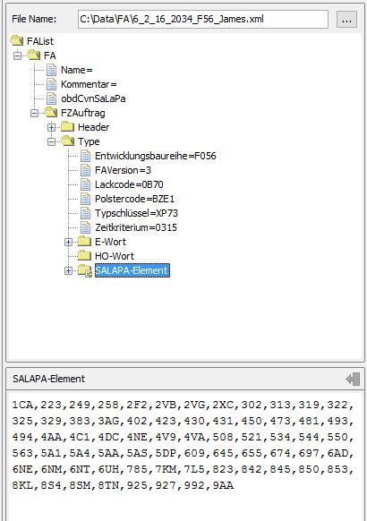

Has anyone tried to code for Variable Light Distribution(VLD) on an F56? I've seen on a couple threads people talking about it, but never read anything about anyone trying it before.
On my F30 335i I removed 5AP (decoder for no-dazzle high beams) and 8S4 (decoder for VLD) from the FA to get the functions of these. I've noticed on my F56 Cooper S that it still has the decoder for VLD (8S4).
Has anyone tried removing this and then VO code the FEM_BODY and KAFAS2?
I know there is relatively little harm in doing this since you aren't writing the FA back to the car, but I'd not like to be the guinea pig on this either... haha
