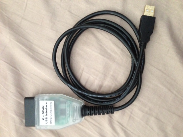

My brother gave me this cable which he used when he had an X5.
Will this work with the F56?

[QUOTE=toyopet;4228675]My brother gave me this cable which he used when he had an X5.
Will this work with the F56?[/QUOTE
Hard to tell from looking at it. Needs to be an ENET cable. Mine does not have a usb...
It looks like it should fit your OBD port. I think then, it will depend on the software on your laptop or whatever you connect the cable to for what you can do from there. Going by the note on another forum, it looks like if you get software that will work on F-series BMW it should work on your car. http://www.minif56.com/forum/409-ele...it-coding.html
Good Luck!
This cable is made for the older 2nd gen MINIs and E-series BMWs and will not work with the F-series cars - you will need an ENET cable. Looks the same but uses ethernet as the interface to your computer instead of USB.

Posts: 303
Thank you. Just ordered one.
