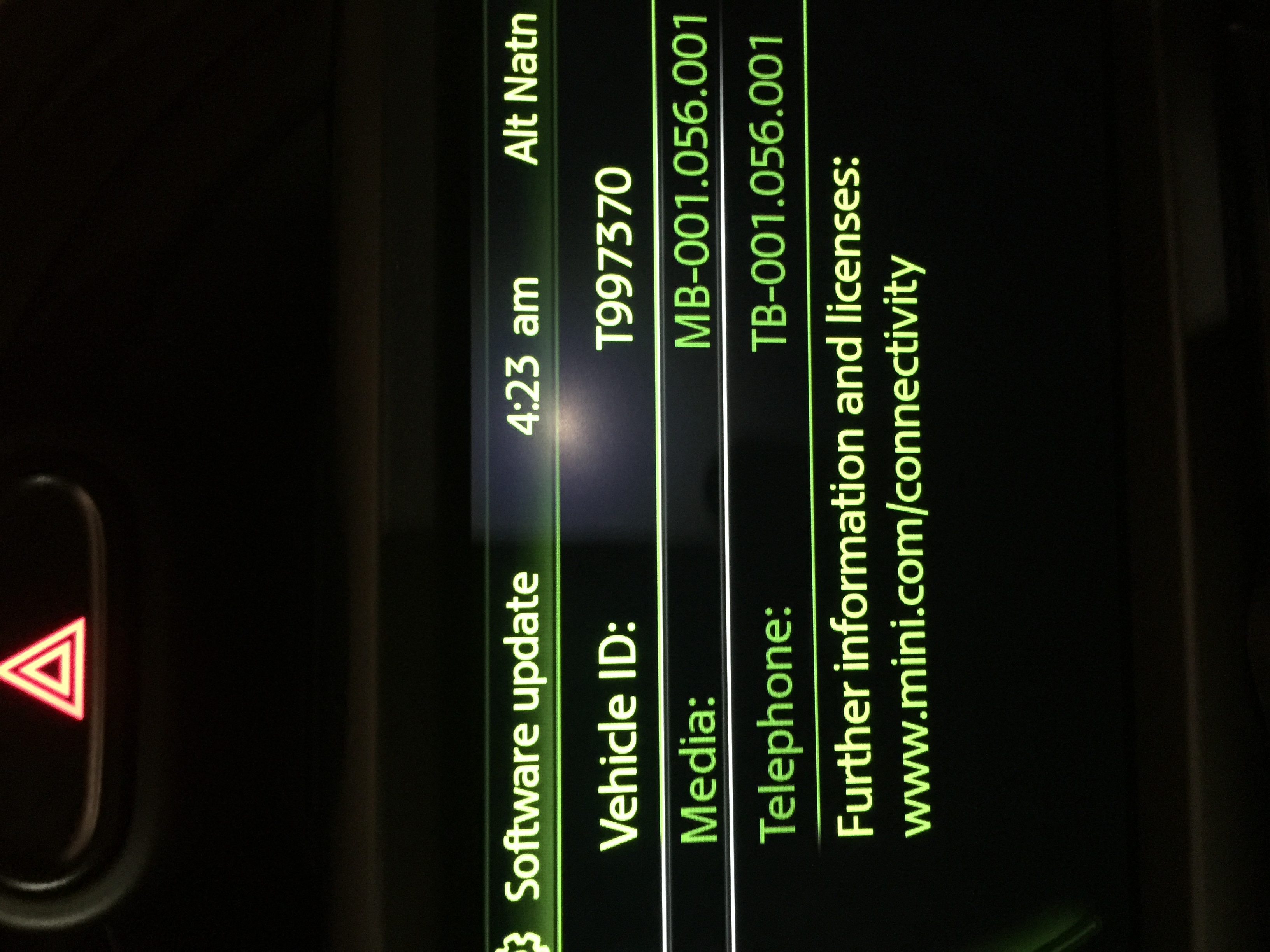

I brought my 2016 JCW in for its yearly service - oil change, cabin filter, brake fluid, etc. They also took the car's integration firmware software version up to the latest: F056-17-03-507.
After I got home, I wanted to see if I have any potential software upgrades available for Bluetooth and Phone via the mini.com/connectivity website. You used to be able to put the last 7 of the VIN in there and find out if the Phone and Media software were up to date. When I put my VIN in now, it tells me that I have an invalid number. When I try to email them, the system won't work. My wife's 2016 X3 has an update, which I downloaded off the BMW connectivity website. I put it on a flash drive, and updated her system, which fixed an issue I had with viewing the songs I am playing.
Anyone have any idea how you find out what the latest software is available for connectivity part of the car?
Currently my software is: Media - MB001.056.001 Telephone - TB-001-056.001
I just put in the last 7 of my VIN and it worked. Let me download the latest software which I already had.
Do you know what version you are running?
Also, which model do you have? I pulled some VINs off of the local dealers preowned inventory list, and the Cooper S, Cooper, etc. VINs work, but the JCW VINs give me the same error message saying they are incorrect VIN nos.

I have a cooper s
not sure on the version, i would have to go look. i updated it when i got the back last october. there have been no updates since. i don't think mini updates their software very often.
Sorry - should have asked the year, too. I've tried the last 7 of the VIN from a number of 2014-2017 2dr, 4dr, etc. I either get a Your Software is Up to Date or a message stating the VIN is incorrect.
Don't want to put you out, but if you could PM the last 7 of the VIN so I can download the file, then I can check to see what version(s) that file installs on the car. I installed the latest on my wife's BMW X3 this morning, and it corrected an issue I had with viewing the music library on the dash in the spedo when scrolling through songs. If not - no big deal. Just thought I'd be able to search the version out with the file. My wife's update file was about 80 mb, and installed in under 5 minutes. My wife's update file is: UPD05074.bin
