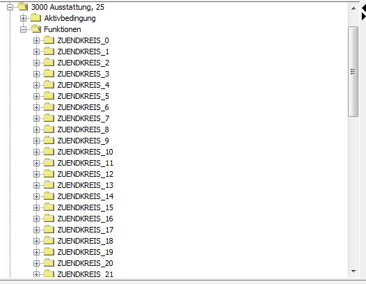

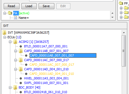

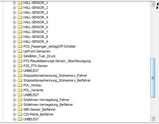

I had my 15 Cooper S updated by the dealer and wiped out all my codes. I tried to code the car again today and some modules are missing! HU-NBT is gone, I have ASCM2 instead of just ASCM and there are other major changes. Does anyone know how to disable the seatbelt gong? There is no more 3000_ASCM_Beifahrer anymore. I updated the pzsdata and ESYS because I was getting an error when trying to edit the FDL for the BDC_Body module. I can still code but not a lot of the codes on the cheat sheet. HELP!

I struggled with the same problem after a dealer update. Many of the parameters changed or moved. I believe the seatbelt codes are still in ACSM, 3000 but are now:
SeatBeltReminder_Fahrer
SeatBeltReminder_Beifahrer
Hope this helps.

I just checked since it was getting annoying, but mine's not there either.
I have 62.5.002 psdzdata. I see there are three sections
Attached Thumbnails Mini coding/programming-screen-shot-2017-12-04-at-7.23.52-pm.png   Mini coding/programming-screen-shot-2017-12-04-at-7.24.38-pm.png   Mini coding/programming-screen-shot-2017-12-04-at-7.24.54-pm.png

Ive been in contact with Shawnsheridan on bimmerfest who seems fairly involved with the coding process. He suggested that my Esys Launcher Premium was out of date and wouldn't interact with the new Psdzata correctly. I updated my launcher premium (which now requires a free activation code from Fxxtokenmaster@gmail.com to use on virtual machines, as well as russia, italy, and china regions, works okay on non-virtual native systems in US,UK) to 2.7.1 and updated esys to 3.28.1 using the psdzdata v3.63.1. The car is running version F056_17_11_523.
Still not seeing the ACSM module with the airbag codes, only ACSM2.
Can anyone who has had their car udpated by the dealer and still been able to code post their software versions, and car firmware versions Please?
