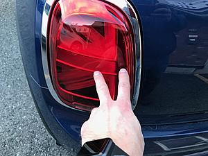

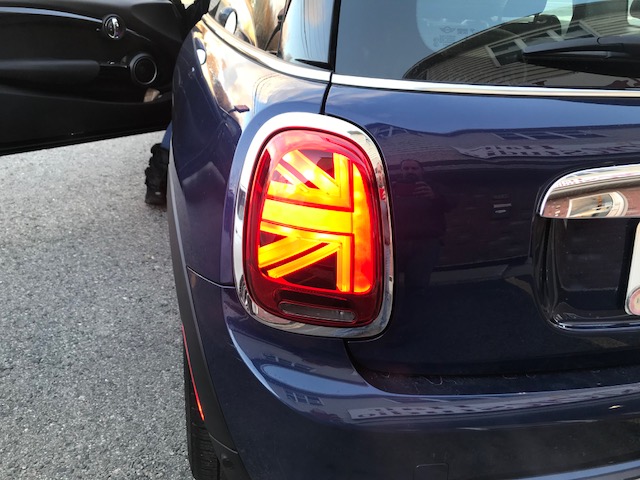

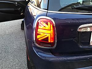

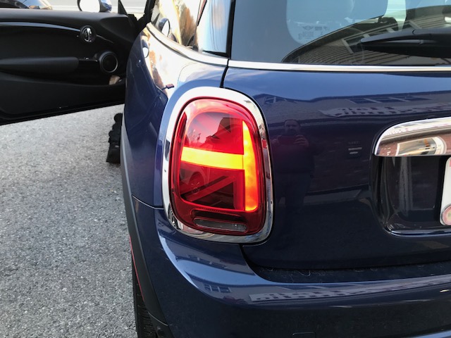

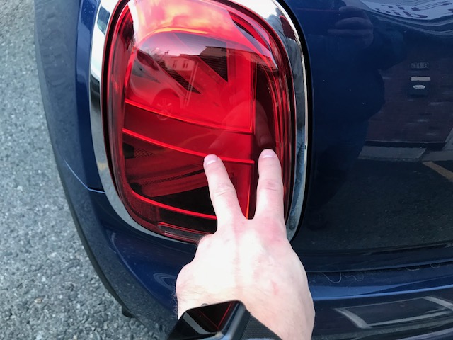

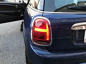

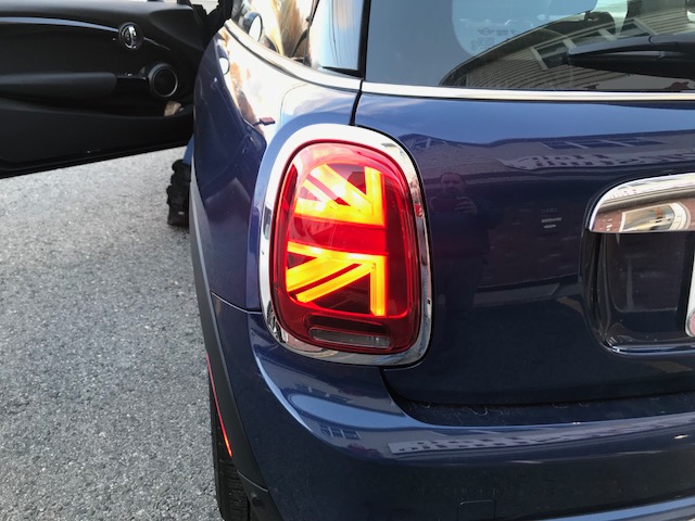

coding for new tailights
Hi guys, im new around here. I recently purchased a set of union jack taillights for my 2014 f56. Seems they are coded different here in the states and my turn signals and brake lights use the same leds on the new lights.
There has to be a way to code them to work properly. I have carly and hasnt done a thing besides remove the "lamp out warnings". As you see in the first and second pictures. in the UK the horizontal bar is for the turn signals and the verticle bar is the brake lights. Third picture shows the issue here in the united states. When i use the turn signal itll flash till i step on the brake then itll go solid. Not the safest way to ride. Thanks Gary
Attached Thumbnails Mini coding/programming-img_4639.jpg   Mini coding/programming-img_4640.jpg   Mini coding/programming-img_4642.jpg   Mini coding/programming-img_4644.jpg
Did your car have the LED ring on the original tail lights?
If not, no amount of coding will work. Its a wiring thing.

yes they are factory led lights.
My mini is fully loaded with led headlamps as well

I installed my Union Jack tail lights this morning. The lights worked perfectly right out of the box. I got indicator and brake malfunction errors. Used Bimmercode to code the indicators to LED and not monitor which corrected that error. My brake lights were already set to not monitor and as LED, so not sure where to go. I switched adaptive brake lights to not monitor and to LED, but that didn't correct the issue. I didn't experience the issue with the turn and brake lights like the person above. Mine is a 2016 JCW built in July 2015.

Got everything installed, and coded out the errors with Bimmercode.
Coded the indicators in the basic mode - to not monitor and set to LED.
Then, Stephan from Bimmercode gave me the following to do in expert mode:
BL_R_IS_LED => aktiv
BL_R_WARMUEBERWACHUNG => nicht_aktiv
BL_R_KALTUEBERWACHUNG => nicht_aktiv
BL_L_IS_LED => aktiv
BL_L_WARMUEBERWACHUNG => nicht_aktiv
BL_L_KALTUEBERWACHUN => nicht_aktiv
