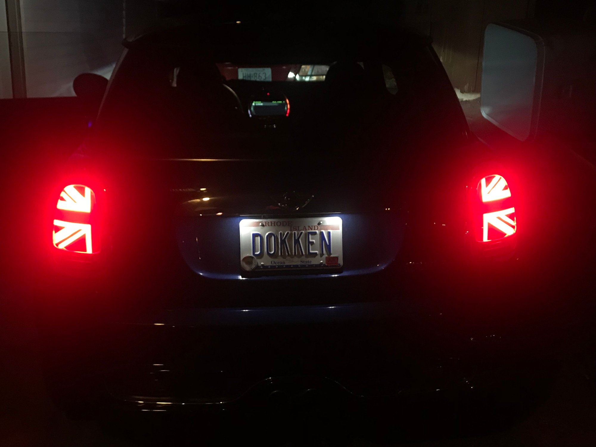

Union Jack lights are now coded and working properly
I got ahold of Okee from codemycar.com. He tapped into mine over the internet and worked till he got it right. It now operates as it should here in the United States. If anyone needs help he can get it done for a great price. Contact Okee and let him know I sent ya.
That's great! So presumably he knows how to separate the brake/turn functions for the US, like they are in Europe/UK from the factory?
Old Apr 29, 2018 | 06:43 AM
  #917
grh372's Avatar
grh372
Joined: Apr 2013
Posts: 24
From: RHODE ISLAND
Yes as you can see they now work great.
