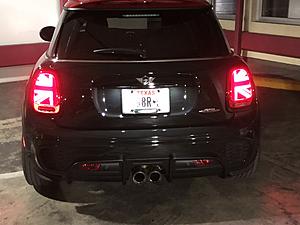

UJ tail lights installed
Here they are - coded out errors with Bimmercode
Attached Thumbnails Mini coding/programming-rear-tail-lamps.jpg   Mini coding/programming-tail-lamp.jpg

Originally Posted by kfmuller
Got everything installed, and coded out the errors with Bimmercode.
Coded the indicators in the basic mode - to not monitor and set to LED.
Then, Stephan from Bimmercode gave me the following to do in expert mode:
BL_R_IS_LED => aktiv
BL_R_WARMUEBERWACHUNG => nicht_aktiv
BL_R_KALTUEBERWACHUNG => nicht_aktiv
BL_L_IS_LED => aktiv
BL_L_WARMUEBERWACHUNG => nicht_aktiv
BL_L_KALTUEBERWACHUN => nicht_aktiv
Added to FAQ.

From: Bronx, NY
^That's all great that the errors are gone but does it function as intended like Gery mentioned in his post? Can you have someone in the car while you are checking from behind? Have the car running, have that other person turn on the blinker and then after that step on the brake - while the brake lights come on does the blinker still blinks or is it solid red? The horizontal bar is supposed to keep blinking (and not go solid red so people could still see that you intend to turn) and the vertical side bar is supposed to glow bright red (if I understood correctly). Or both horizontal and vertical bars should light up brighter but the horizontal bar should keep blinking to indicate an intended turn?
Scared me - just went out and checked. Everything works fine. Stepped on brakes - they light up red. Turn on turn signal, it blinks yellow. Step on brake it remains blinking and yellow. Start driving, put turn signal on, slam on brakes - all lights behaving normally - yellow signal blinks, and red brake light comes on. Not experiencing that other situation at all.
Just checked it and it is set to flachenvergr.....what does that other setting do (bremsclicht blinkend)?
Now I want to try that other setting...should I?
Update: just tried it and nothing changed.
Please help!
Looked again at your video.
I see you have the running lights on, with the blinker.
When you step on the brake, the turn signal goes solid, but I don't see your brake lights working.
Is that correct?
If so the brake light CANBUS is coded to the turn signal.
