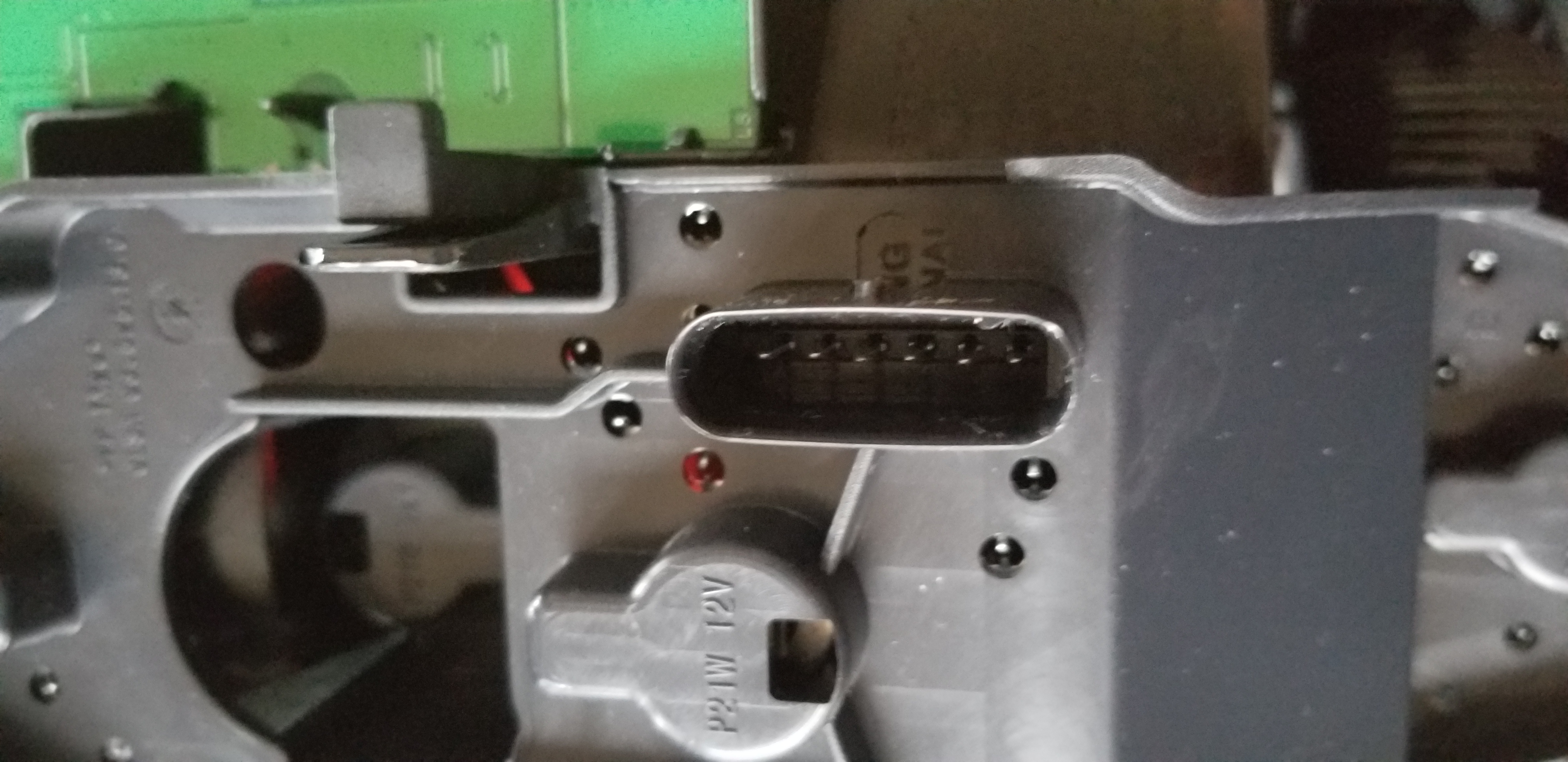

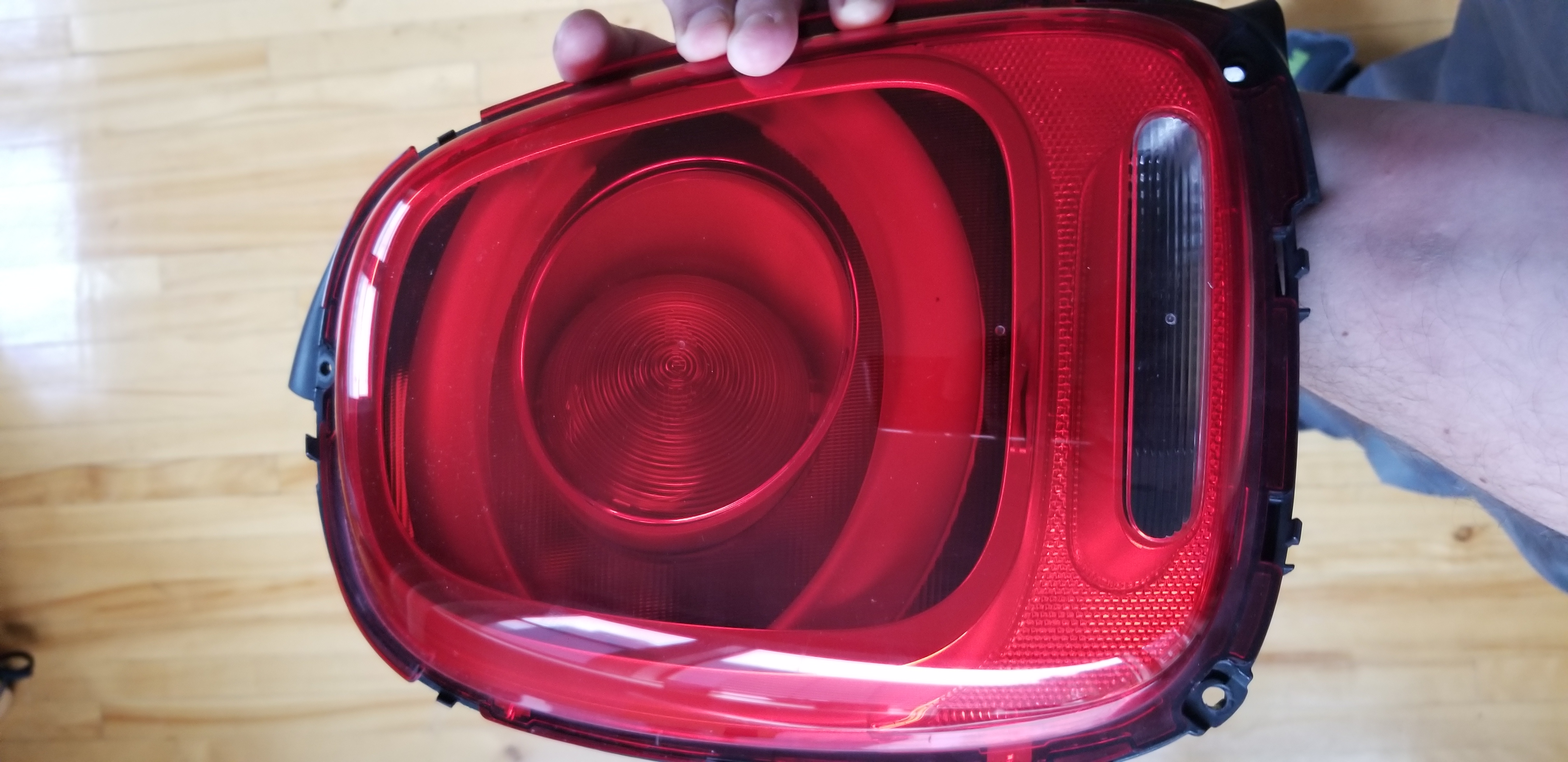

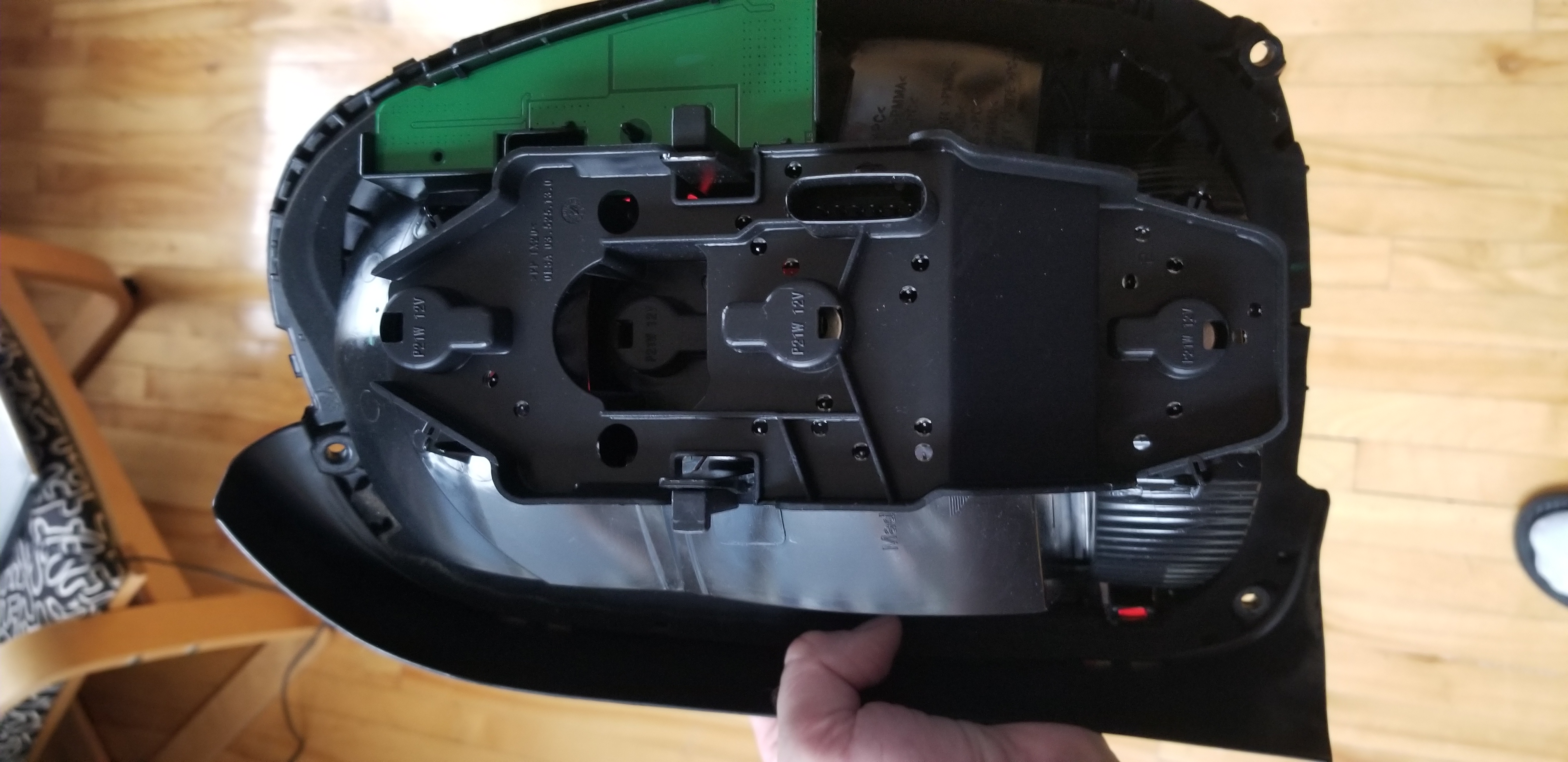

Sorry if this is out of topic... But does anyone know if the wiring/connector on the LED tail lights is different from the non-LED ones? Both tail lights use bulbs for the stop and reverse lights so I was thinking that they might be the same?
It would be great if someone can post a picture of the LED tail light wiring/connector.

I didn't take any photos of the wiring at the time of swapping my tail lights but here's the back of my 2016 tail lights with LED option that I took off my car the other day, hope that helps a bit.
Attached Thumbnails Mini coding/programming-20180403_175554.jpg   Mini coding/programming-20180403_175612.jpg   Mini coding/programming-20180403_175600.jpg

thanks for the photos.. I will just open a separate thread for further inquiry.
