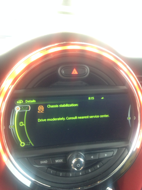

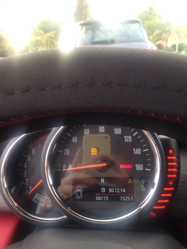

  #221
MINIMAN1411's Avatar
MINIMAN1411
Joined: Oct 2012
Posts: 150
From: Pembroke Pines, Florida
Edit: fixed this
Attached Thumbnails Mini coding/programming-image-577731812.jpg   Mini coding/programming-image-290337706.jpg
Old Dec 30, 2014 | 06:25 AM
  #222
CooperB's Avatar
CooperB
Joined: Aug 2007
Posts: 299
From: Georgia
What options did you code? We can likely find a solution for you but need to know what was changed first.
