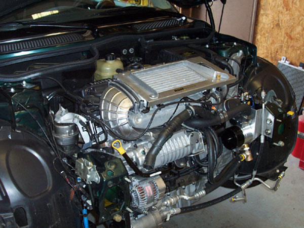

Just wanted to give you a little more of a sneak peek at the kit and how it is progressing. We are working to have the kit up and running on Bob's car this weekend, or early next week, and have been also taking care of all of the Intake orders that we have been getting (thank you to everyone that has ordered one already). We are very excited about working on Bob's car because of all of the mods he has done to it. His set-up should flow very well, which these positive displacement supercharger's definately like. Enjoy the pics, and as I get more information I will be happy to post it for everyone.
Attached Thumbnails M62 SC on the MINI is reality-mini1.jpg   M62 SC on the MINI is reality-mini2.jpg   M62 SC on the MINI is reality-mini3.jpg

Dave, is that a custom plate I see there that the SC outlet runner is bolted to?
