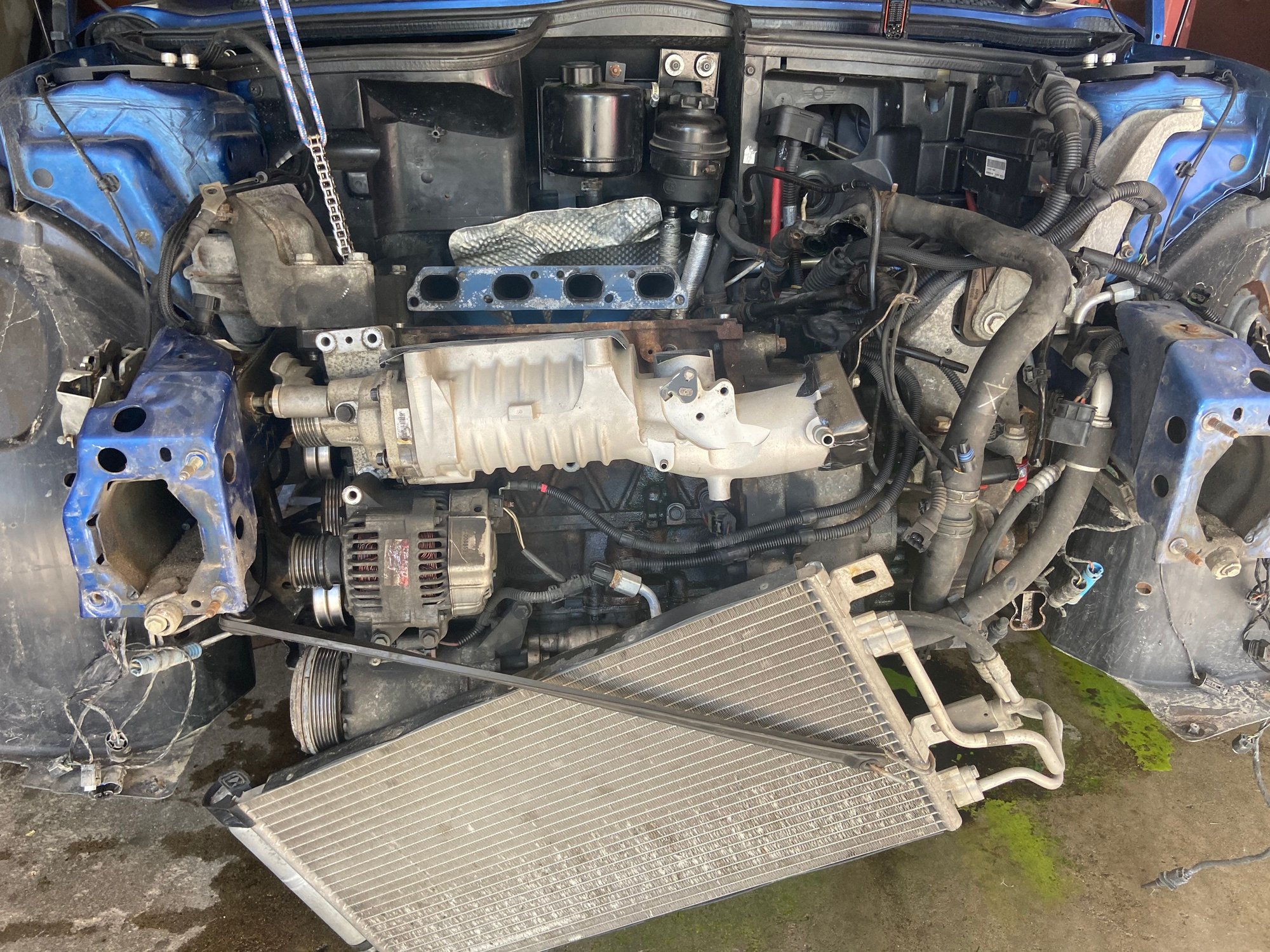

Welp the m62 is on, bugs worked out, and im running logs right now to finalize the tune but she lives with a cobalt eaton M62 supercharger running a JCW pulley and making 21 psi at 5k rpm.

Outstanding!
However, (no offense), Installing all those great mods....on a filthy engine?
Again - no offense.

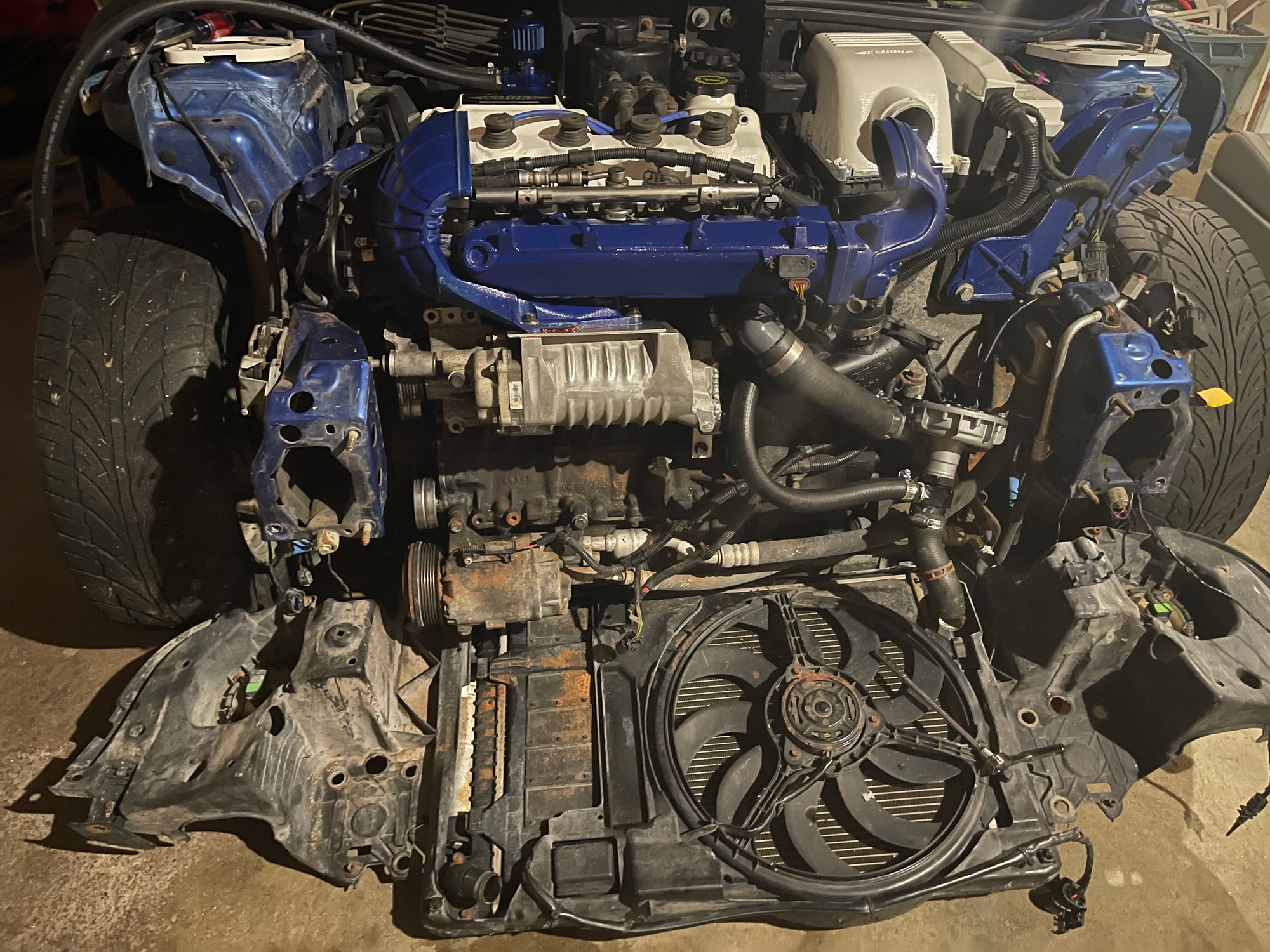

gotta rework a lot of other things to keep it. It can be done. Working on one right now with a custom intake.

As far as I can see on my R53, the existing intake system (TB, intake hoses) and AC lines are the only thing in the way.
However, I'm not sure of the trans bell housing.

the trans is in the way, it has no bellhousing its all one unit. but you can carve it down 3/8" and shave the super inlet to match and it will clear as long as you shave the back side of the case those 2 mounting points still need to be removed.
