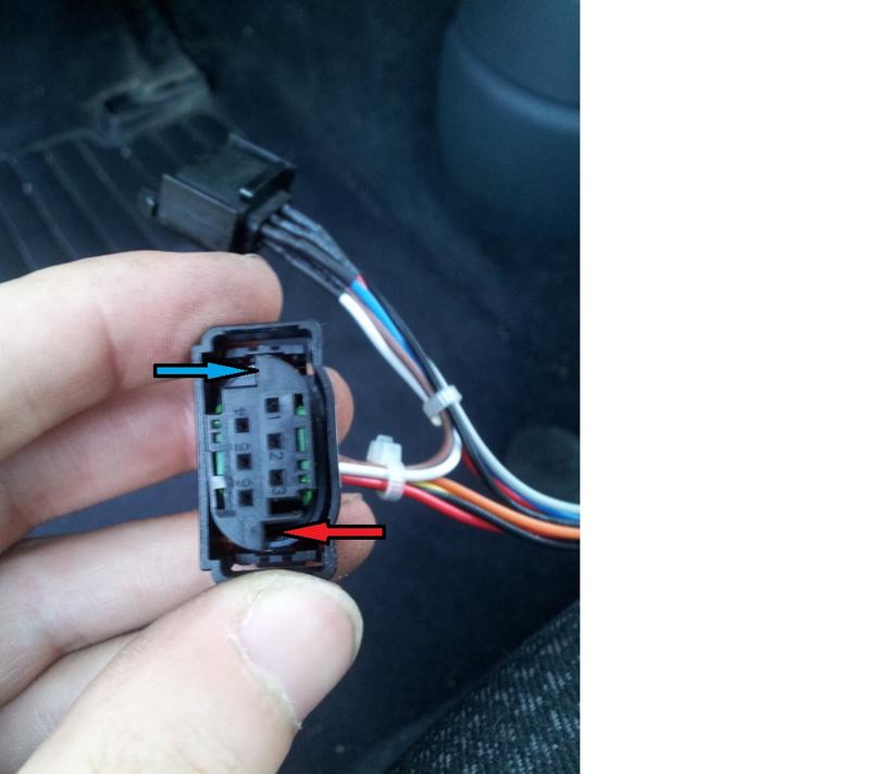

has anybody tried installing this on a 2002 r50? I dont see why they would make the pedal connector different than the other years, but I'm getting the impression that they did and im ready to rip my hair out.
So this is the pedal connector:
and this is the D1 spec connector:
now if you look on the connector on the pedal (1st pic) there is a nub above the pins (the only part of the plastic that looks torn up after I hacked away with a screwdriver) that gets in the way of the D1 Spec connector and it wont plug in. Im on my way right now to buy a very small Exacto blade and try to cut the nub away altogether, and then it should work fine. If anyone else had a similar issue then I would feel a little better about this.
EDIT: I also just noticed looking at these pics that there is a nub on the bottom that mirrors the top one and will also get in the way (next to pin#6). Great.

Dominic, you will have to "modify"the plug that comes with the DS1 kit. I had to do this on the R53 as well. On the "wing" portions of the connector, you will have to take a small pair of needle nose pliers and break out the ridge with them.
Attached Thumbnails D1 Spec Throttle Boost REVIEW!!!!!!!! FINALLY!!!!-plug.jpg

Also, be careful as it looks like you are already bent a pin and tore up your throttle pedal a bit.

I fixed the pin and cleanly got rid of those nubs on the pedal and the D1 spec connector fits nice and tight. The rest of the install took all of 30 seconds.
