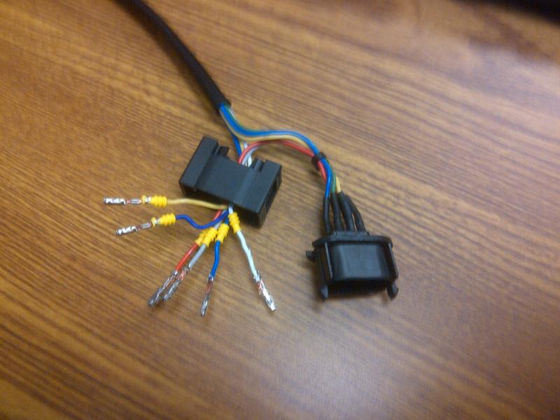

Okay, here's the deal: As discovered by myself and Baker, this device requires modification of the male connector in the throttle housing on an R53. Maybe the OP has an R56, which may not require the mod? One needs to be extremely careful when handling the harness, or you risk damaging it (as I did) by just trying to plug it in. It turns out one or more, wires pulled out of the pins inside the female connector, rendering the cable useless. A&J was responsive to requests for help, but their resolution was "send the complete unit back, and we will fix it", rather than sending me a replacement cable. Knowing they would claim that i broke it (likely i did), I figured i had nothing to loose in trying to repair it, and disassembled the connector. I DO NOT recommend attempting this: we work with similar components at my place of employment, and have the correct crimpers, pins, etc. Even getting these apart is tricky to do without breaking the connector. i found 4 of the 6 wires pulled out of the pins. Once repaired, the connector was re-assembled, and the installed in the car, and the D1 is working now as advertised.
To sum up:
1. You have to modify your throttle pedal connector to install the harness on an R53.
2. The harness was not assembled very well: there is no way the wires should have come out that easily. This raises a reliability concern.
3. A&J was willing to help, but shipping parts back and forth is not the quickest way to get the issue resolved.
