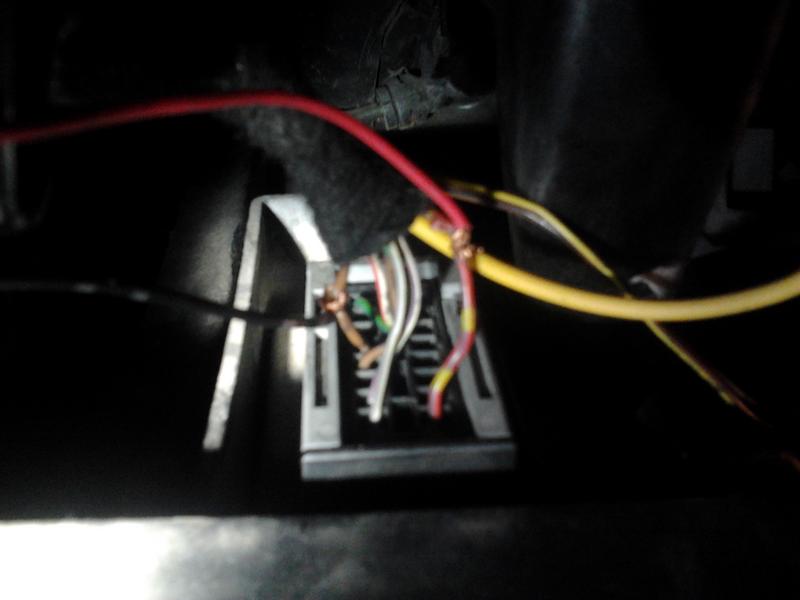

Alright - thanks pmx, almost had it all together then. I thought the pedal was going to be rough but I had that sorted, plugged in and re-assembled within minutes.
It was the OBD plug that didn't feel right to me. It was hard to see and wasn't sure if i seated it right. I probably shouldn't have tackled this at my son's soccer practice and without taking the knee panel down. I ran out of daylight and decided to unplug everything and do it right this weekend.
For reference, once it's plugged in completely, will the display light up with just the key in or does the car have to be running?
Thanks for any help or advice. I kinda figured this out on my own just looking at the wiring diagram. Reading the directions were pretty useless from the install side - I'm hoping the set-up side is easier although looking at those directions looked awful, too.

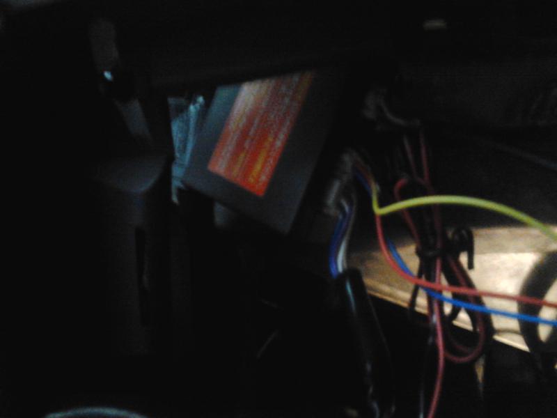

Hi albiecrazy, i have the same concern about the OBDII conector so i hardwired it , the screen will ligth up when you put the switch on and remember to set it before you start the car , here some pics of my instalationD1 Spec Throttle Boost REVIEW!!!!!!!! FINALLY!!!!-2012-09-22-16.40.38.jpg

Dumb question for pmx - when you say turn the switch on, do you mean the ignition or the left switch on the display? From the 'directions' it seems the ignition has to be on... And lastly, will every plug have to be wired up before I will get anything on the display? Thanks in advance.
Old Sep 28, 2012 | 02:36 PM
  #238
jay80424's Avatar
jay80424
Joined: Jan 2008
Posts: 259
From: Breckenridge, CO
ignition to "on", but not start.
The unit will be powered off until you turn the ignition key.
I would get everything plugged in before you turn the key, and make sure to wait 10 minutes after you turn the car off before you unhook anything.
Turn car off>wait 10 minutes> install>turn key to "on">callibrate unit per instructions> Start car and test drive>grin ear to ear.
