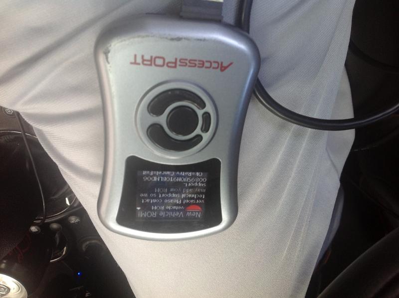

Guys need help I just bought AP from another member here and I'm having trouble with not recognizing my car. It's asking to contact AP for update. How do I go about doing that?? I took a pic below of the issue. Please help thanks
Attachment 81836

Download the Ap manager and update the AP to the current firmware. That should help
Old Sep 28, 2013 | 09:50 AM
  #3546
TerminalVelocity's Avatar
TerminalVelocity
Joined: Nov 2011
Posts: 1,073
Did you download the ap manager on your computer and hook the ap to it for any updates before putting it in your car? What year is your car? Model? Sent from my iPhone using NAMotoring
Unknown ROM usually means your ECU isn't known to the AP if I remember right.

I suspect he might have n18 motor.

Sorry for delay response guys and thanks for your tips/help. I had to download the Ap manger and update the firmware on the unit itself for it to recognize my car, once I did that it worked w/o any issue.
I have 2009 MCS with Invidia catback, and AEM intake, I chose 92 oct stage 1 option.

Cool man. Glad it worked out. That's generally what the issue is.
