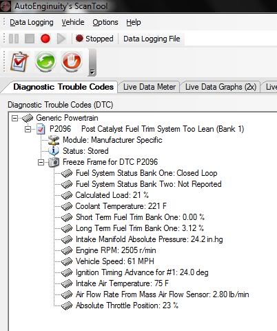

That is probably it. Since you have the factory catback installed, you should be running the stage 1 map. With that map, you shouldn't have any issues whatsoever. The car is probably not seeing the boost that it wants to see, and is cutting boost.
Boooooo.
I'm not planning any other engine performance mods aside from a FMIC. Guess I'll knock it down to stage one until the FMIC is installed then get a pro tune. The difference between the 91 oct and 92 oct stage 2 was night and day IMO. I'm probably gonna cry at stage 1. Do you have a "mail order" tune option available?

Pulled the code. It would appear this is the post cat o2 sensor. I thought the tune disabled it? If not you should know I was hard headed and tried using the "anifouler" mod (spacers) despite the numerous post about it not working. If the ECU still wants to read the post cat o2 sensor, I'll need to remove the spacers.
P2096 Post Catalyst Fuel Trim Too Lean
