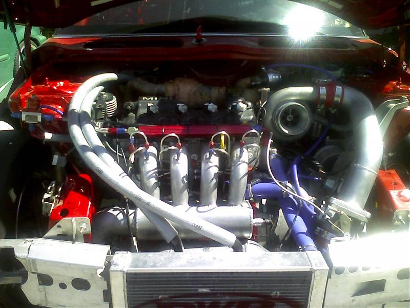

Iv'e seen the Asian import tuners do some really amazing stuff with squeezing FMICs into unusual places.
Yes, it's called a sawzall
Most Mini owners are NOT going to do that to their cars. Some of us do
https://www.northamericanmotoring.co...4&d=1183697570
Now THATS what I'm talking about. Ingenuity!
I bet a custom FMIC would fit if the lower grill was removed. It could be treated black for stealth…
Kinda like what some of the 204SX & Evo guys are doing.
