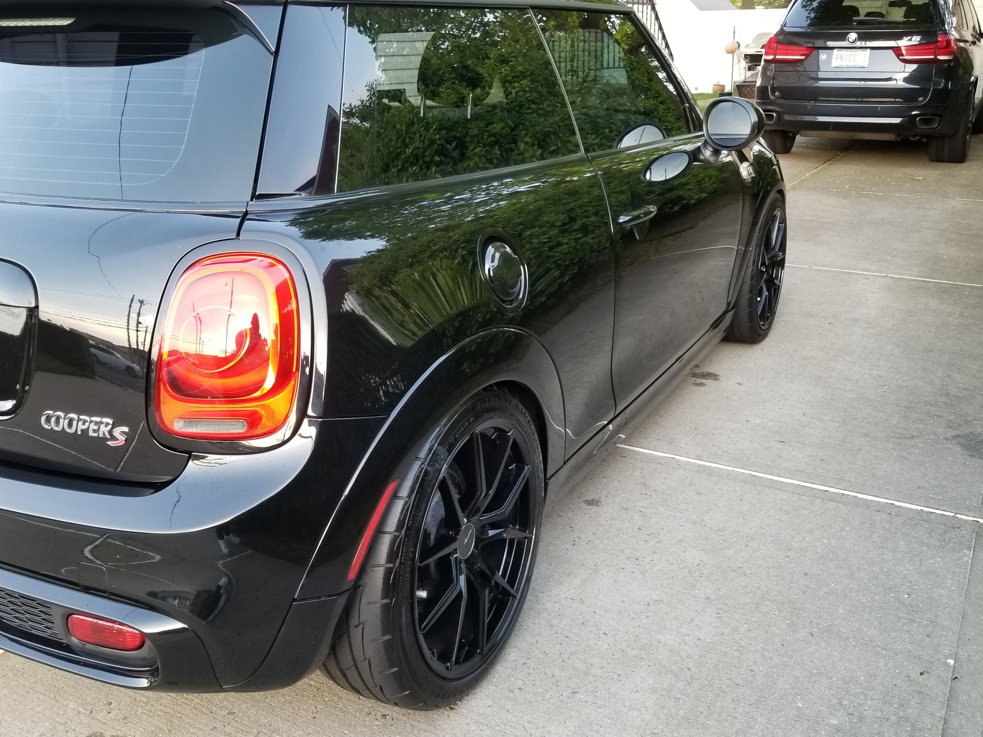

17x8 Enkei RPF1, 45mm offset, 215/45/17 Michelin PSS tires. No rub, No spacers needed with stock 205 runflats, currently using a 3mm hub centric spacer with the slightly wider 215 Michelins

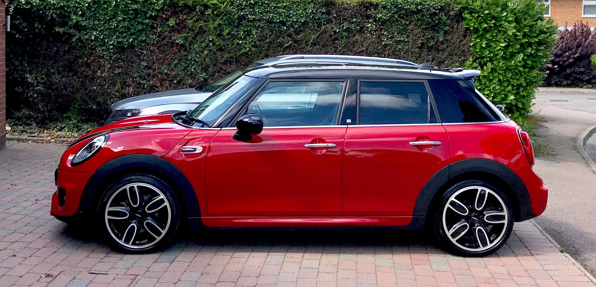

Hey all, my first post on here so go easy on me
I’ve recently bought a Cooper S and it has the 18” Cup Spoke wheels with standard 205/40/18 Pirelli P7’s on (runflats).
I’m not looking to fit aftermarket wheels but I want to remove the runflats and fit a slightly wider tyre. From doing a bit of research I know that 215/40/18s are fine (no rubbing) and there looks to be a lot of clearance in the arches so I’m thinking of trying 225/40/18s. They are about £20 per tyre cheaper too (I’m in the UK).
Has anybody done this on the Cup Spoke wheels? I know the circumference will be about 4% bigger so the speedometer will be slightly out, but I can live with this. I’ve measured the width of the wheels and they are 7.75”, so I presume that’s 7.5l nominal size.
Any help would be much appreciated, somebody must have done it! Suspension is stock, as per Cooper S, not lowered. Pic of current wheels below.

Welcome to the forum & nice looking MINI. I have a 2015 F56 JCW with cup spokes and the same tires as you have.
I’ve researched wheel & tire combinations from the early days of the F56 JCW, and some of my thoughts might not apply to an S, but here goes anyway.
You have cup spoke wheels but unless you know for sure they are likely not the same as the cup spokes on a JCW. The JCW cup spokes are only 7 inches wide which creates some of the fitment problems for optional tire fitment, and the spokes are curved outward more dramatically to clear the Brembos. Make sure your wheels are indeed 7.5 inches wide. Check the specs for your wheels part number.
That being said, and assuming you do not have the JCW Brembo brakes, the 225’s will likely fit fine. If I was to ever change tires I wouldn’t go over 215/40/18’s to avoid rubbing and have plenty of room from the strut.
You could always just do a trial fitment before buying a new set of tires too. But remember, tire sizes vary from manufacturer for the same spec tire, so one 225 tire might rub whereas another make tire might clear fine.
I’m with you though in that I like the fatter rubber on the F56 body style.....the 205’s definitely look skinny, but I still love my stock JCW!
Good luck!

On stock suspension, you can go wider. 215's are safe, but if you want to go with 225's you may need a small spacer depending on the tire.

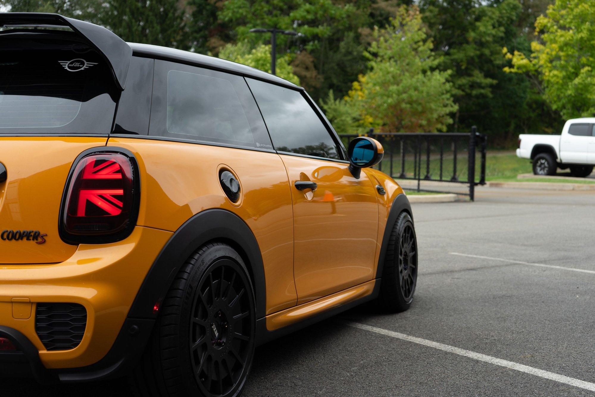

ADVAN Racing RSII 18x8 +42 w/ Continental ExtremeContact Sport 225/40/18

Somehow I find it hard to find info on this. I installed michelin pilot sport4 225/40/18 on stock jcw cup spoke wheels and has no rubbing at all. hope this helps

Very clean @u2asian I love it!
