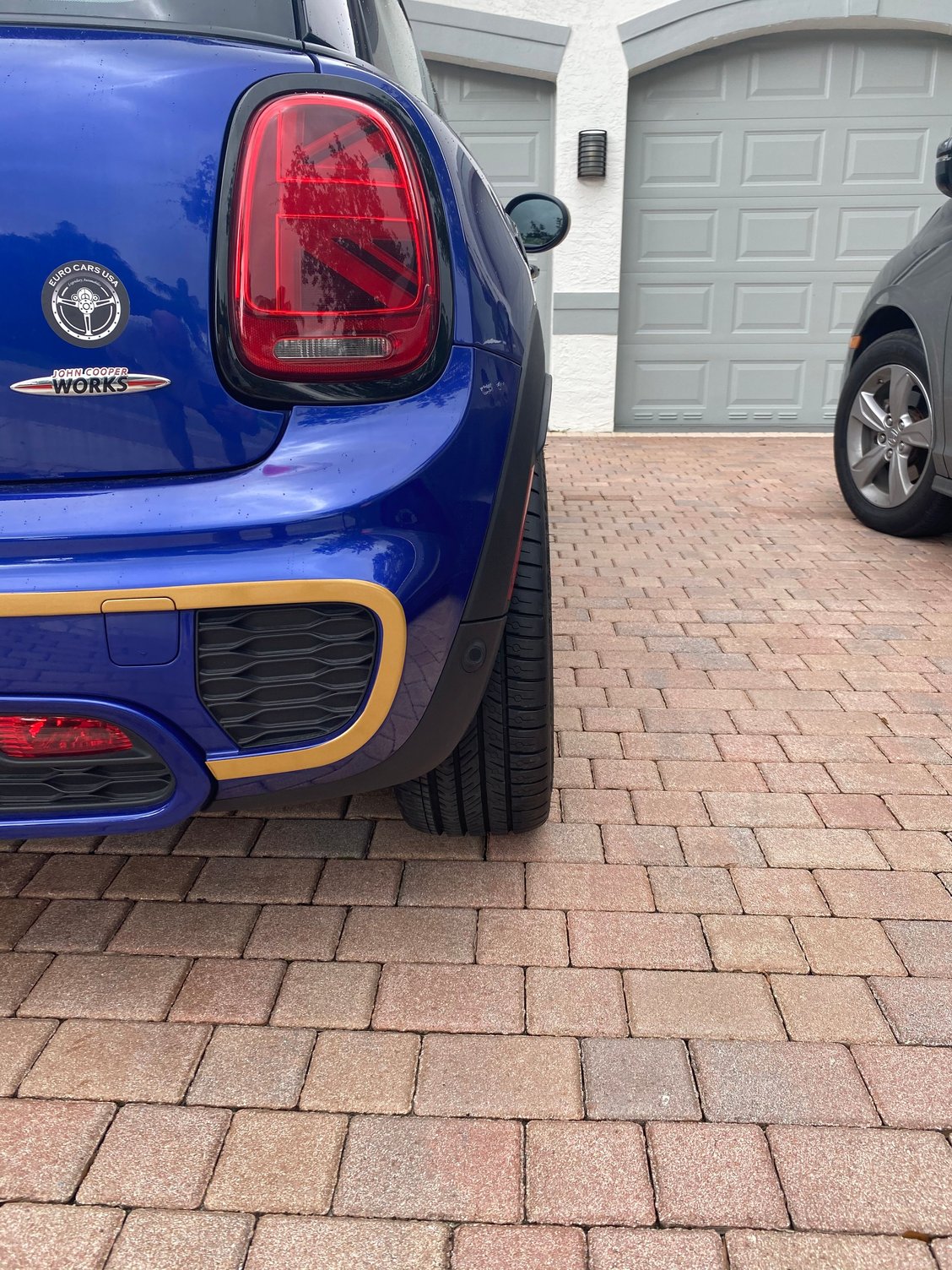

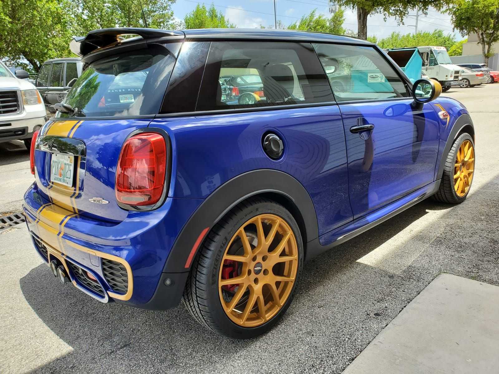

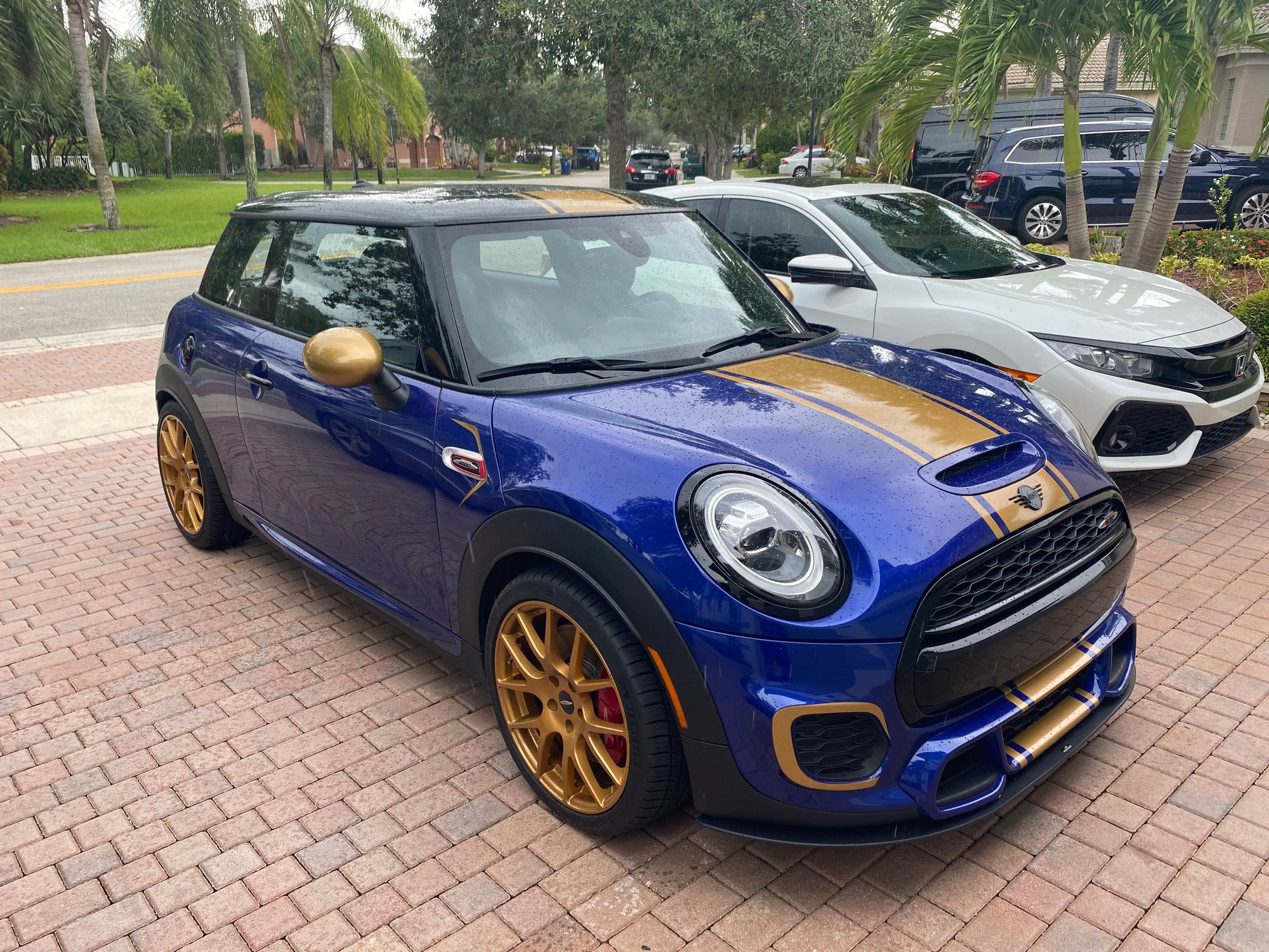

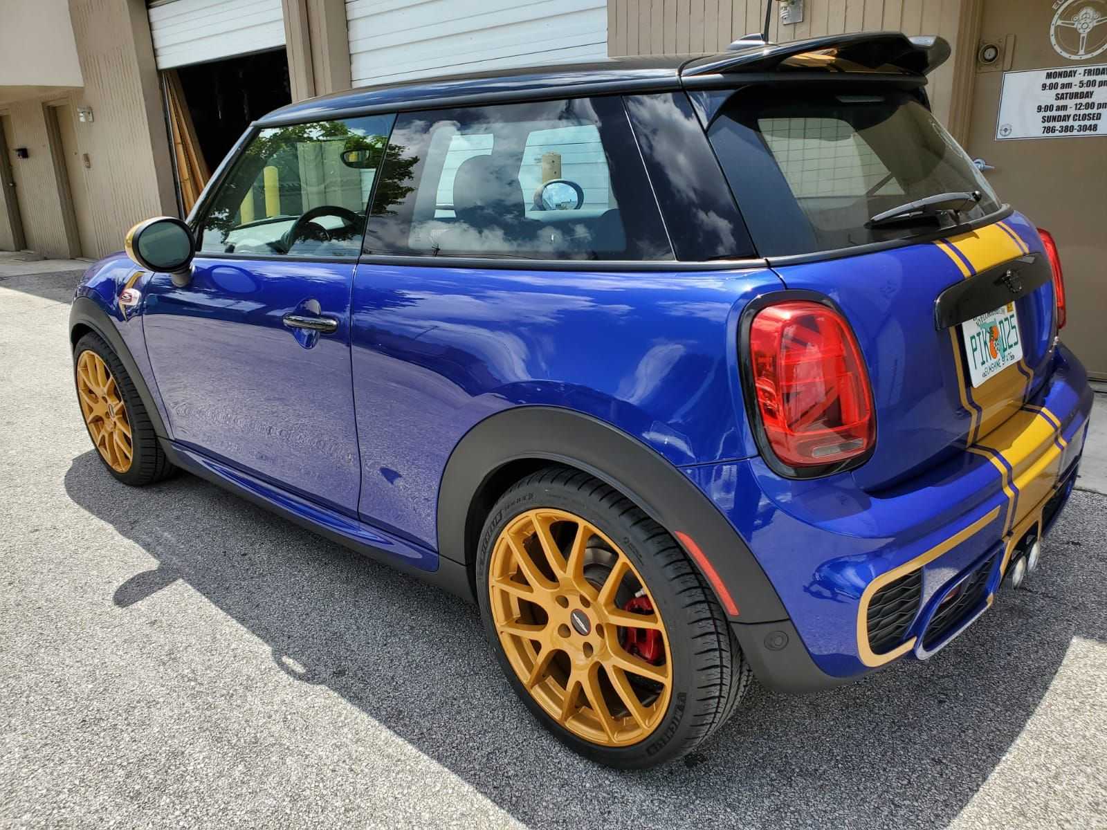

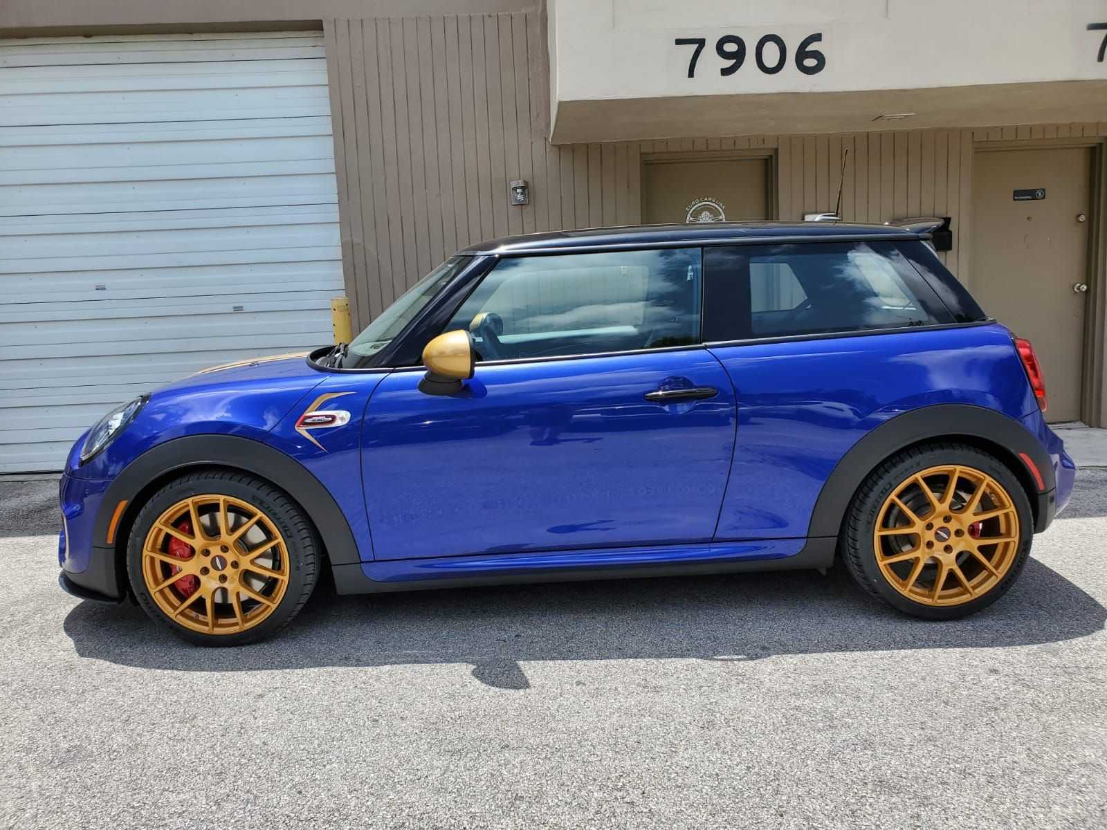

Finally done JCW F56
So finally it’s done
2019 F56 JCW
schnitzer from lip
manhart style graphics minus the sides
racechip GTS
NM 25 mm rear sway
NM strut Brace
JCW pro exhaust
and lastly the wheels .... RSE12 18x7,5 wit Michelin rubber 215 40 18.
No mods to the suspension yet
everything fits fine no issues with the calipers no running no nothing
Still I think I would like to lower it 1 inch maybe.
