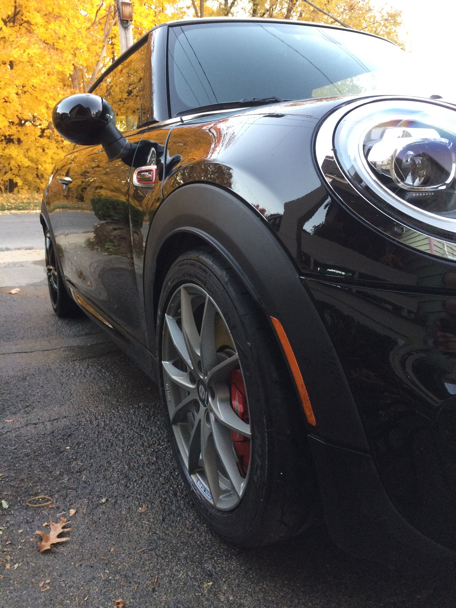

Having read all that I could about wheels and tires that should fit my JCW, I went out and bought a set of the NM 17” RSE05 Wheels and Yokohama A052 225-45x17 tires. The wheels are 7.5” wide and ET40 (vs 54 for the stock wheels). And I have the JCW Pro suspension, same as some others with this setup.
Looked darn good:
Meatballs on the edge (Yokohama 225-45x17)
But then I heard the rubbing... And saw this:
Tire rubbing on the wheel well arch
And this on the tire. The marks are just some melted plastic; no tire damage. This was just on the rear. There were no issues with these on the front. Plenty of clearance with the coilovers.
Wheel well arch rubbing on the tire
I must have a 98% scale F56, as this was not supposed to happen...
Unfortunately, I consider this to be unacceptable for the track. A rubbing tire at 120 mph would not be good.
So, some smaller tires:
225 Yokohama vs 215 Falken
These are the new 200TW Falken tires in a 215-45x17 size. These performed well in the Tire Rack test and they were about $65 less, so why not try them.
I mounted them on the NM wheels. And they look good on the car.
Falken 215-45x17 on Albert
At this point the 215-45x17s on the NM wheels seems to be a really good fit. No rubbing on any of the roads I have been on. Of course, my wheel well arches have already been “trimmed”.
As for the Falken tires... First impressions are really good. Maybe slightly “softer” than the Yokos, but not so much that I would care. Turn-in is crisp. Ride is about the same. New, they are slightly noisier. I expect after being on the track, they will be really noisy.
Not sure what to do about the Yokohama tires. Unfortunately, with about 100 miles on them, I have my doubts that TR will take them back... I have thoughts of trying them on the Enkei Racing wheels with the ET50. I already have a set of 5mm spacer and longer bolts. Or if I really like the Falkens, maybe just sell them and someone will get a bargain set of great tires.
