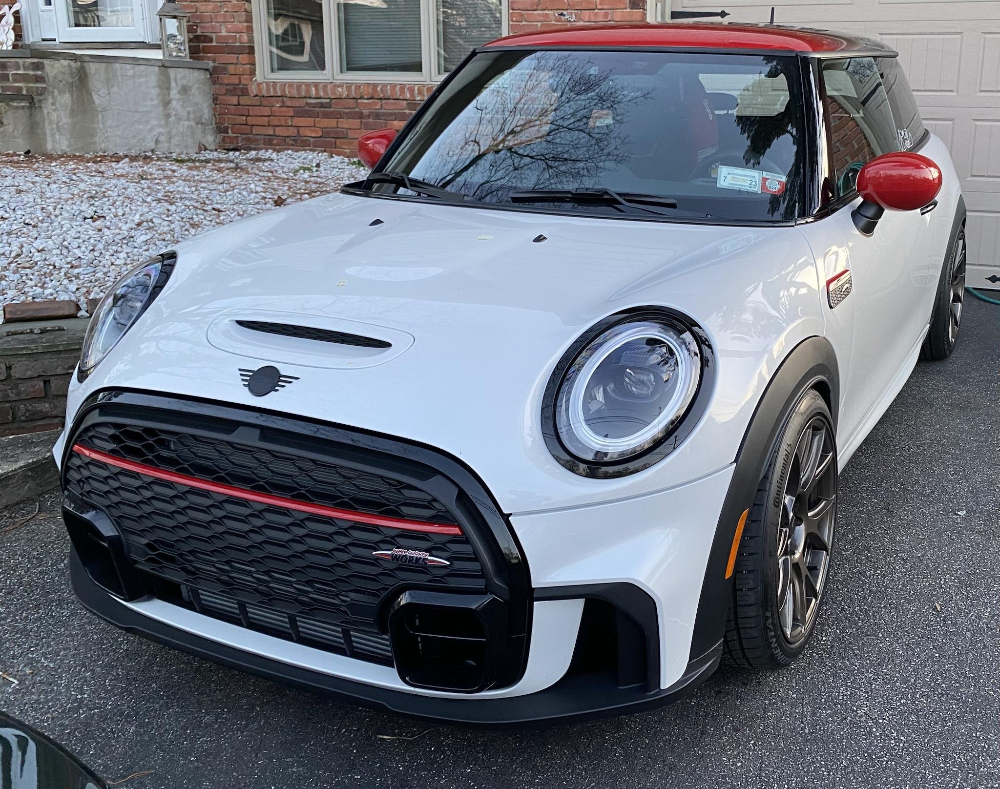

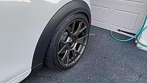

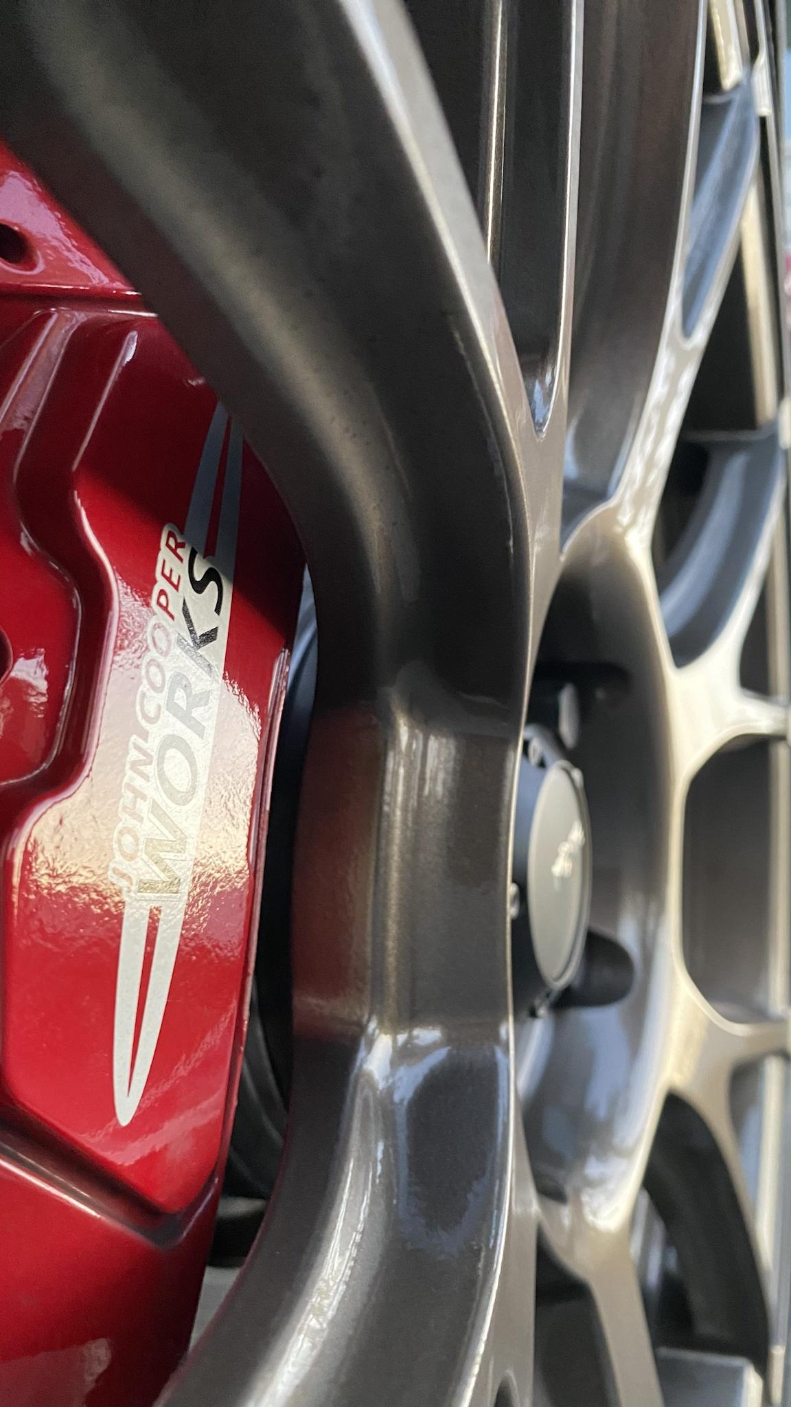

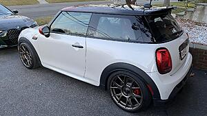

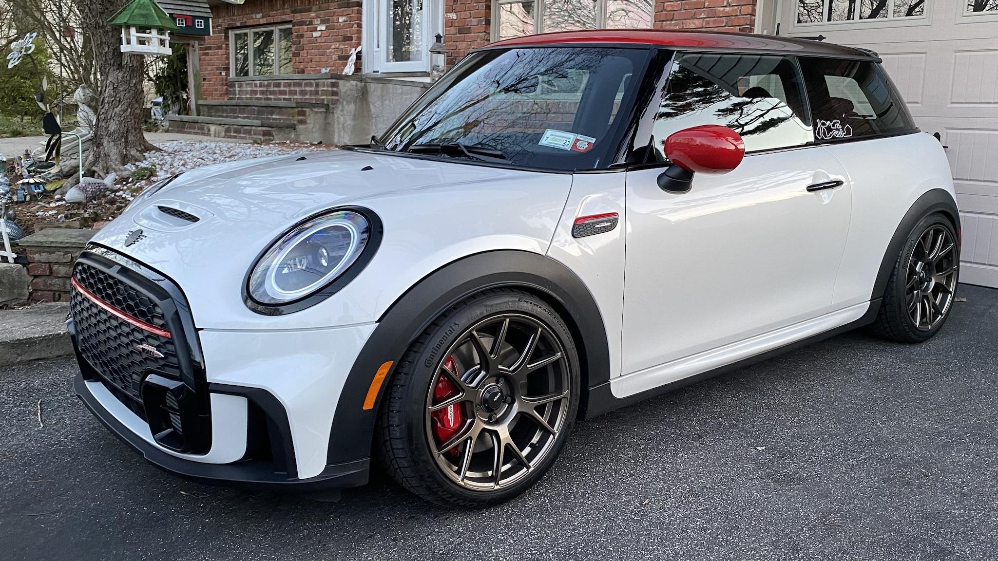

Just got my new wheels sorted, they needed a bit more work to get the fitment right then I expected but I think the end result was worth it.
2023 JCW Hardtop
18x8.5" +43 König Ampliforms
225/40r18 Continental DWS 06 Plus tires front and rear
10mm spacer in the front for brake caliper clearance, no spacer in the rear
Silver project camber plates to add 1.5 degrees of additional camber up front so they don't poke out from under the fenders
The car is lowered on NM springs
No rubbing on this set up and it clears the front caliper by about 2.5mm.

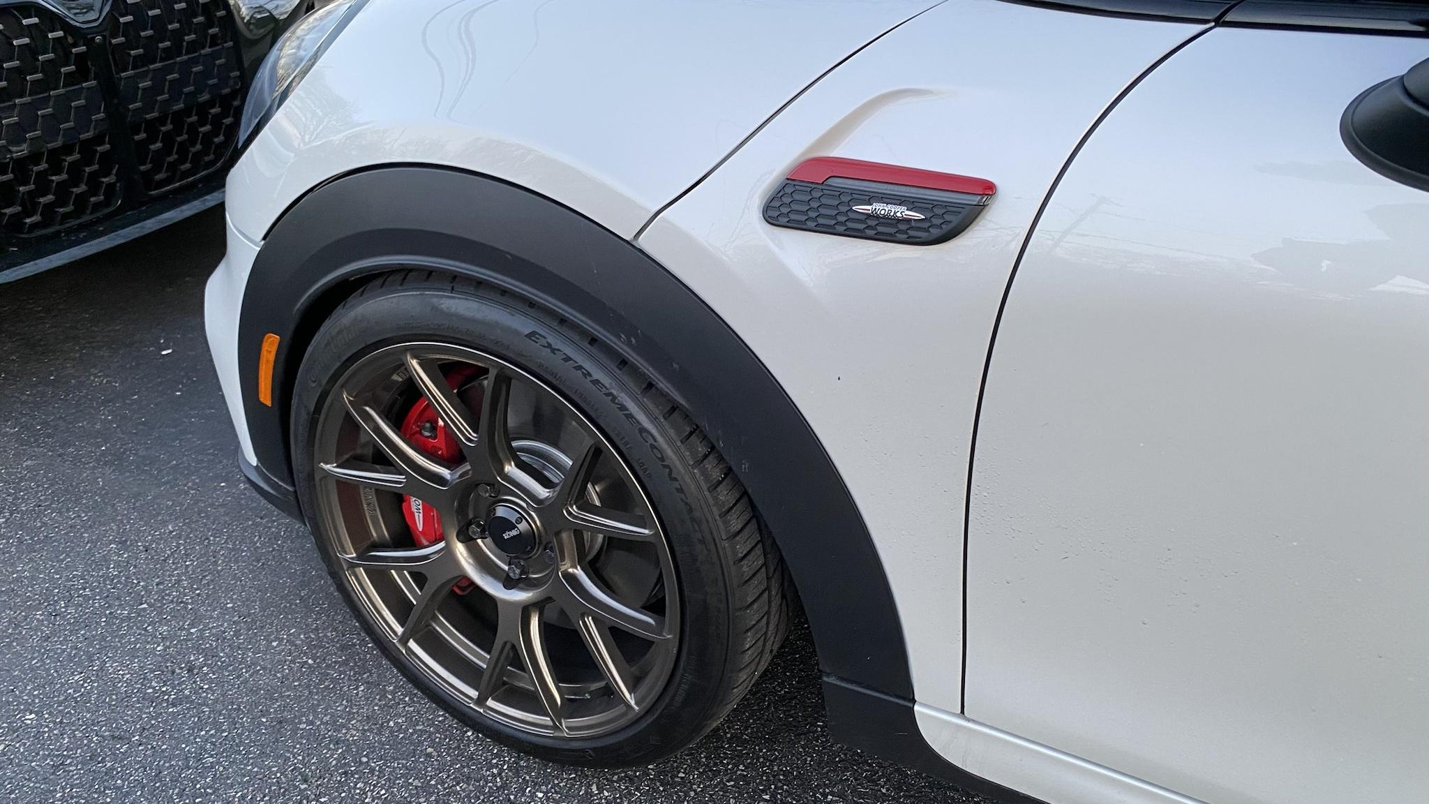

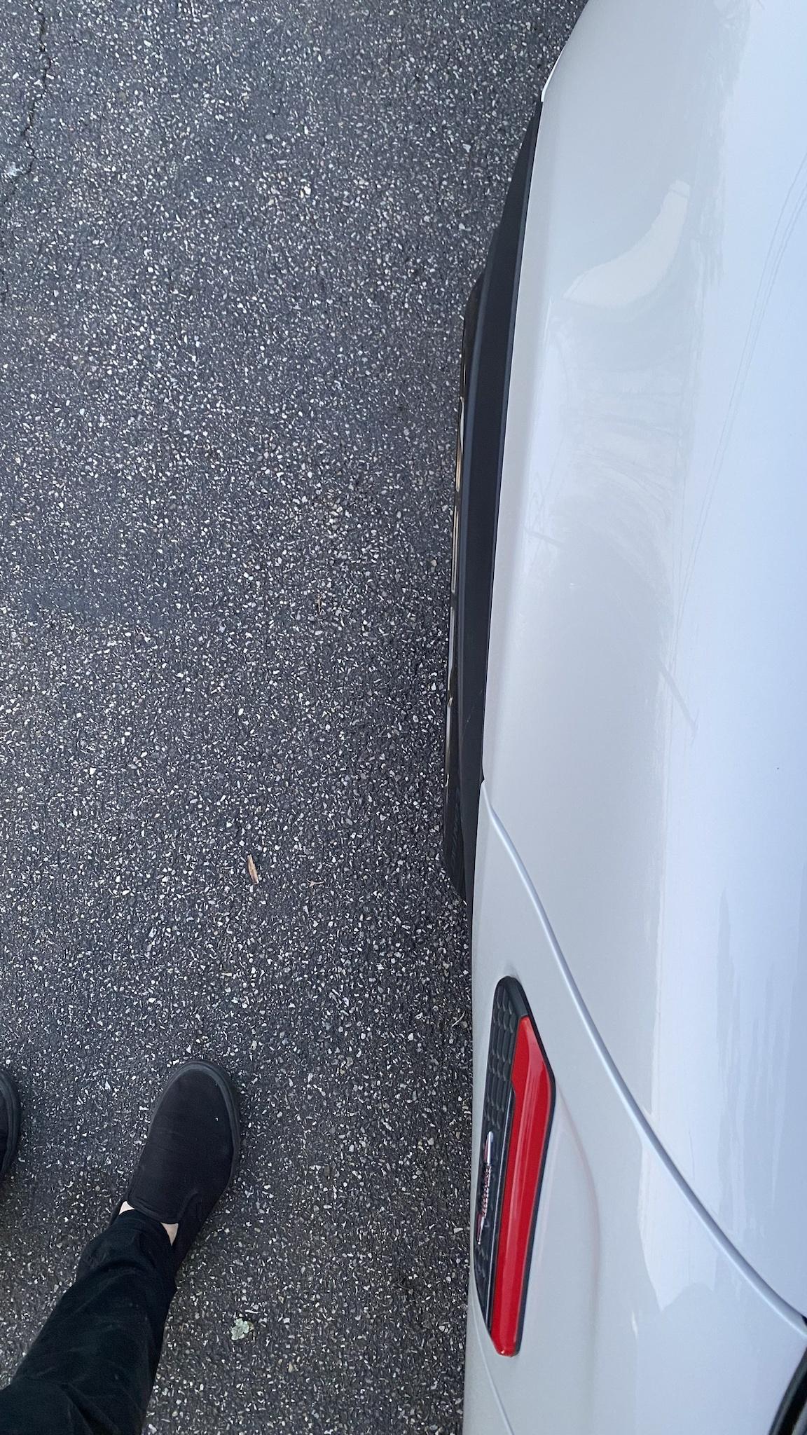

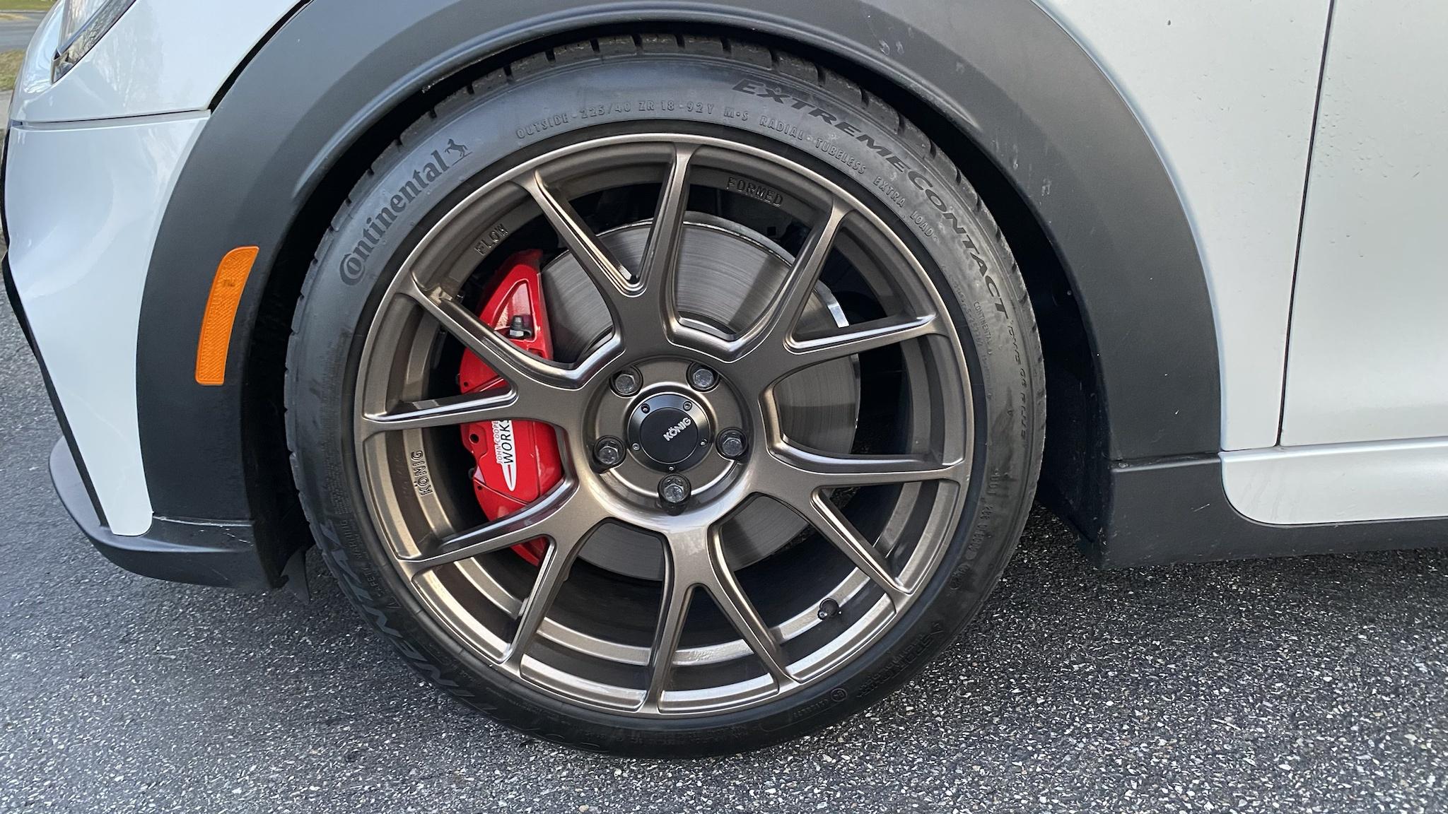

Wheels: Enkei - TS9 - 17x8 (ET45)
Tires: Continental - Extreme Contact Sport - 215/45R17
Hub Centric Rings: Wheel Connect (from Amazon) 72.56 to 66.56
TPMS: BHSens with Black Metal Valve Stems
Spacers: 2MM Dinan Spacers (for front)
WEIGHT:
OEM Style 501 17" with HANKOOK- OPTIMO H426B HRS [Run Flats]: 46.6lbs
Enkei TS9 17" with CONTINENTAL- EXTREME CONTACT SPORT: 38.6lbs
I installed these wheels on my 2022 F56 JCW. As stated by other F56 owners with this same wheel, at stock height and with 215/45 tires, it'll clear the strut and front JCW calipers without spacers. However, it is REAL CLOSE to the JCW front caliper, about 1mm. I went with 2mm spacers to give a bit more space between the caliper and spoke as I plan to track the car.
POKE:
Rears: Are 5mm inwards from the fender (however, be warned that adding a 5mm spacer or more would reduce the hub lip contact to the hub centric ring by quite a bit, so that could lead to vibration)
Fronts: WITHOUT SPACERS, it looks pretty darn flushed to the naked eye (especially with the tire curving inwards), but upon measuring from the wheel's rim, it does poke 1mm out. Adding 2mm spacers will poke out 3mm and you will see it if you look dead straight, but honestly, at any other angle looks flushed
Absolutely love the look and noticeable improvement in ride quality and steering feel.

Gotta tell the wheel alignment people to be careful with placing the wheel weights as there is a millimeter or two clearance from the front brake caliper, and my original set of weights impacted the caliper.
Yes I know the car is filthy in the pics :/
Question, I have same wheels on my JCW but plan on lowering it. I do have 2mm spacers for the front just because I felt 1mm gap between the spoke and brake caliper was too close. I plan on lowering; I have 2 questions:
1: Was the reason for the 4mm spacer to clear the suspension?
2: With 4mm spacers, was there enough height on the hub for the wheel to rest on so that you can center it? (I know 10mm and thicker have extended centric hubs while 9mm and below do not.)
EDIT: I just installed 4mm spacers. There was probably 1mm left on the hub to allow me to center the wheel and drive without any issues. Anything that's 5mm or thicker without hub extender, you wouldn't be able to accurately center the wheel causing risk of vibration. I've only seen 12mm (maybe 10?) or thicker that have hub extenders, but never 9mm or below.
