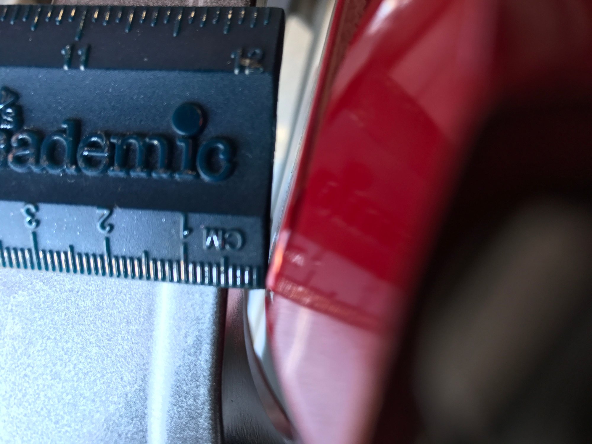

test fitting wheels today with a 10mm spacer up front on a F56 JCW
the wheels are OZ Legerra HLT 18x8 +48 & probably 215/40/18 tires
Looks like I have a few mm to spare (guessing 5.5mm )between the brakes, So I will try a 8mm next. 5mm would be really close, 6mm would probably work, but, really2x3mm spacers..?
