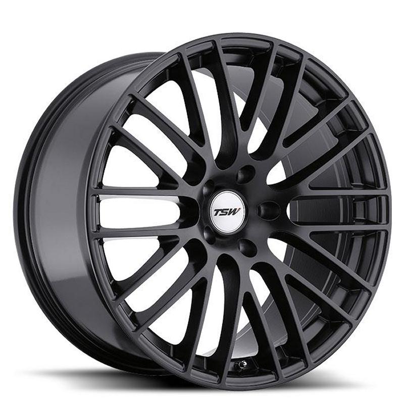

Just ordered a set TSW MAX Matte Black in 17x8 et 45 with 205/45R17s for my stock F55 Justa with the nasty small 15x5.5 wheels. According to the rep at TSW this setup will fit. Anyone running this size? If so any issues?

Looks good! No rubbing or other issues? What is the ET on these? I'm going with a 17x8 ET45 with a 205/45R17 on my F55.
