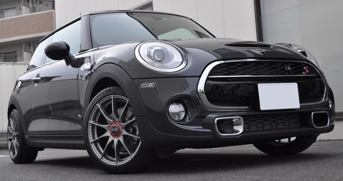

Also,
I'm looking into these O.Z. Formula HLTs and you can buy the "center locking cap" to cover the bolts and I think it adds to the aesthetic appeal (are not functional). My friend brought up the point that they will eventually fall off/would be easy to get stolen. I'm not sure how they attach to the wheel and I was hoping someone could offer insight on this/an opinion.
Official F56 Wheel Fitment Thread-photo916.jpg   Official F56 Wheel Fitment Thread-photo126.jpg
Reply 0
