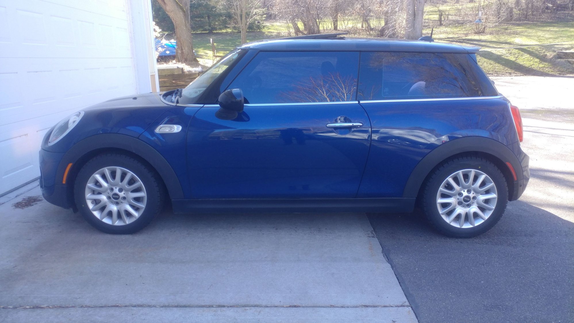

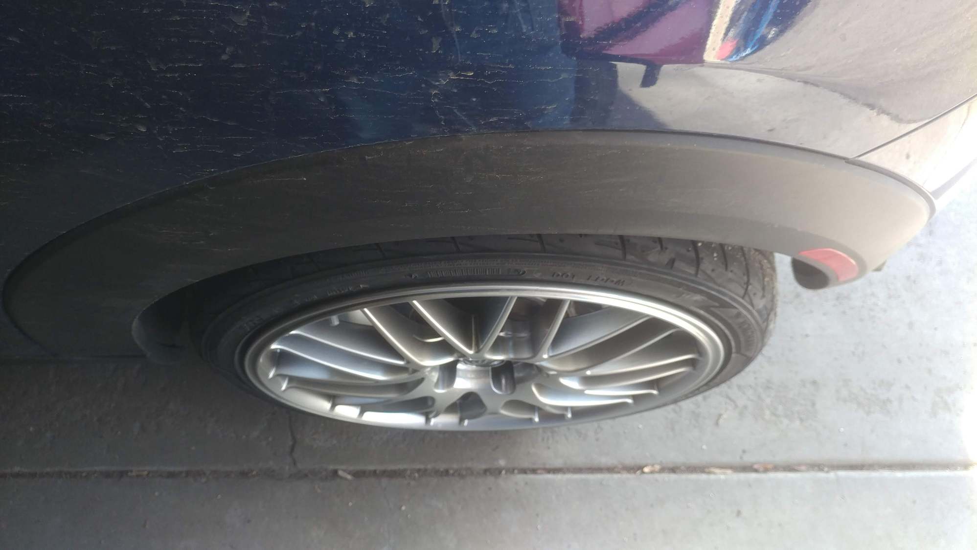

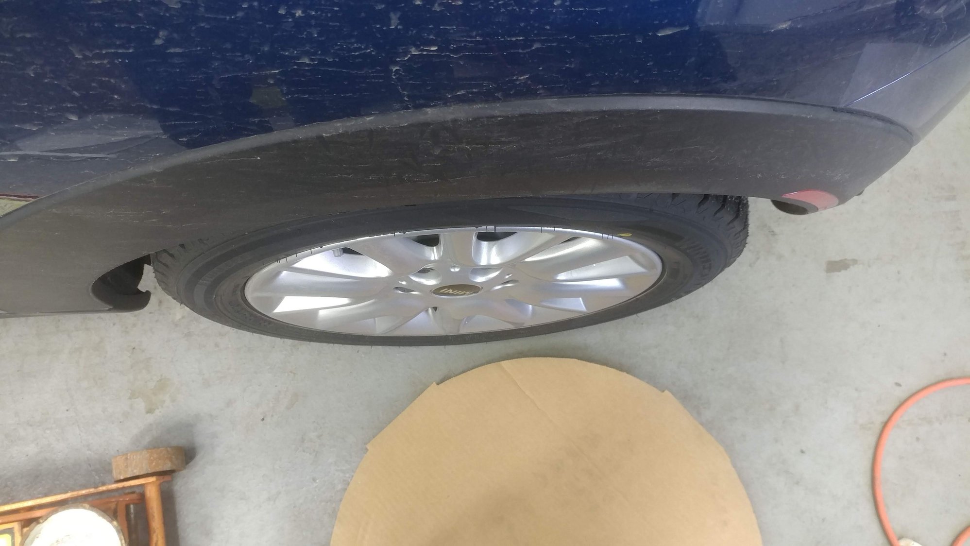

2015 Cooper S. 16" stock, went to Enkei EKM3, 18x8, ET45 Hyper Silver with 205/40 Yokohama Advan tires from TireRack

Rear poke comparison
Stock Poke
Enkei EKM3 Poke

TireRack did not list these wheels for the Cooper S. They listed them for the JCW, which made no sense, since any wheel that fits the JCW should fit a Cooper S. They fit fine with no clearance problems, The provided TPMS sensors were picked up by the car and work fine. Wife's daily driver, so I was more interested in appearance than performance, although the lower profile larger diameter tires significantly tightened up the handling which was less than inspiring on the stock 16 wheels with all season tires.
