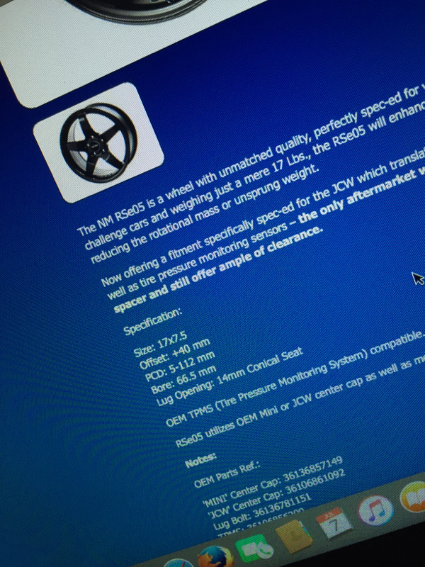

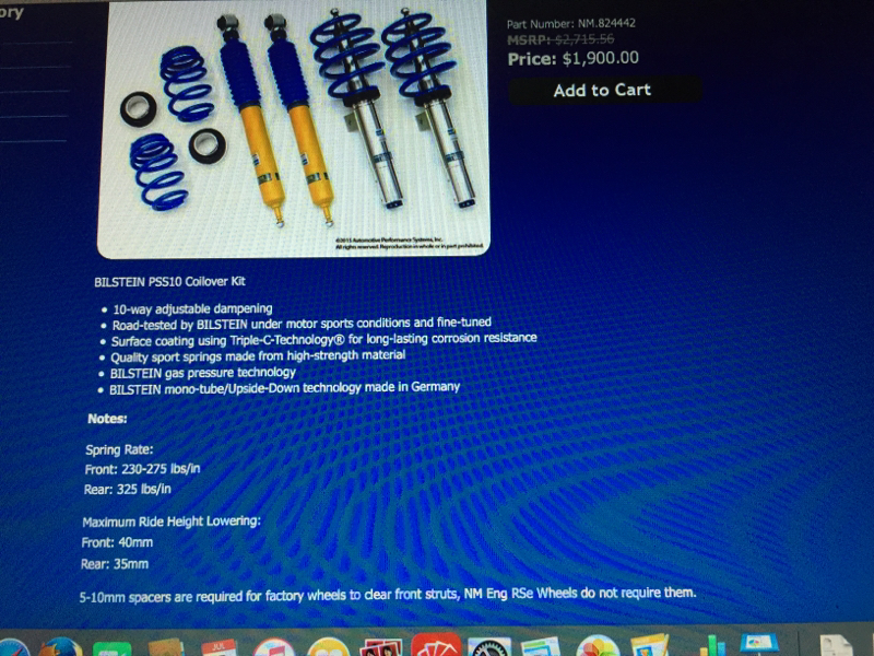

Jul 7, 2016 | 02:08 AM
  #729
Just across this when I was searching some parts for my mini. Read the last line in the 1st photo! And take a look the ET in second photo. So from my understanding, if you are looking to get coilover in the future you must get wheels with ET 40 in order to not use any spacers? Photos are took from NM engineering website. Is this correct?
Official F56 Wheel Fitment Thread-image-1160815080.jpg   Official F56 Wheel Fitment Thread-image-4224815038.jpg
Reply 0
