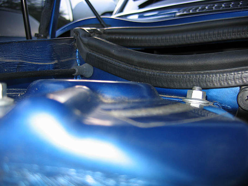

Am I mushrooming? pics enclosed.
I think I have some on the right, please advise. the black inner part you see looking into the top of the hole is not broken(name?) Why is the right more common, or is it? Is it possible for it not to progress if sharp edges are avoided?

Hard to tell but they don't look bad from what I can see.

Agreed it is hard to tell from the pix, but I would say some in the second pix.
Get the SRP's and then you won't have to worry.

You have hardly any mushrooming at all. With such slight mushrooming, getting the M7 SRPs will make all your troubles go away. If it had been more, then...well this is from another thread, same topic:
Originally Posted by nabeshin
The upper spring plate and guide support are also bent as much as the strut tower deflection. If the mushrooming is not to bad, pounding on it with a block of wood and hammer, followed by the M7 strut tower plate/bar will fix all your woes.
However, if you want a proper fix or if the mushrooming is bad, the strut must be removed so that the aformentioned parts can be replaced, with either OEM or camber plates.
The camber plates have the benifit of eleminating the risk of the rubber in the OEMpart of tearing, not to mention alowing camber adjustabiltiy. Oh, the M7 strut plate is a must after any pounding on the tower. Metal once deformed and pounded back looses some of its strength.
The deformed tower can be driven on for quite a while, but your alignment will not be perfect. Also, it might start to mushroom a little more over time. I myself had a mushroomed strut for the better part of 2 years, without continued mushrooming. I had it fixed it with camber plates, wood/hammer, and the M7 plates.

i agree get the M7s. Feel the tops of the towers. They should be flat. If you feel any bumps or slight creasing...get'em sooner than later...

thanks for the help. will order some today.
