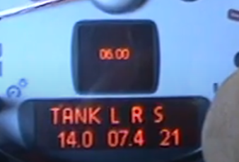

When I looked at the video, simplecarguy's menu 6.0 also reports different fuel levels from the right and left fuel senders. See image below. Maybe this is normal?

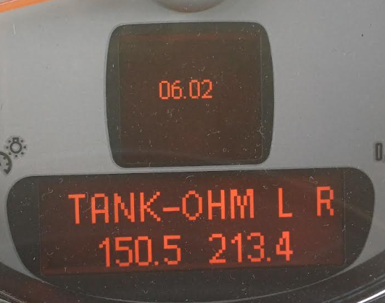

What does your menu 6.2 show?

Both 1 and 2:

Got it from a youtube video. seems for now normal:

Your menu 6.2 seems to report the electrical resistance readings from the two senders, which differs from simplecarguy'smenu 6.2 information.
Is your fuel gauge in the speedometer working as expected? If so, I wouldn't worry about the different menu 6.0 left and right readings because simplecarguy may have simply misinterpreted the true meaning, which is a mystery.
