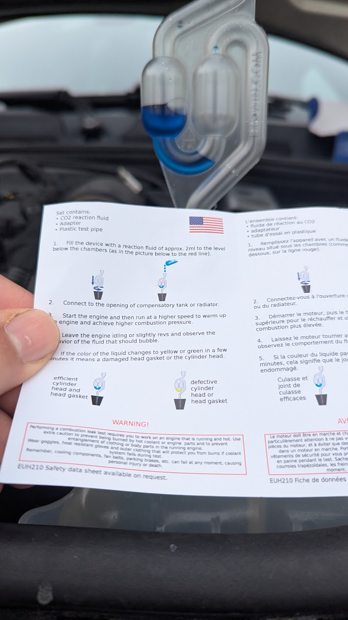

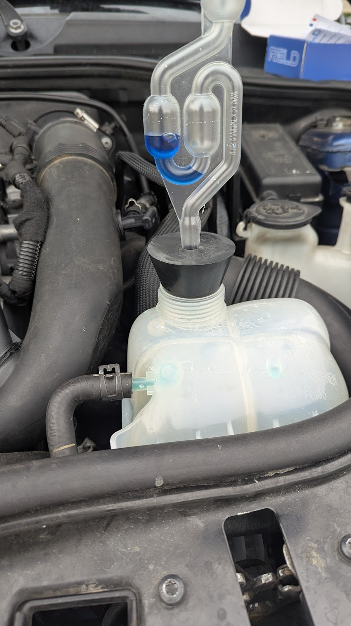

Ran the HG test. Now, this only tests to see if there is combustion gas in the coolant. It doesn't measure if the HG has broken between the coolant and the oil. But I've checked the oil and the coolant - visually, they both continue to look fine.
But I've passed the test with totally flying colors. Ran the car for about 3-4 minutes, spend the last 90 seconds revving the motor. Saw many bubbles go through the test fluid (big bubbles once a second). The fluid did not change color, even slightly.
Well, not the head gasket then. This is just a weird one: I'd think any air would've worked its way out by now. And it's not like the system would "suck in" air anywhere but the expansion tank cap, where it's supposed to (it has vacuum relief).
