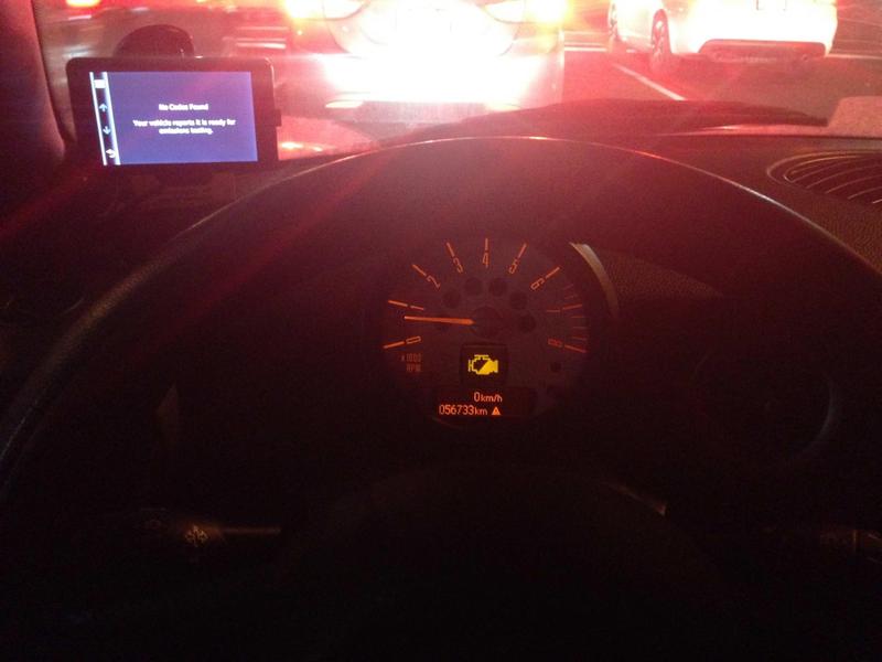

Ever since I had the engine harnesses replaced due the dreaded oil pump unloading solenoid leak, I too have suffered similar events.
No codes, self resets or after engine restart all OK...
Any thoughts? Anyone...? Bueller...? Bueller...?
