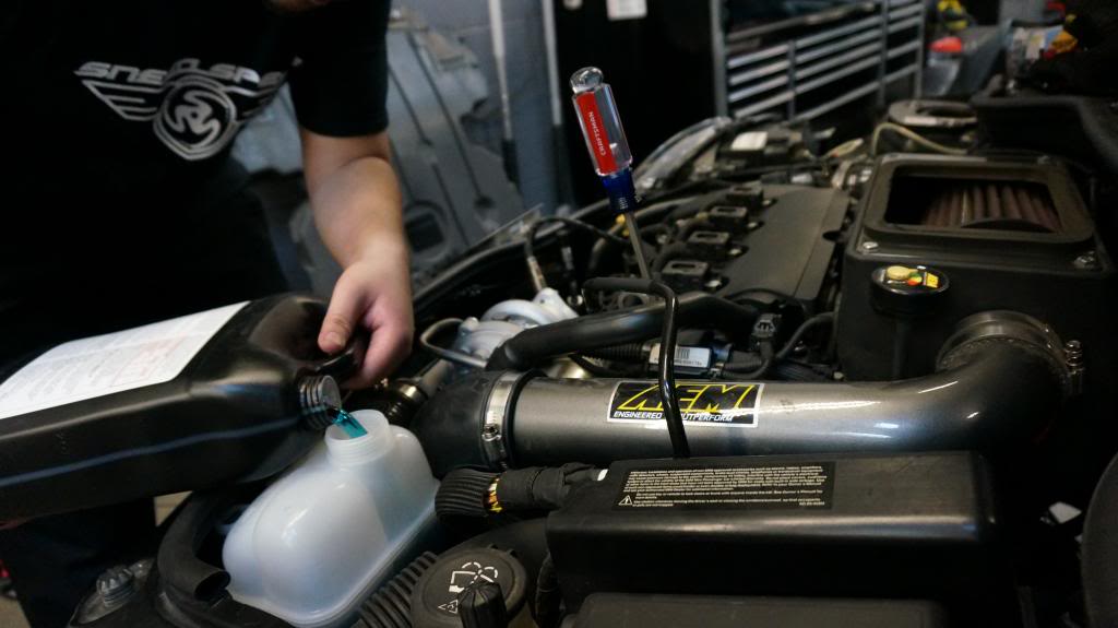

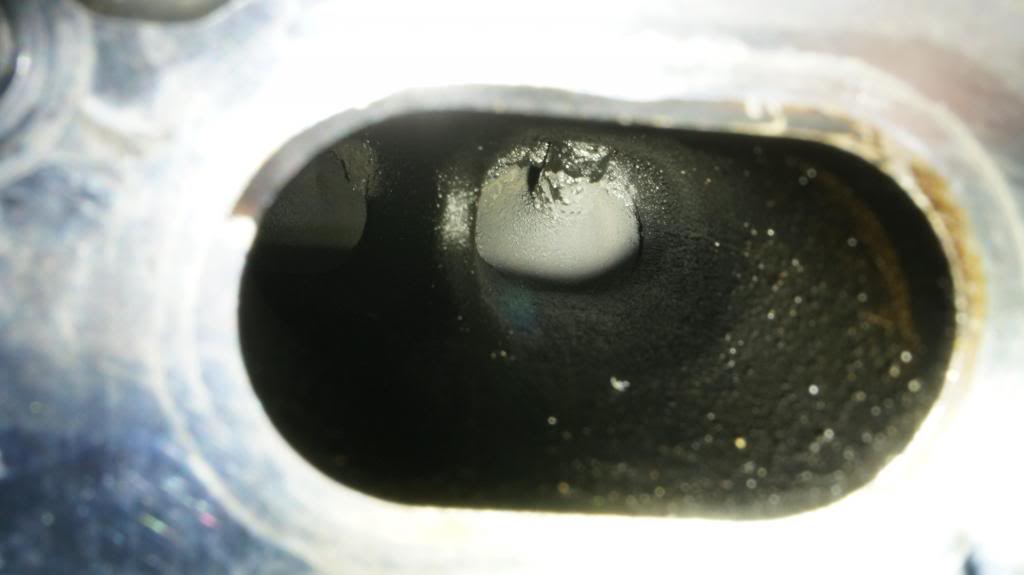

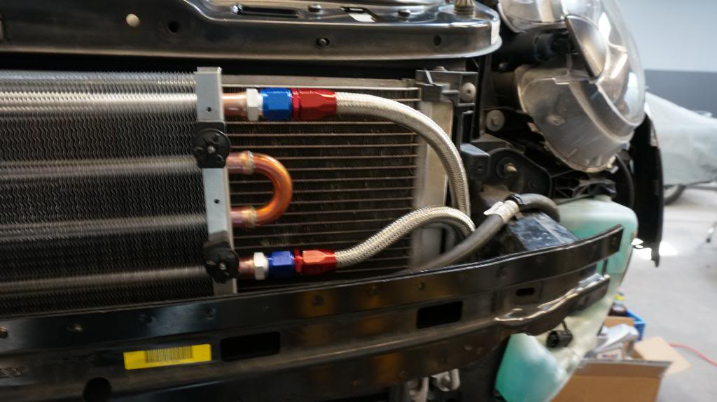

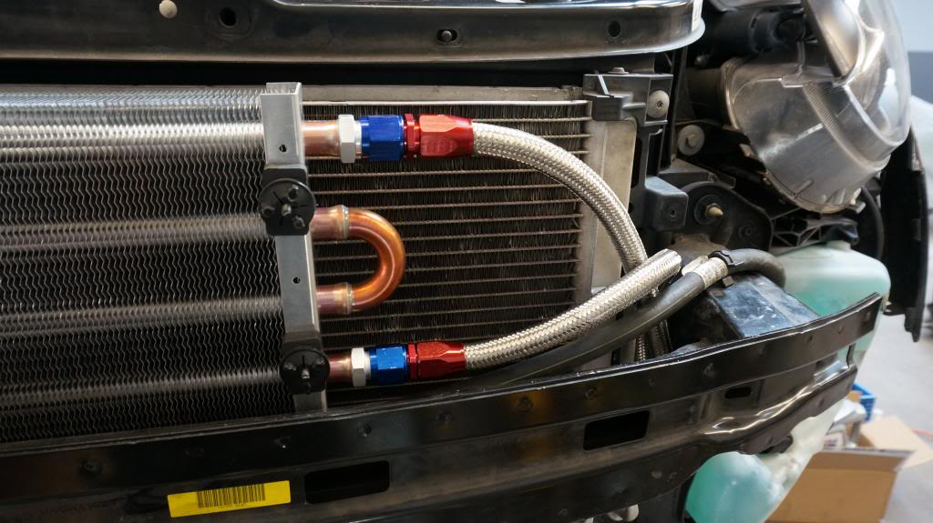

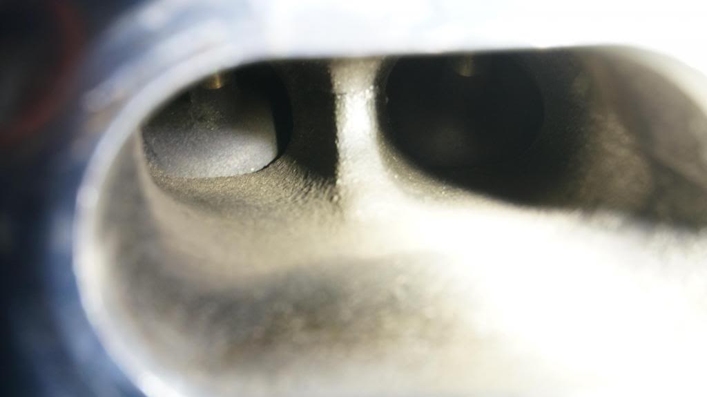

Decided I should post these since they I took them anyways.
So, valves were caked. Last ra2fanatic had the valves cleaned were at 40k miles. This is after only 25k miles with water/meth kit.
Valves cleaned

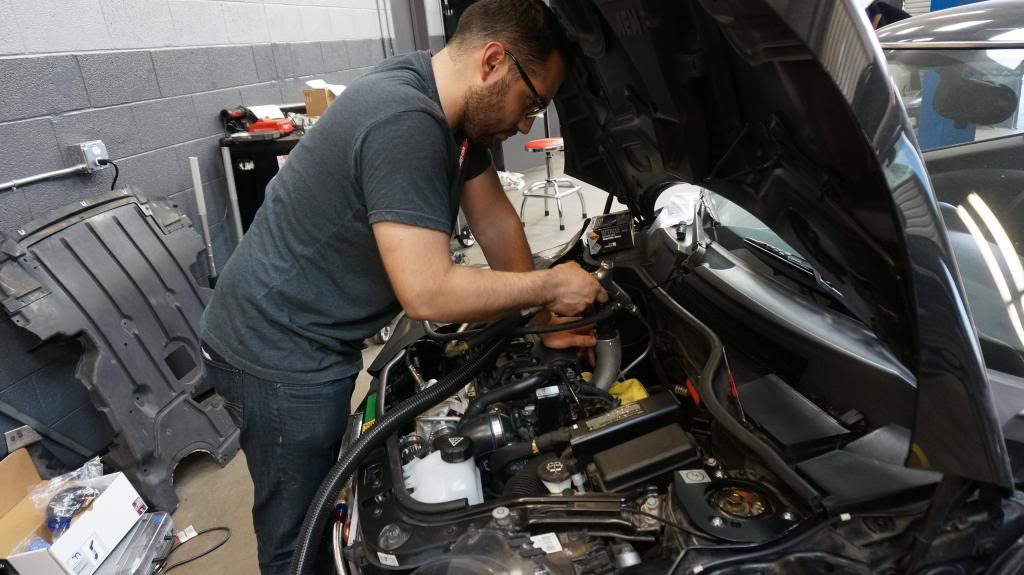

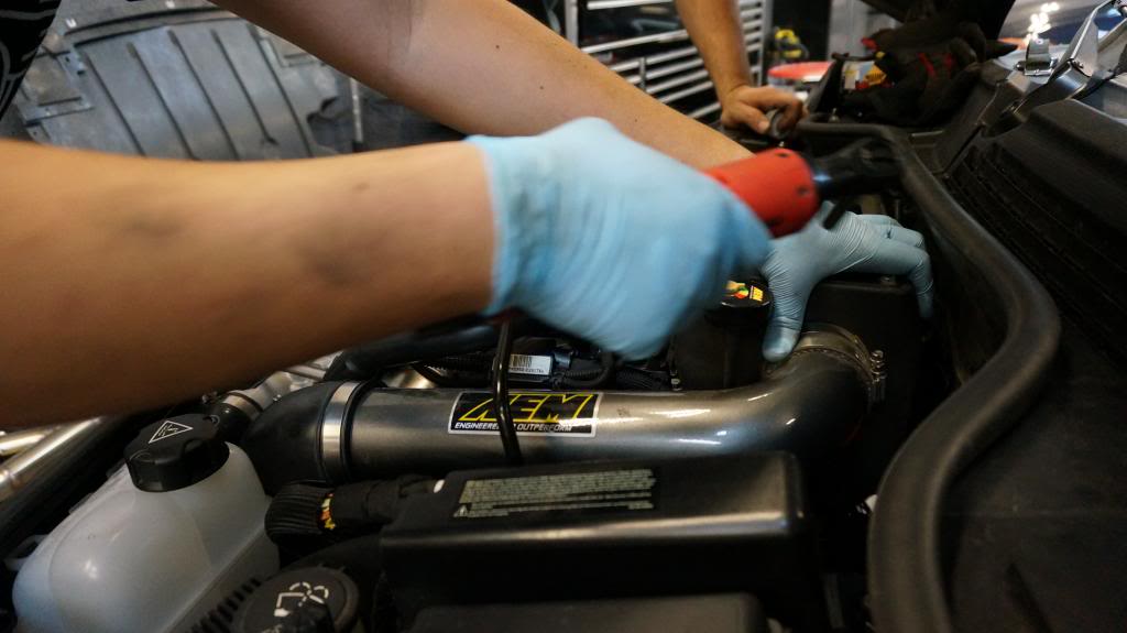

Reassembling intake system and filling the system.

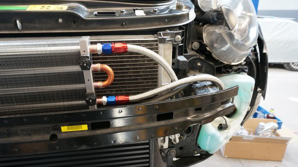

First we ran the lines like this and when we lined up the bumper the right side wasn't lining up right.
Then we did this, and didn't like how the lines ran.
So then it looks like this...proper.

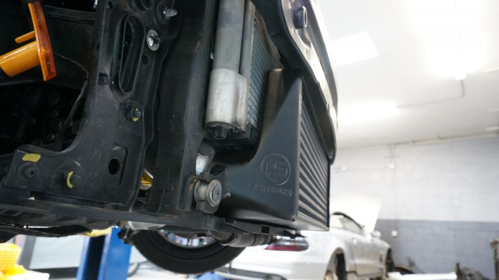

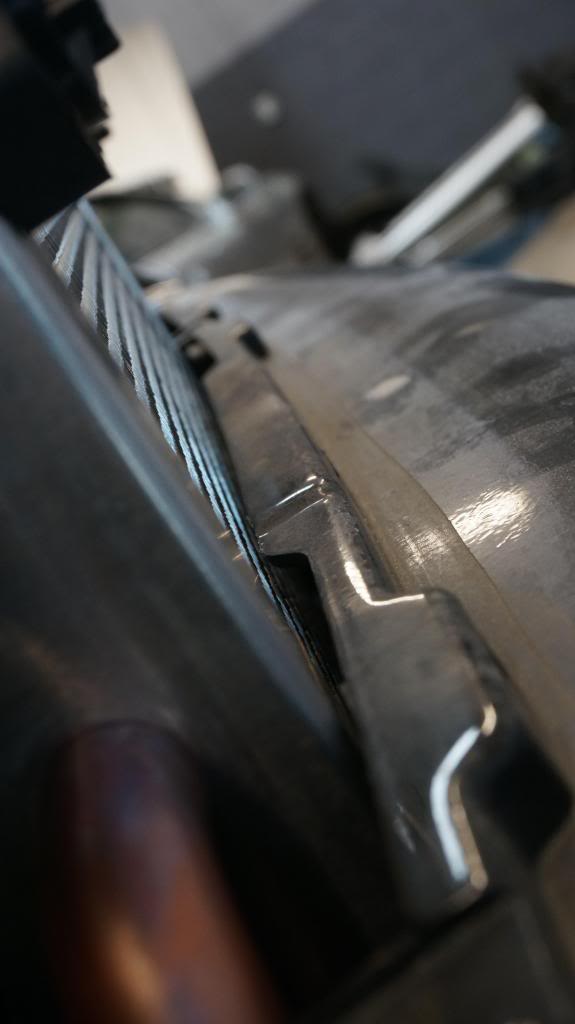

When the bumper was placed I noticed that the edge could touch the fins on the oil cooler, so we called up ra2fanatic and let him know and we decided it was best to grind the bumper a tiny bit.
Can't even tell what we did

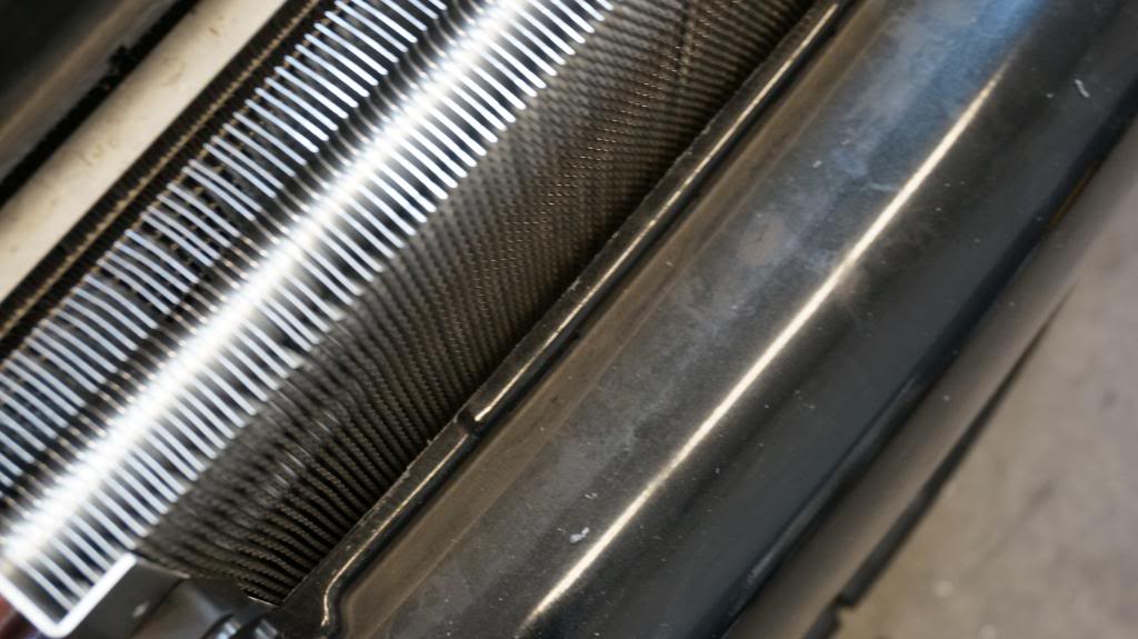

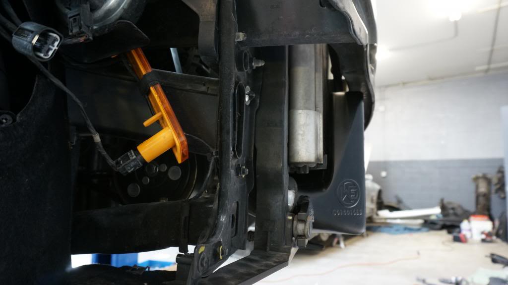

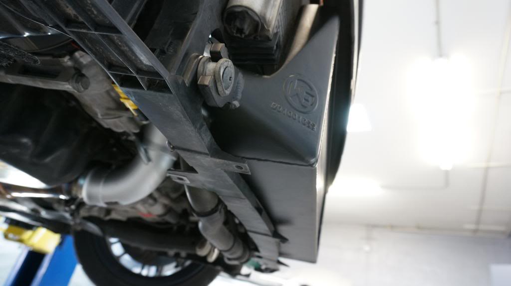

Per ra2fanatic, we also removed the top tab that the Wagner core has. This allowed us to clear the front bar and now it sits flush to the condenser. And it's secured nicely on the stock points. Perfect finish and absolutely no trimming of the grille required.

I was just going to make this very point. I can go days without triggering my injection or it barely coming on during normal driving. 10L lasts me 5000km of of daily driving but i can use 10L in 80km of tracking the car at a track day. That makes a big difference if the effectiveness of cleaning the valves.
Also, i highly recommend putting some hose protection between the SS line so they do not chaff and cause a leak.
i use this stuff on mine as its also close to the turbo.
http://www.improvedracing.com/heat-s...ing-p-141.html
