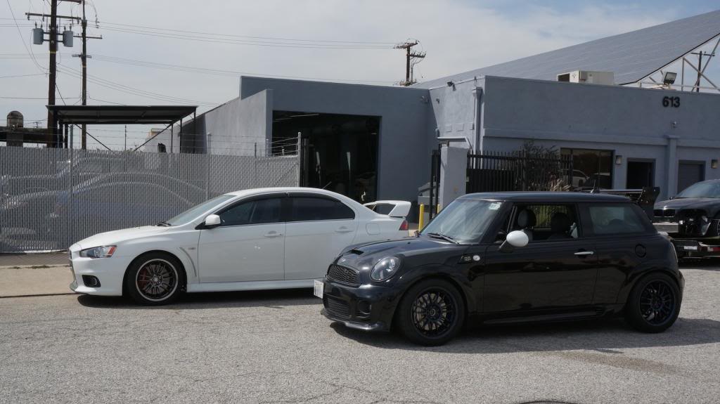

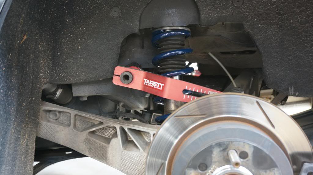

Well, it's done! That's a wrap on this current build. I haven't bothered to calculate the total costs and don't think I want to!
Final pieces were the Hyperco Springs that Battle Tuning ordered for me. They make the ride even more better. The Ohlins come with 6kg fronts/5kg rears.
I knew with at least the Tarett it would stiffen the rear, but knowing that DuelL ran Hyperco springs on their Ohlin setup, this was the same direction I wanted to go with as well and I'm very glad I did. No only has the ride been stiffen, but the ride is still very comfortable. It's flatter through corners and just absorbs bumps even better than before!
Very very happy with my decision to switch. Now on to the photos!!!
Ride height is a bit high, but obviously the springs haven't settled yet, so I'll get my alignment done tomorrow but won't be making any height adjustments for a bit.
Thank you all for those that watched and came out and saw the build in person at Strasse Sport in Covina, CA.
I still need to perform some testing on the Wagner core, but so far I'm highly impressed with this core. Being my 4th core, it has been tops among my list of cores so glad I represent Wagner to the community and bring this amazing piece of art for all to recognize proper intercooler design.
Another thank you to Sneed Speed for the amazing oil cooler they have and always being there for any questions or concerns I've had along the way.
To Stoptech, for being one of the best brake systems on the market year after year and having, in my opinion, the best looking system on the market for our platform and the best rotor and pad options!!!
GT Auto Concepts and iPE for being a badass exhaust system that makes me want to rev and rev and rev!
And lastly for Hyperco, for all the R&D done on the springs that bring winning to the forefront of what they do best.
