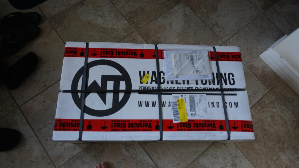

Looking forward to your documentation and review of the Wagner Intercooler.

ra2fanatic's Avatar
ra2fanatic
Joined: Feb 2010
Posts: 2,936
Likes: 22
From: SoCal
This just arrived....
