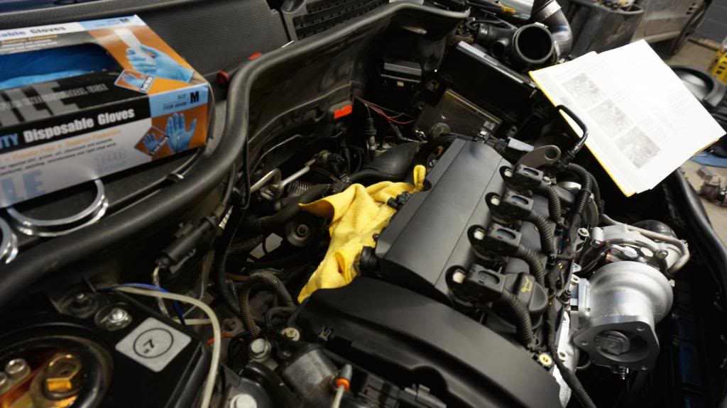

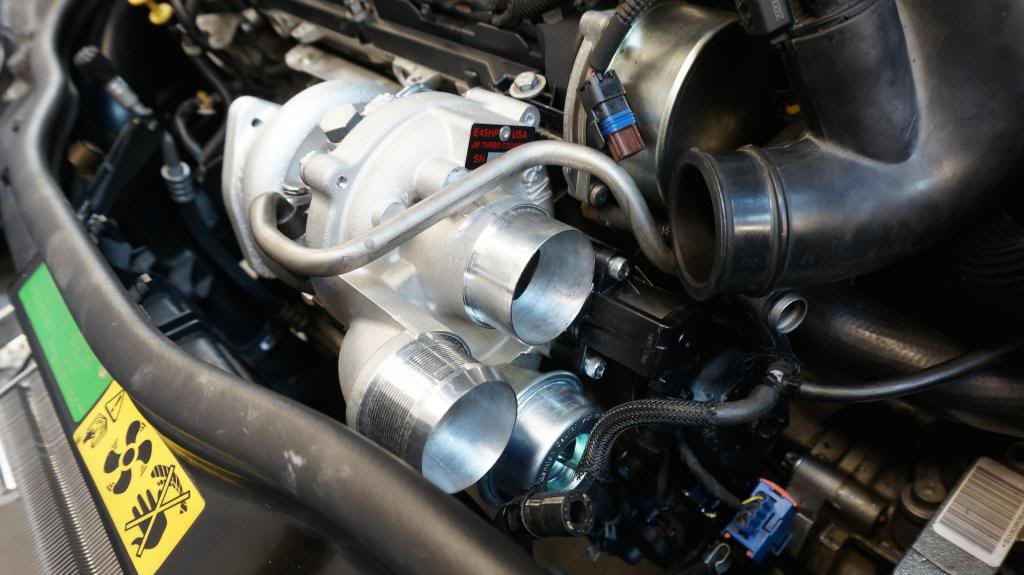

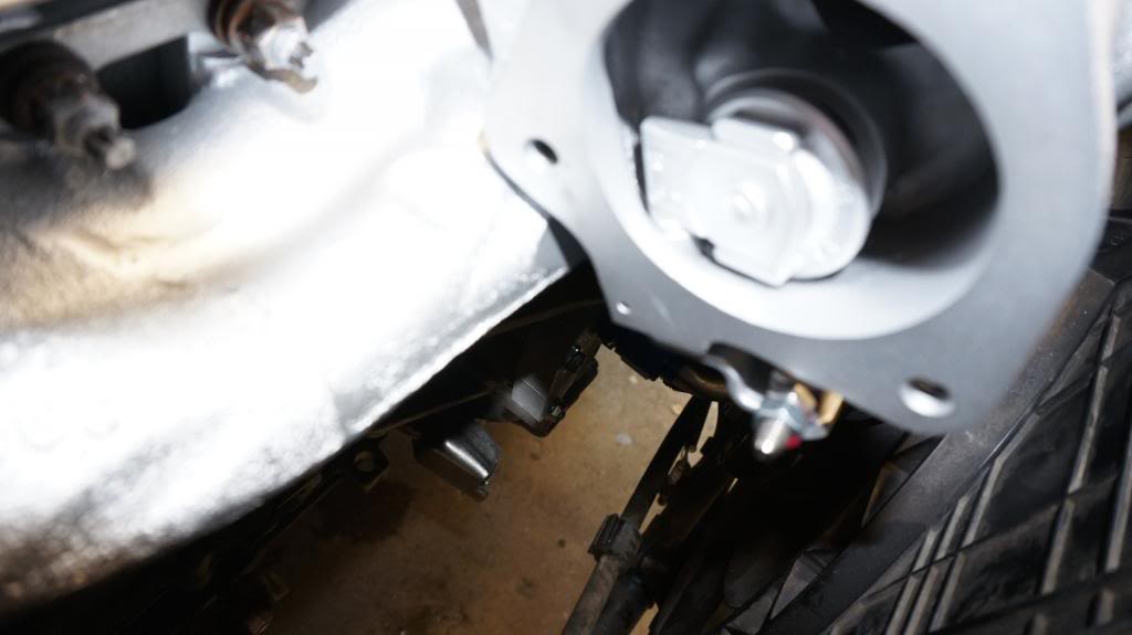

Well, it was not UPS, it was USPS. Had that clarified with Sneed and they're going to reimburse me for the 1-day shipping guarantee that didn't happen...
Anyways! MORE PICTURES!!!
Lines attached.
Beautiful iPE Ceramic Coated Downpipe installed.
Had JMTC leave the plate alone so others can know that this is an authentic iPE downpipe still
Oil Cooler mounted!
Tried to get the new heat exchange plate, but didn't get a good shot...I'll try again on Saturday.
A major issue arose as I was getting the top connected....the AEM intake's silicone connecter to the turbo does not fit....I believe it's off by about 7mm in diameter.
I'm going to have to dremel out the inside of it a bit to make it fit....
Then another issue....coolant hose that connects to the expansion tank could possibly leak in the near future caused by rubbing so I have to replace this before I can start to flush the coolant and oil on Saturday.
And lastly, removed the intake manifold in preparation for the walnut shell blasting that'll be done this weekend.
I wish I could be on the road, but minor hiccups at this point. So for sure it'll be wrapped up on Saturday.
Oh and also, the same noisemaker pipes in the back of the intake manifold is being swapped out for the NM Charge pipe, that was a total b-i-t-c-h to take off....along with the manifold. All-in-all, good progress today.
What's left? Walnut shell blasting, fit braided lines to oil cooler, flush oil and coolant. Ignition Project's Plasma Coils are still not here -_- Now I've been told at the end of the month as well...

Originally Posted by holkki
Hi!
Yep,I have a JM Turbo cooper S42HP and the same problem with comp.housing outside diameter,orig. about 43.7 and new 50mm. I'm planning to buy AEM intake but this problem should come up with a solution....I wonder, could stretch the rubbertube over housing inlet?
JM says to stretch it as well. I've tried it and I don't know what else to use to stretch it unless I keep trying to put it on with no luck so I'm going to do what I said I'd do which is dremel the inside of it a bit. We'll see what happens afterwards.
Can't you use the N18 intake hose to the turbo? It should fit.
Ok sure lemme just pull that outta my *** and put it on there. Comeon now seriously?
This is a N14 and utilize the AEM piece that was provided. Gotta work with what they've provided me at the moment and have no intention of buying a full N18 pipe and then modify it to fit my intake.

From: SoCal
Sorry to come off as an a-hole with that comment but don't think N18 piping makes the equation any better at the moment.
Shop will be closed tomorrow to dyno tune a M3 so it's back to work on it on Saturday.

Originally Posted by DICKS GARAGE R53
Did you try boiling the rubber tube for a while, then stuffing it on when it was hot?
Haven't tried that, but not sure I'd have access to boiling hot water anyways when I'm at the shop getting this done tomorrow...
Originally Posted by Panther MINI
What oil cooler is that? Looks like Mishimoto...also what size specifically is that oil cooler (lengthxwidthxheight)? How much clearance did you end up with? I'm considering doing the same thing to my n18 and I'm thrilled to see a picture of what it would about look like.
It's the Sneed's Speed Shop (sneed4speed.com) R56 Turbo Oil Cooler kit. It's a very tight fit on the upper part of the condenser so we'll see what clearance I have left when I have to place the grille back on tomorrow. I don't have the specific details on the item, but check out their website and maybe they should have a proper answer for you!

No worries. I dremeled the inside of it a bit. We'll see how much more needs done tomorrow.

^There is no room left in the engine bay to fit an adapter, but the dremeling did work out.
The install was a success and everything is in and running great.
Only issue this MINI has now is a small leak from the oil cooler plate. We'll have to talk to Sneed Speed to provide a new plate because the epoxy on the fitting is giving a leak that when it hits the lower O2 sensor on the downpipe releases a bit of smoke through the hood. Should have photos sent to ra2fanatic shortly and he can set them up nicely for you all to see. We still need to fit the Hyperco springs on his coilovers and once again put a new plate on pending what Sneed says on their plate Monday...
