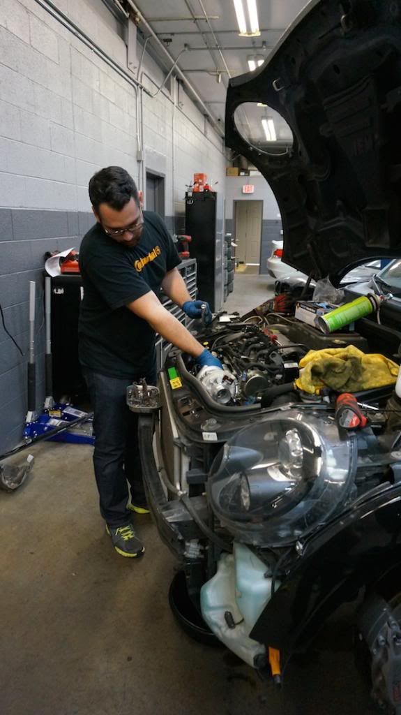

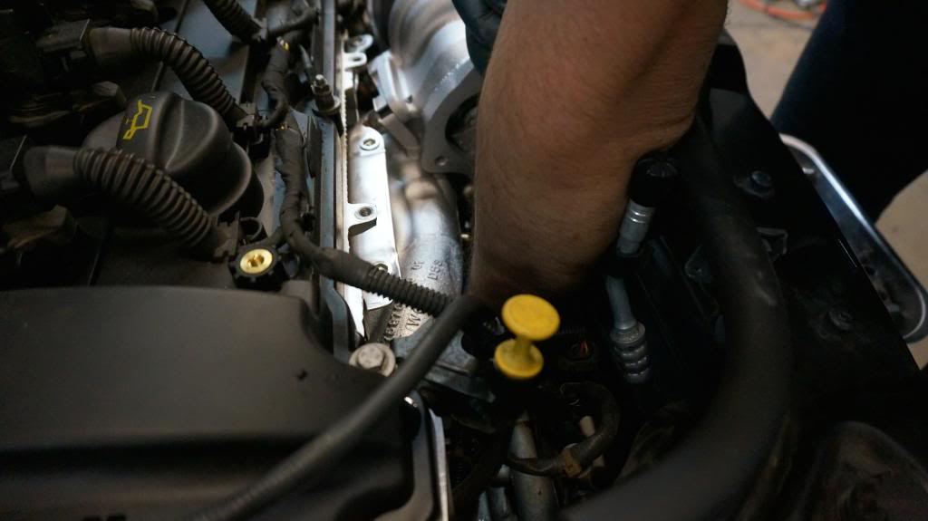

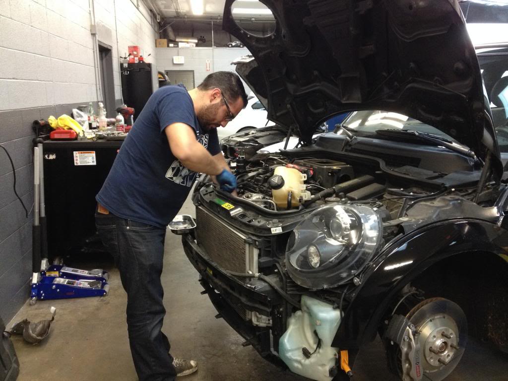

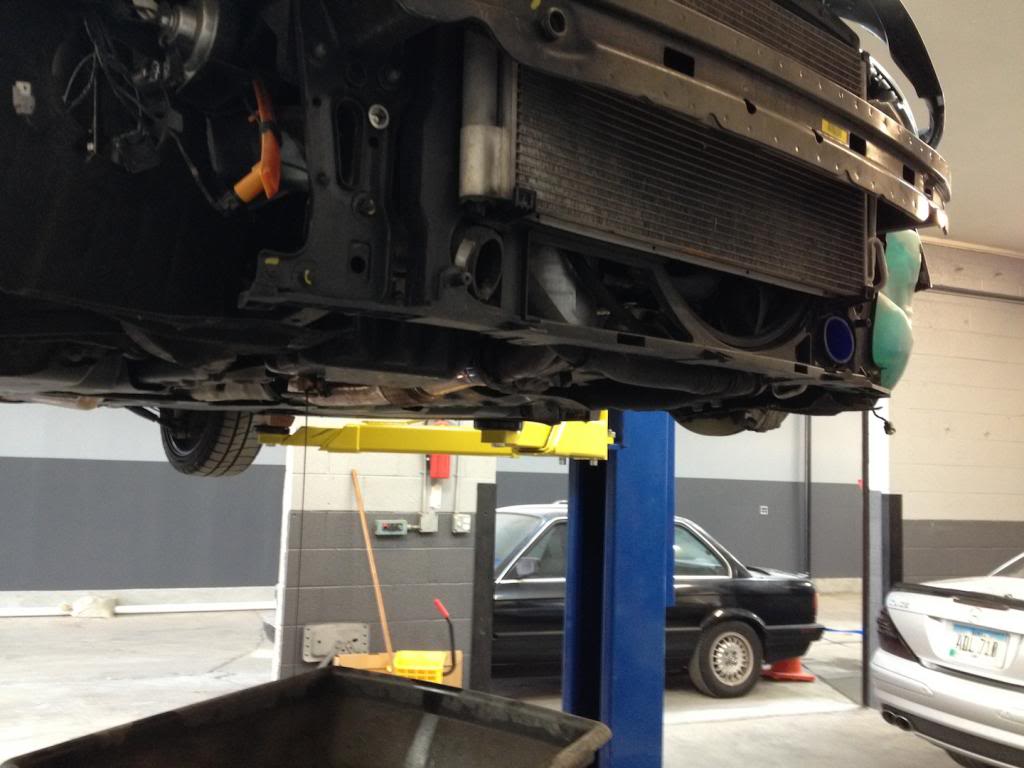

So here we go, intercooler off! I've done it so many times that it took no more than 30mins to take off the front bumper and uninstall. 15mins later, sold to local guy.

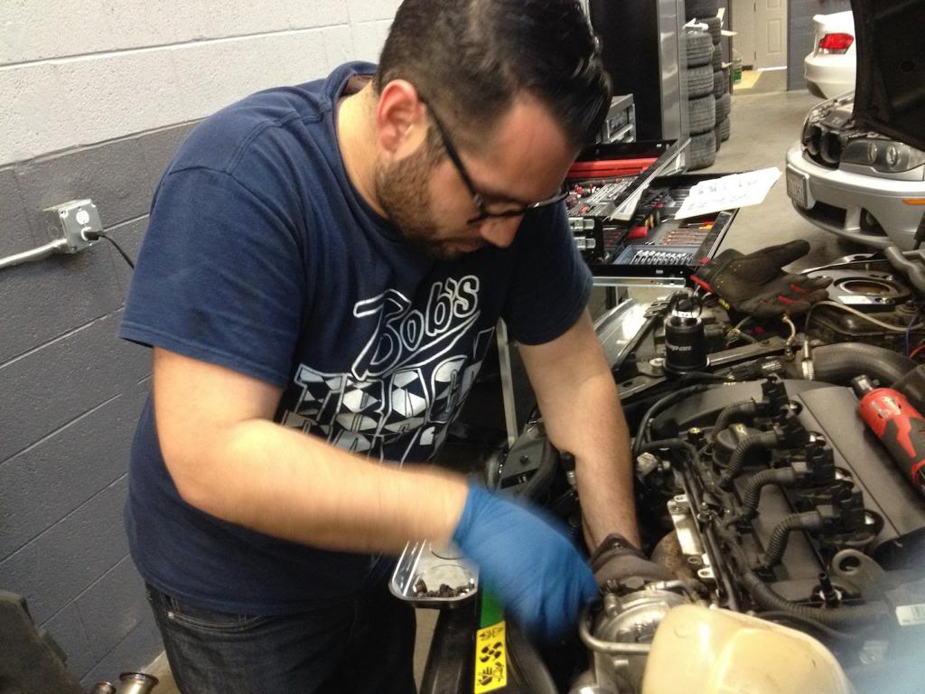

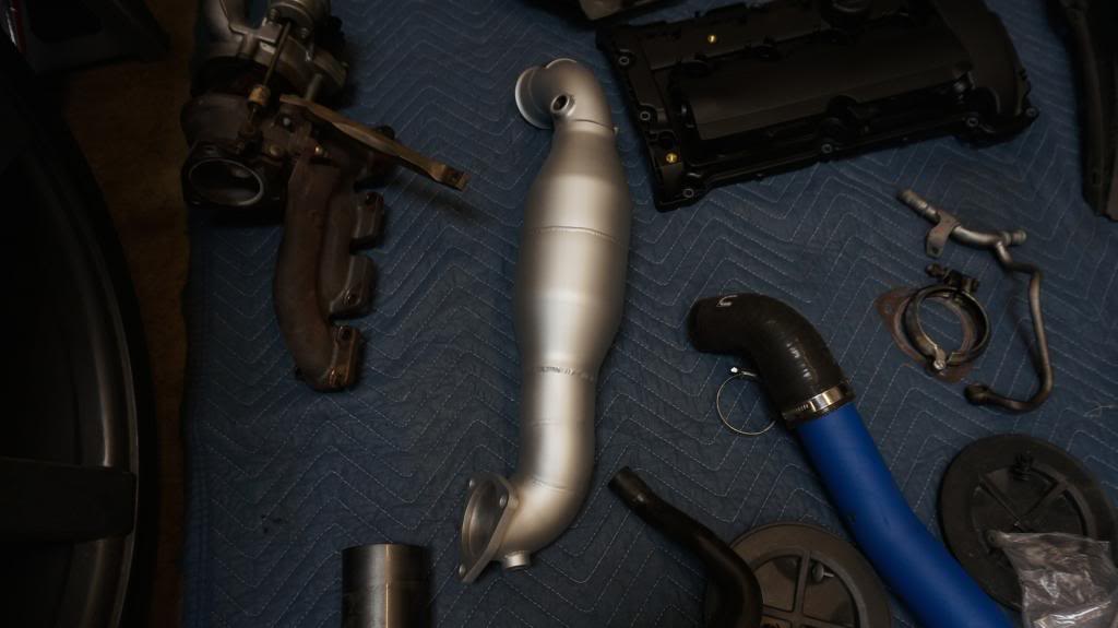

O2 unplugged and v-clamp removed. Heatshield and stock downpipe removal..
Ivan @ Strasse Sport doing his thing...
That was the wrap on day 1. We went ahead and removed a few more things such as various connections and the oil filter and heat exchanger to change out the gaskets.

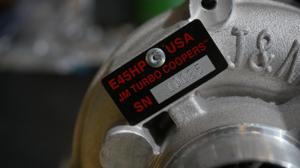

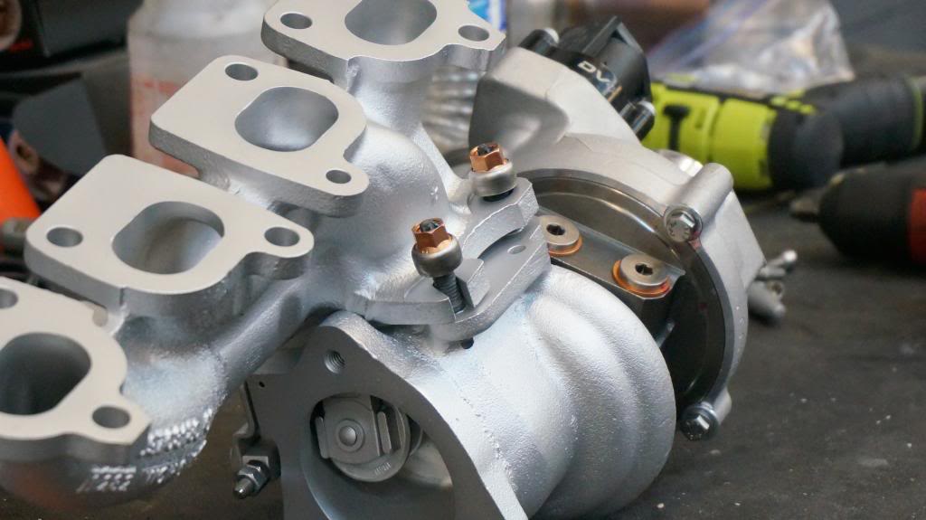

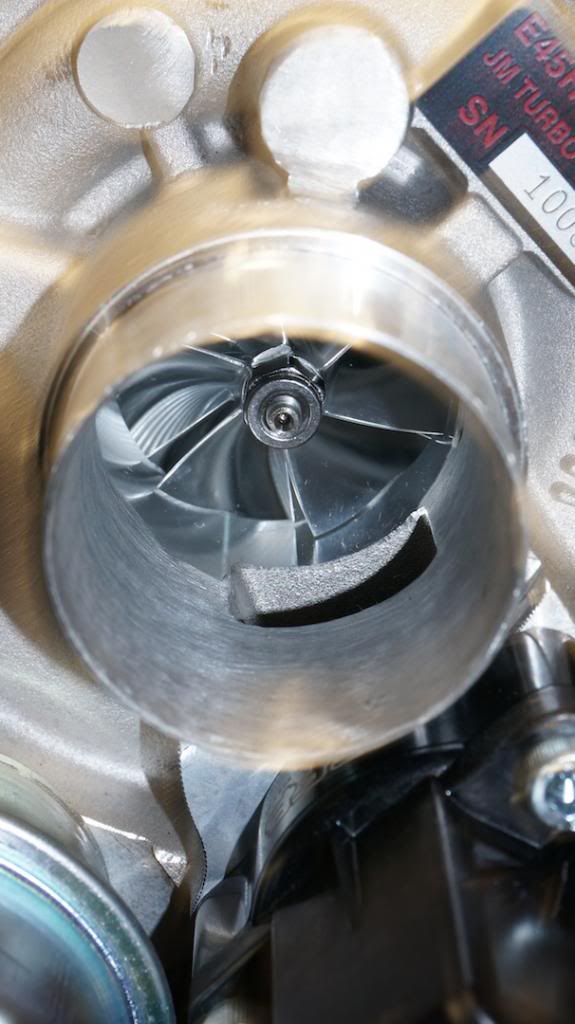

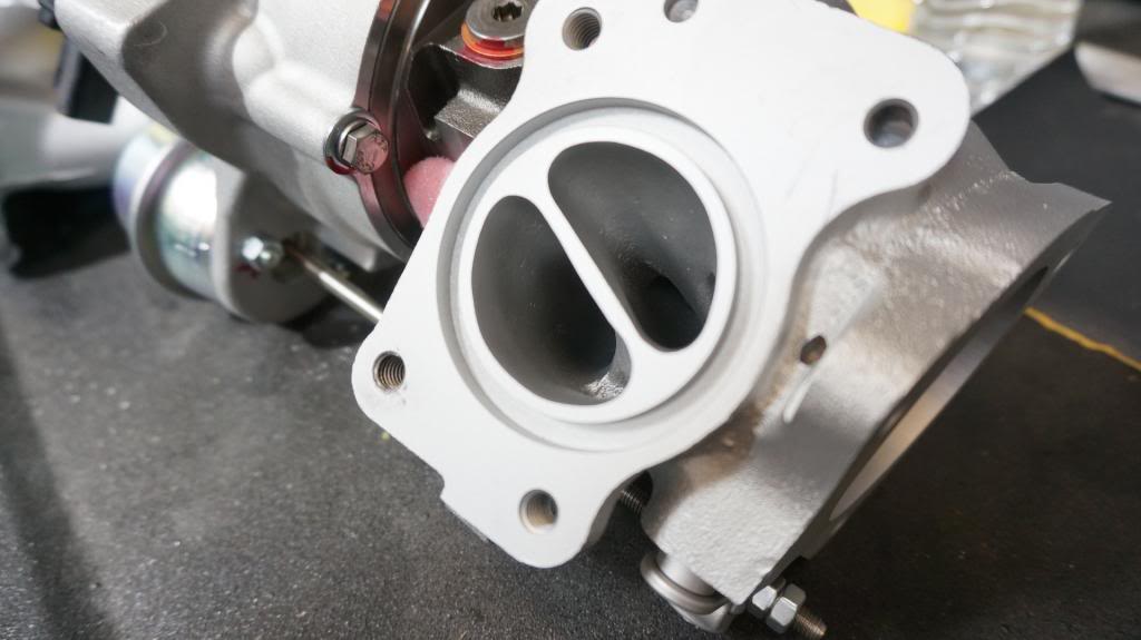

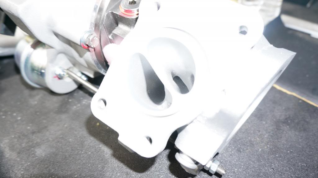

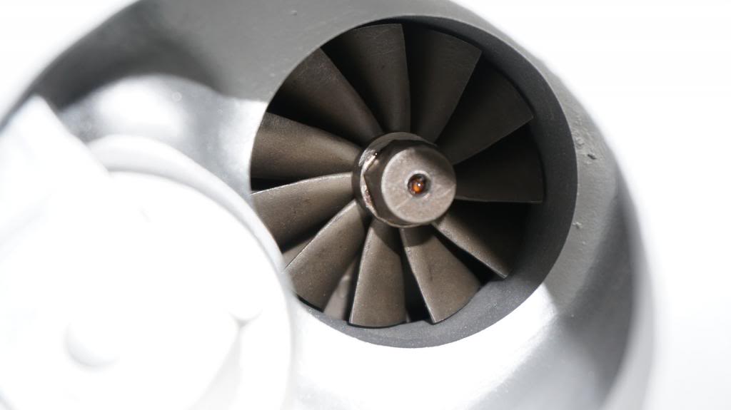

Here are photos of the amazing work done on the E45HP, which is actually a B45HP (billet), 3rd gen exhaust manifold, and my iPE downpipe performed by JM Turbo Cooper. Arric is knowledgeable and great to talk to and will work with him again!

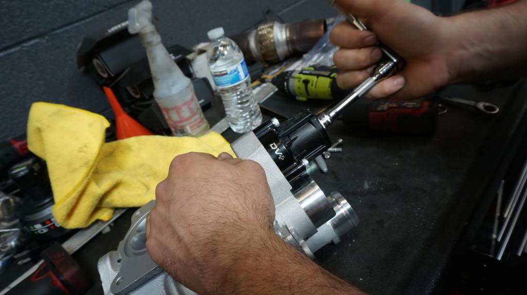

The turbo came with it's own, NEW, diverter valve, but we went ahead and broke it down, to add the GFB DV+ T9352 (for N14 only) and torqued it back on. Also billet aluminum and the sturdy spring inside I image will definitely be giving me amazing throttle response.

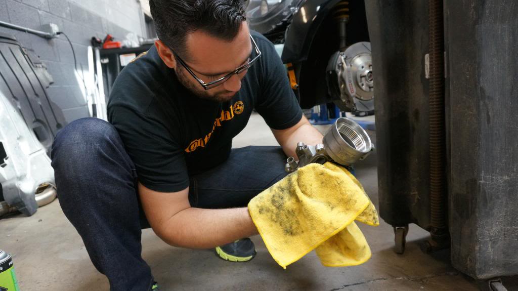

With the oil filter off, we began to clean it off because of all the other oil changes performed with oil always causing a spill/mess down there. All gaskets have been replaced. Now just awaiting the Sneed Speed Oil Cooler to replace the stock heat exchange.

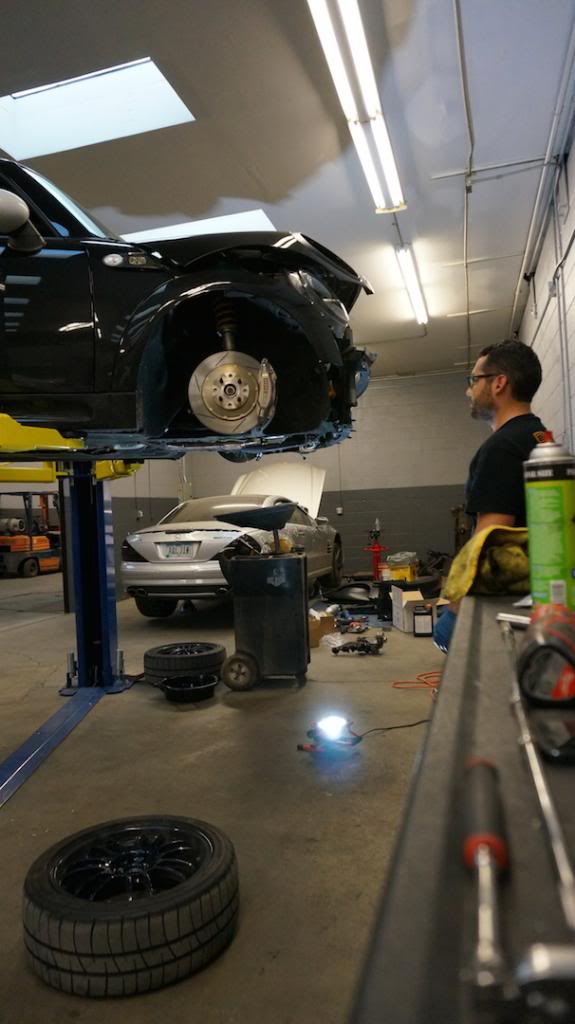

Ivan. Shop owner of Strasse Sport. Very knowledgeable. Also a track junkie who got me into racing in the first place. Everyone I send to him say he's a great guy to chat about cars and anything in general.

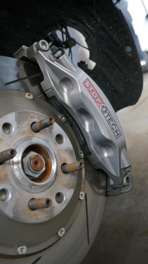

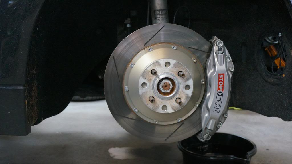

Go big or go home: Stoptech Trophy Sport.

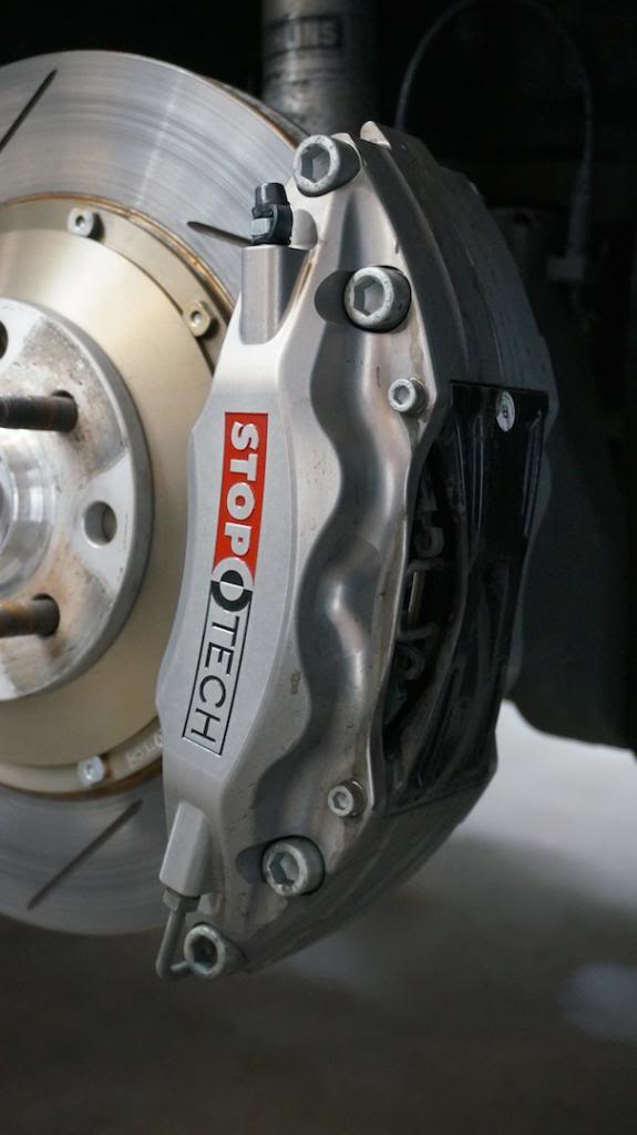

Compared to the regular Stoptech Big Brake Kit, you can see that the engineers did everything they could to save weight, including, drilling out whatever extra material was not necessary, yet still be more stiff and rigid that their regular BBK. Amazing...

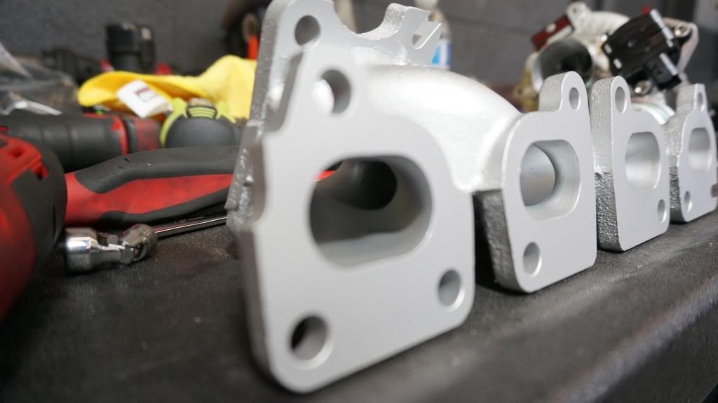

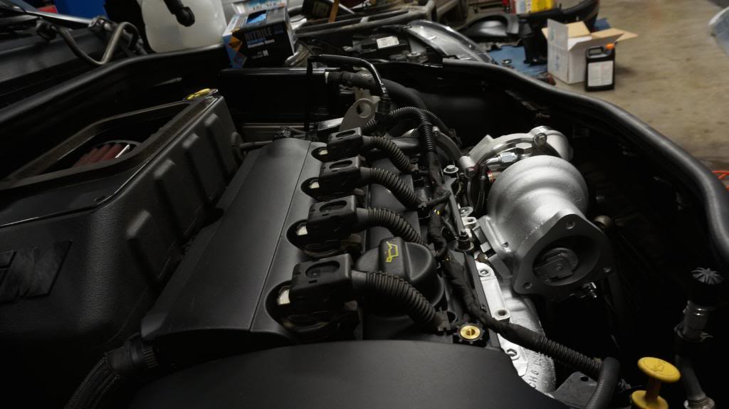

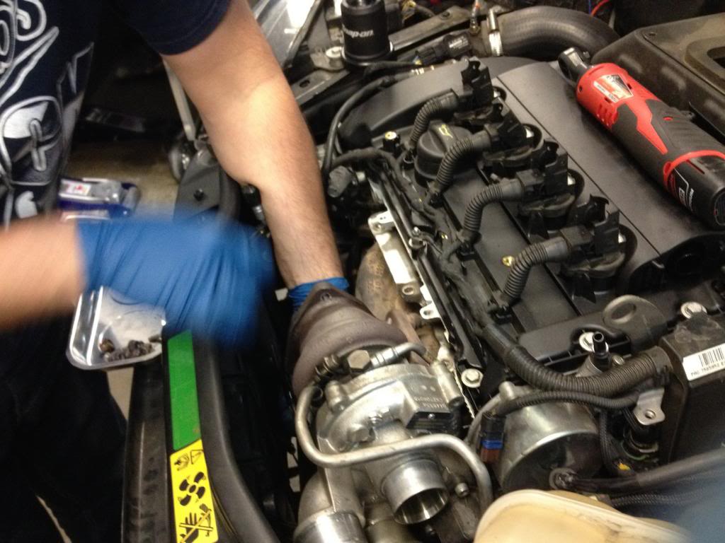

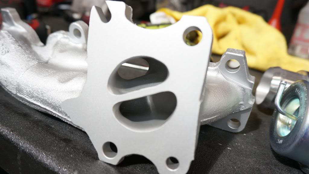

Assembly of the turbo to manifold.

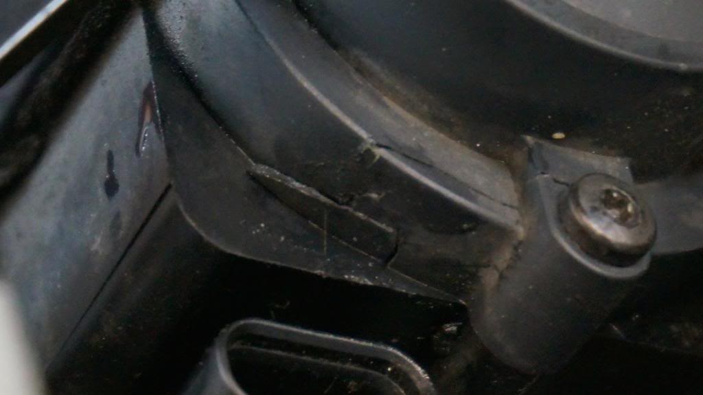

When we removed the Aux Water Pump, we saw a crack in our unit. We weren't going to take any chances so it was obvious that a trip to the dealer was necessary.
New shiny unit. It comes with the entire bracket.
