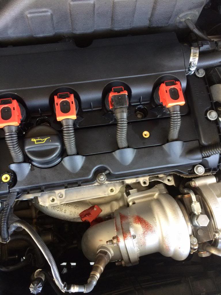

First off, this happened. My IP Coils had a broken clip, it fell off and melted all over my manifold and downpipe. I spoke to BT where I bought it and he spoke to iP and got a new clip replaced! When things cooled down, I was able to scrap off the main bits and the rest just melted away and disappeared, so it didn't ruin my finish!

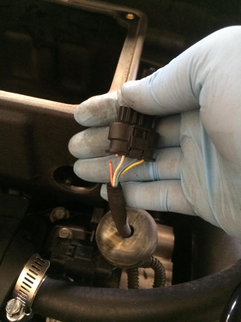

Then trying to figure out what my MAF issue was, I pulled off the intake and was disconnecting the harness when I saw this....
It was not the MAF sensor that needed cleaning, but the damn connection was broken. My heart sank quite a bit there. A $300+ MAF, I can deal with, but this was a full $400+ engine harness!!!!! That's major labor into reconnecting and mapping everything just for one stupid connection!!!

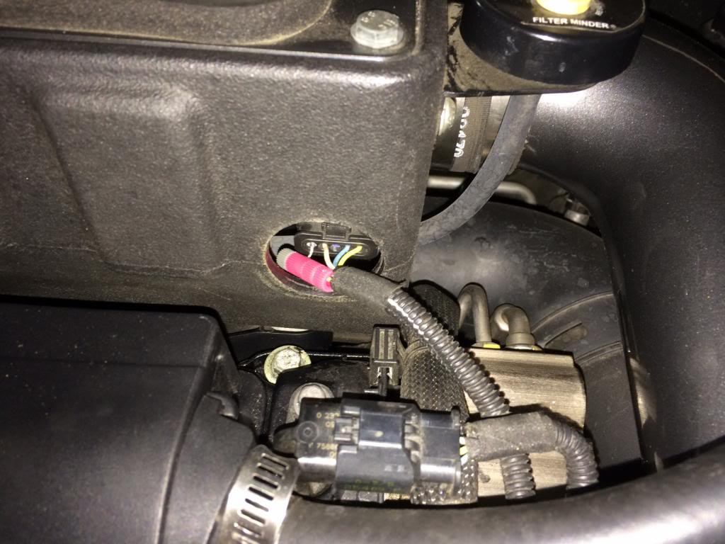

Well, I improvised and bought a soldering kit and a roll of wiring. Soldered on a piece on the main head in the connector and tried to solder the other end to the main wire, but I think the wind kept oxidizing the wire before it would melt onto the bundle so I said "f' it" and used some of my spare posi-taps and tapped that sh*t instead.!!!
Closed the hood, drove down the block and back! No more limp mode, no more bs lack of power, and the exhaust works again! Because of limp mode, the exhaust was always in "ON" mode so it's fine with me, but the wife didn't enjoy some of our long trips around town, but now I'm good! Dyno next week because this has been a long time coming!
