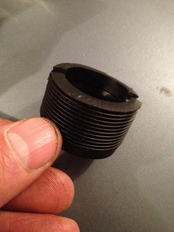

Urgent help needed!
So I am trying install this new AEM intake on my '09 JCW. The instructions say to remove the boost bypass valve and the diagram shows the Cooper S intake tube. The JCW has a pretty strong tie strap holding the bypass valve into the intake tube. I had to cut it to remove the bypass valve. The valve looks larger than the new AEM intake elbow opening. Is it possible the JCW has a larger bypass valve than the Cooper S?

Okay, the install is complete. Here is what happened that led me to my panic. The JCW bypass valve has a large rubber grommet around it to fit in the intake tube. The AEM instructions did not mention this. In order to remove the valve, you have to cut the tie strap holding it to the tube. Once you remove it, you then need to slide the grommet, shown in the attached photo, of the valve. It then fits beautifully. The only other hiccup was the removal of the hood scoop, the instructions made no mention of the small pushpin/screw holding the center of the scoop. Thankfully, nothing broke or bent during the removal. I will either be painting the inside of the hood scoop to hide the ugliness that Mini forgot to paint OR get the new mesh grill from Mini-Fini.
Other than that, amazing fit/finish. Install was a snap and the new sounds coming from the hood blend sweetly with those now coming from my exhaust tips. Love it.
Attached Thumbnails New Mini Cooper Intake from AEM-img_0877.jpg   New Mini Cooper Intake from AEM-img_0876.jpg   New Mini Cooper Intake from AEM-img_0875.jpg
