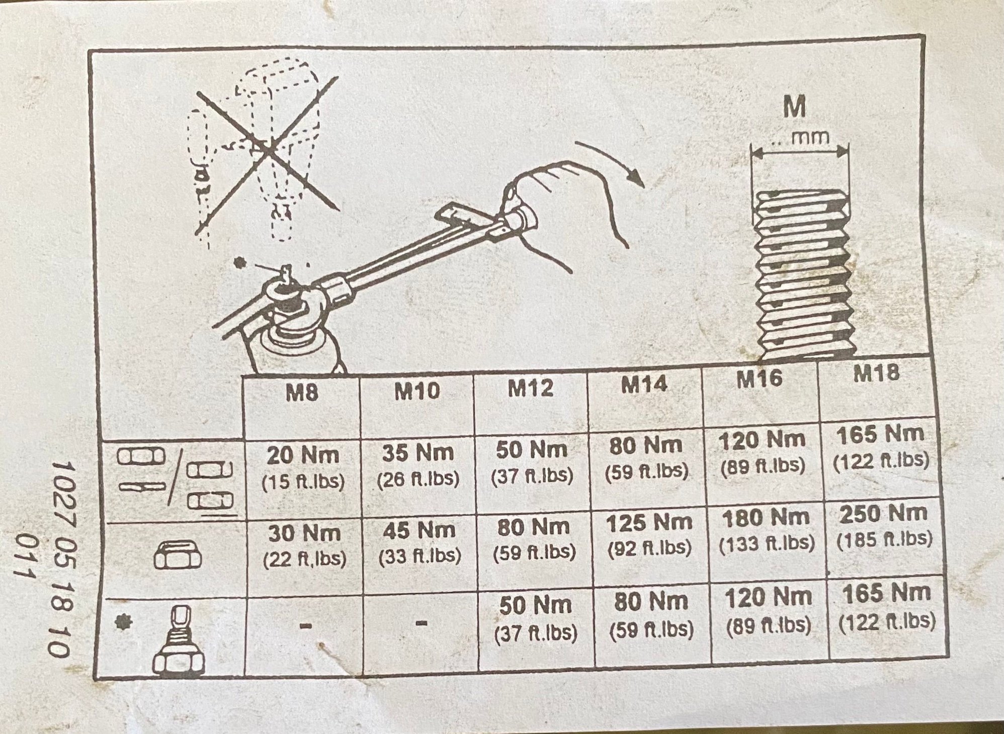

I don't recall which instructions came with what, but I think this is for the front Koni S.A. struts
I think these were for the Koni S.A. rear shocks
Uhhh.... something something torque numbers?

Just curious what you guys used to torque the top nut on the rear konis. Since you have to use a 5mm allen key to hold the shaft how did you get a torque wrench on the nut. I just used a gear wrench on it until it bottomed out and was nice and tight. I also put the white plastic washer all the way at the bottom of the shaft under the factory foam bump stop.

To torque the top of the struts, what you really want is the Schwaben Strut Nut Socket (or equivalent): https://www.google.com/search?q=Schw...rut+Nut+Socket
The allen key fits through the "window" on the side of the Schwaben tool. (You will likely also need a "cheater"/extension for the allen wrench.)

I used a rather nifty trick because I dont have the special tools. I used some thick rubber and some pliers to lock the shaft. Then I was able to tighten the top nut. I used an impact wrench btw. Please note that I wouldnt use an impact without this method as the shaft would be just spinning around!
I cant remember exactly, but I dont think I needed to use this trick on the rear struts...

I just wound up tightening as tight as I could get with my long gearwrench box wrench and allen key. It's only like 22 ftlbs so I'm sure I got it tight enough.
