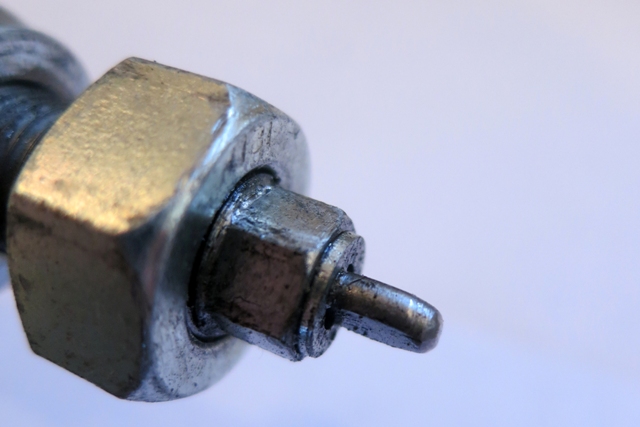

Per NC TRACKRAT's request, I posted photos of the top of the rod, and the section with the retainer ring and groove.
Given the mileage at which the shocks were replaced and the hardness of the rod relative to the chassis sheet metal, there is not much deformation on the top of the rod (I got the camera as close as I could, while maintaining focus).
If any forum members are in the market for a pair of adjustable sport shocks for this application and do not share my concern, I will sell the pair I removed from the vehicle.

That's the standard setup for the rear Koni's. I have a set that are close to 10 years old, they are the same design. You have to be careful that the spacer piece is installed correctly, it has a counterbore on one end that actually goes over the wire ring, locking the ring securely into the groove. If the spacer isn't fully seated over the wire ring, or installed upside down, it will come loose.

I still believe both pair were installed correctly. When the second pair was installed, two techs worked on the installation. Between the two, they have about 15 years of Mini service and modification experience.
Based on jasonsmf's reply, I am wondering if it is a vehicle application issue. jasonsmf, what is the model and model year of the Mini on which you have them installed?
