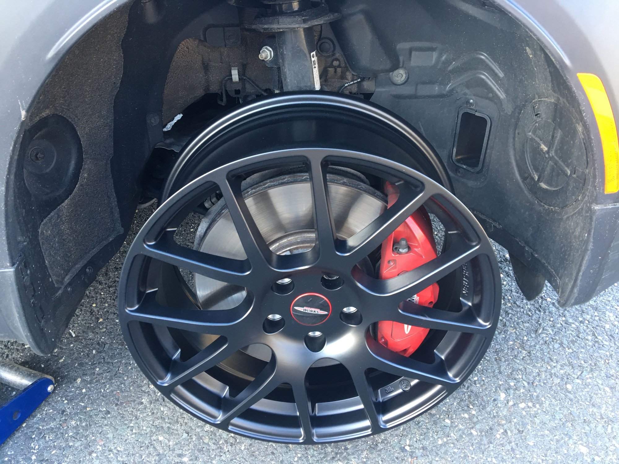

Test fit of the Enkei TS9 17x8 et45 5x112. They fit!! I will upload once the other 3 arrive and I mount tires.

Nice! Any centering rings or spacers needed?

Just 72.6 to 66.56 centering rings.

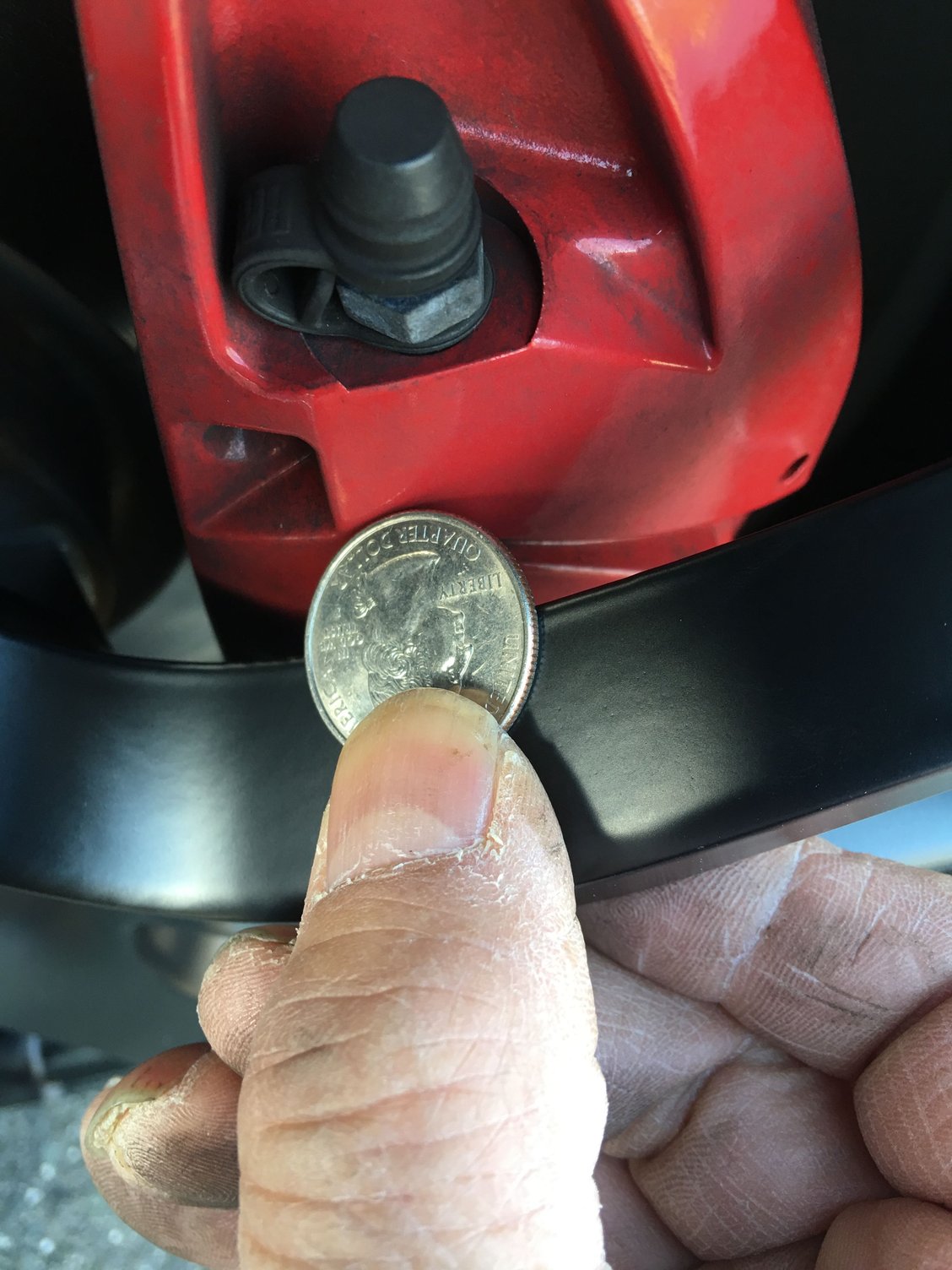

last pic is spoke to caliper clearance.

Bit of a cheek i know but could you measure the gap between the spoke and the caliper.I am trying to work out if the 18" size on this wheel will fit my JCW.
